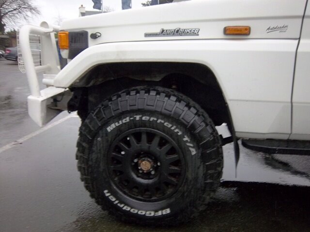

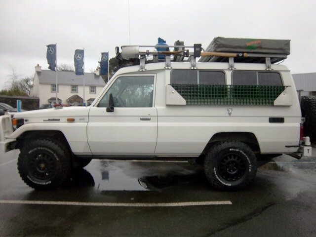

Cheers Ben. Yours looks good! Im planning to get the rims and KM2 255/85s fitted at Silverline this saturday. I decided on the thinner KM2s as they're lighter and will be better on road, and don't lose out much off road either. I'll post some pics when they're on. Thanks for the advice.

Thanks Rosco. Yes, I'm happy with the new 16x8s. I think they look just right, and the BFG KM2s are impressive too.
