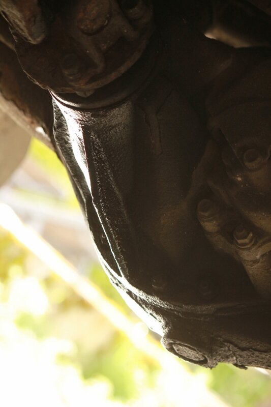

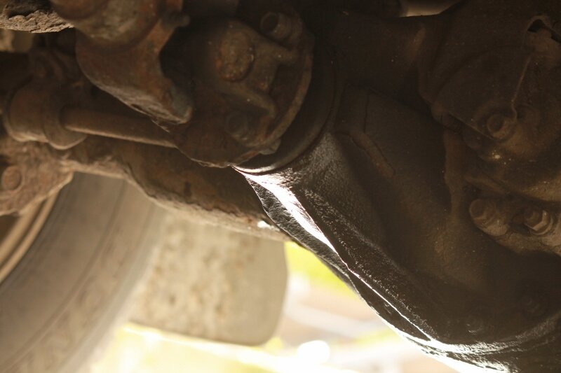

Hi all, had a chance to take a photo of the leaky diff - looks like its starting where the prop goes in - looks like a gasket?
Just need to find some one who knows what they are doing now!
Steve
Not a big job Steve. Fear not. It is pretty much as simple as undo, take old one out, put new on in and bolt back up. The diff doesn't have to come out or anything hideous.Not even many tools required. Couple of tips and tricks needed, but it's not major surgery. And of course as long as you top the oil up it could run like that for ever.
