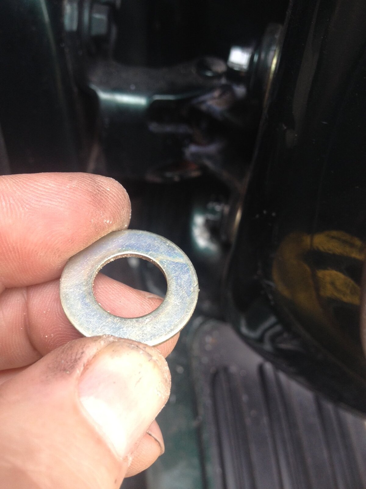

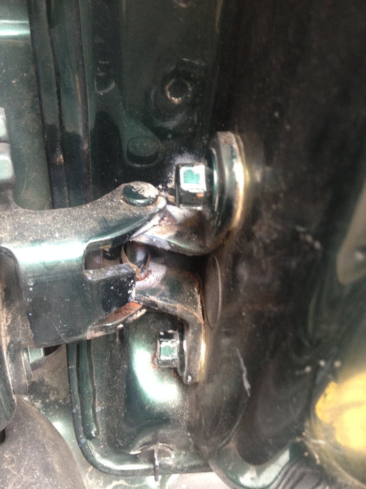

My rear door had dropped a tiny bit and made a very sad sound when it was shut so I decided to try and fix it. (I am sure someone else will have done this but thought it may be helpful... )
The hinges did not look too bad actually so I guess they are just not up to the job of supporting the door and the spare wheel so I improvised....
The rear door was supported with a jack and a piece of timber and I inserted a couple of washers, under the bottom hinge bolts as shown, one at a time. Worked a treat and door closes perfectly.
