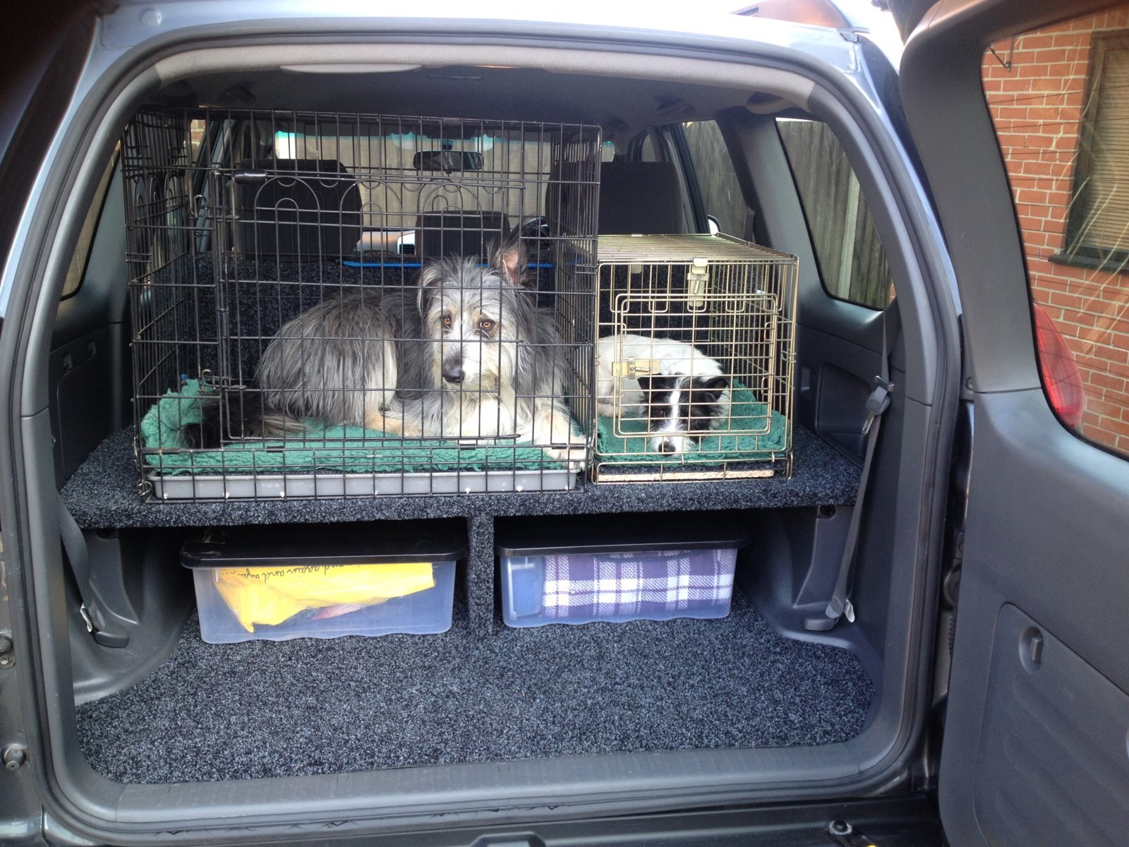

We never use the back seats so I would happily pull them out and have the back completely flat. The only trouble is with two dogs we have two cages and if put fully towards the front it's really hard to reach them IMG_1671.JPG .
