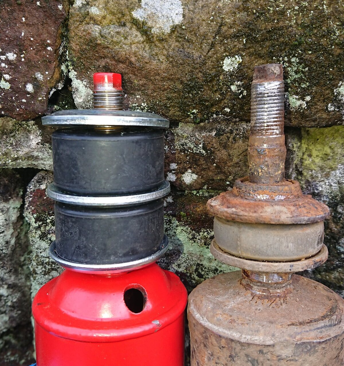

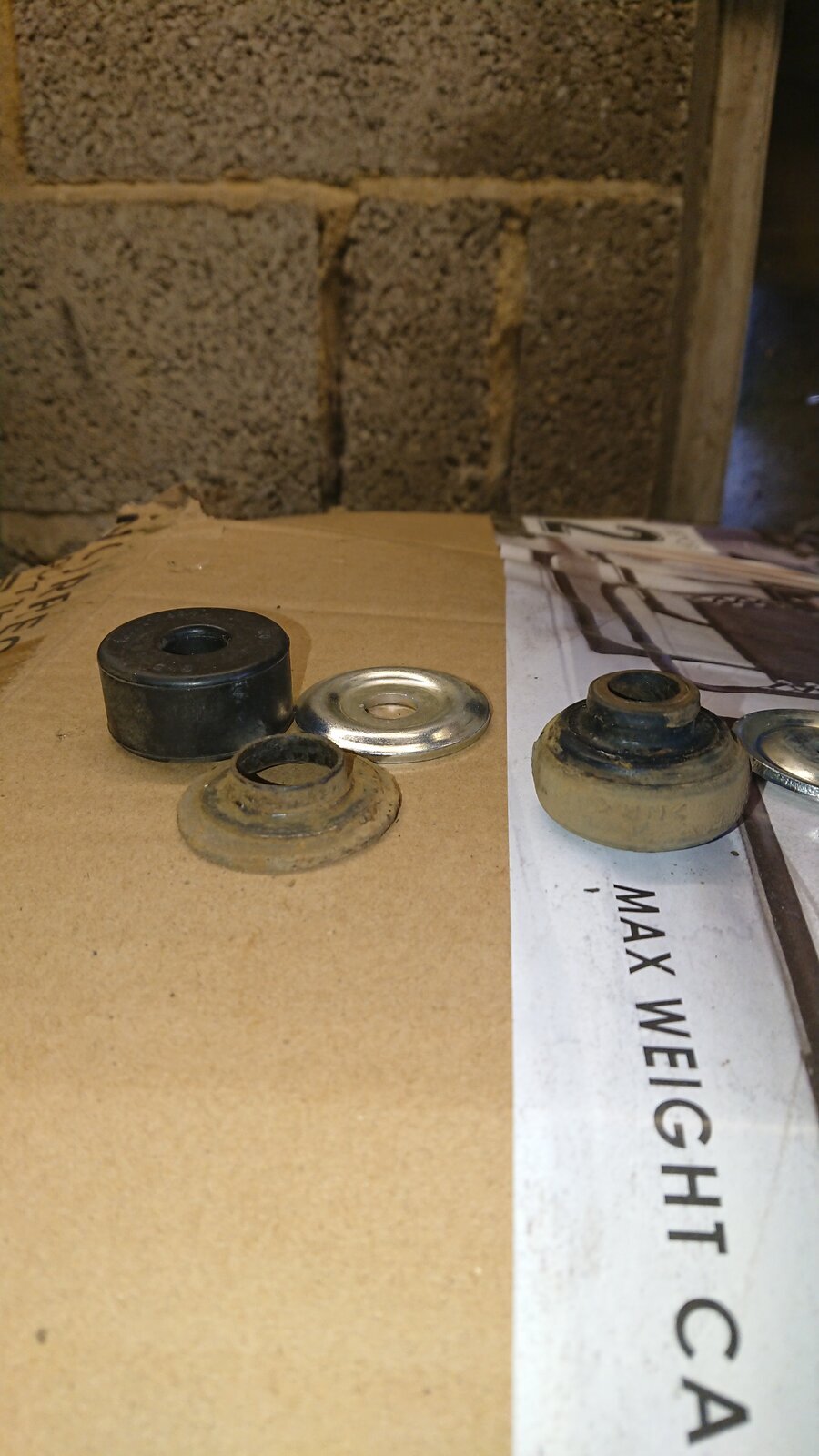

So i can finally report on the Koni heavy track shocks.
Well they are not on my lc4 instead are some bilstein b4.
So the Koni came with (in my opinion) the wrong bushes (see picture) but according to Koni they supplied the correct bushes and it is my vehicle that has the wrong or none standard Achd mount.
So on went the bilstein with new bushes and very pleased and at £54 each a 3rd of the price of Koni's.
Hope this might help someone not to make an expensive mistake.
