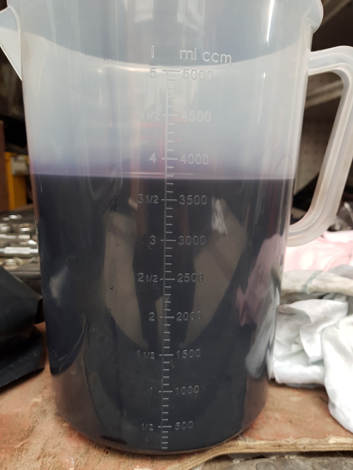

Then I undid the 14mm drain plug and placed my mahoosive measuring jug underneath.
I was quite surprised that I got just short of 4 litres out.

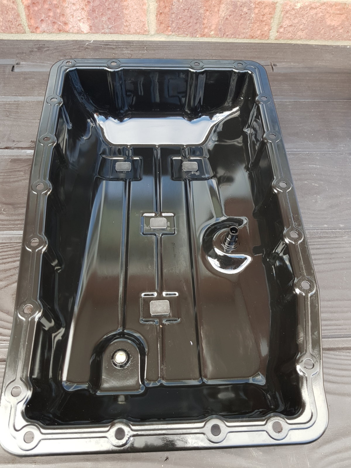

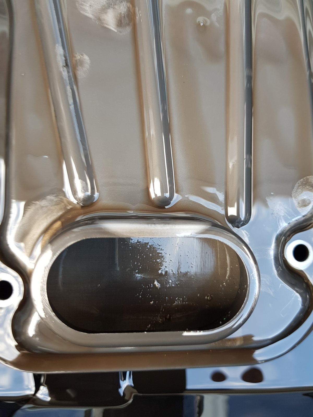

I changed the internal filter over and I cleaned the sump up and All the internal magnets. The old filter was pretty clean with only a couple of alumium shaving probably from assembly.
I then coupled a cardboard shield together while I drilled the three bolts out and 're tapped them.
I cleaned the face up on the auto box and used a bit of instant gasket to stick the new gasket to the sump pan. Then went In for a cuppa, while it set.
I then put a small bead around the face of the auto box and 're installed the sump pan. The chocolate bolts are 10mm. If I was doing it again I would order a new set of bolts.

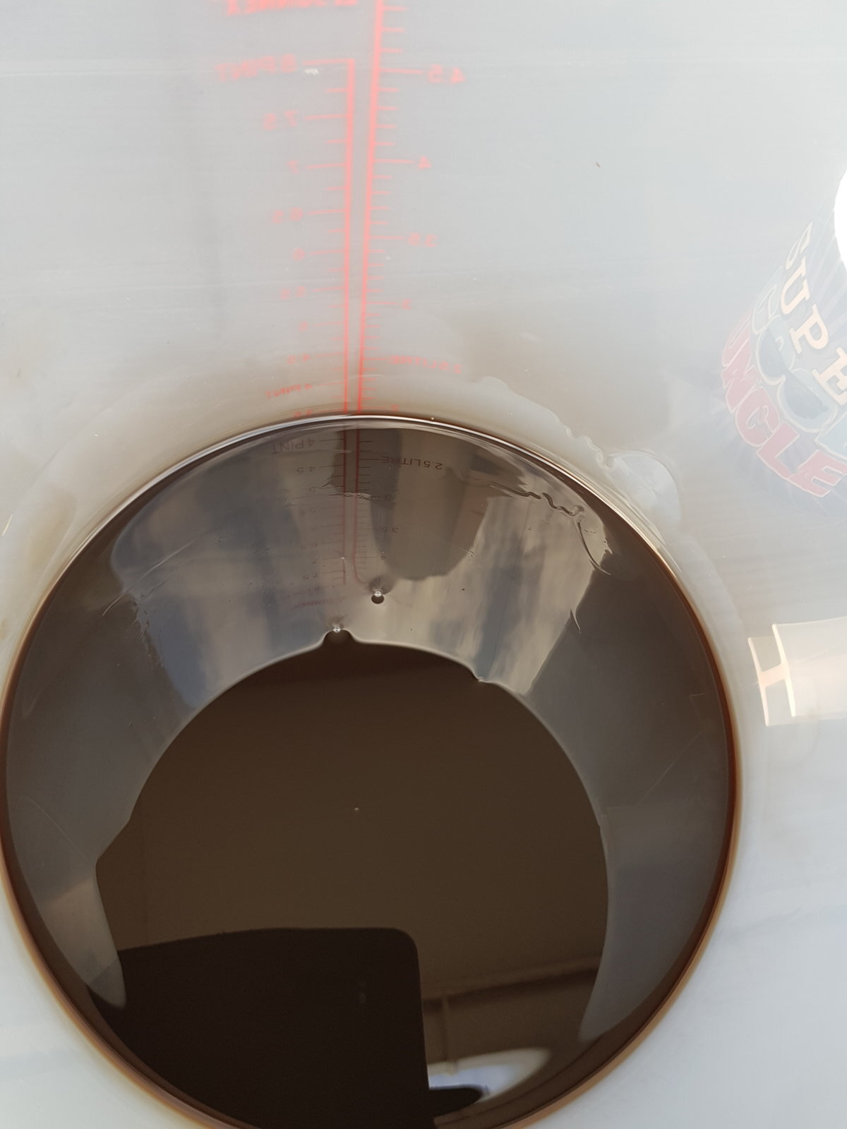

Job done and yes it does feel smoother already. I would say that the sealed for life WS fluid is definitely not sealed for life. It was not nice and red when coming out(see Pics). And I'm only on 82 thousand miles
I then put a small bead around the face of the auto box and 're installed the sump pan. The chocolate bolts are 10mm if I was doing it again I would order a new set off bolts.

Job done and yes it does feel smoother already. I would say that the sealed for life WS fluid is definitely not sealed for life. It was not nice and red when coming out. And I'm only on 82 thousand miles

Its not really the mileage that bothers me, it was the fact i was driving around with 13 year old oil in the box.
i think the photo of the old oil in the jug shows that it needed changing. il take another pic of the oil when i drop it again and see what it looks like.

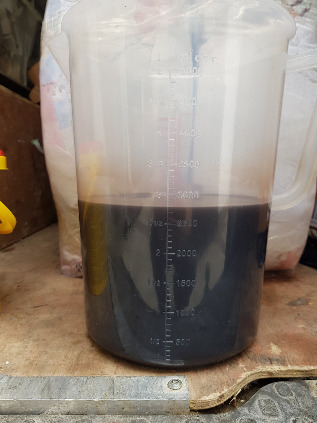

I dropped it out again I only got out this much. But I do have enough oil left to drop and change again.
The colour is slightly better this time. Now I have dropped the sump and changed the filter, the changing of the oil is easy with the pressure bottle.
