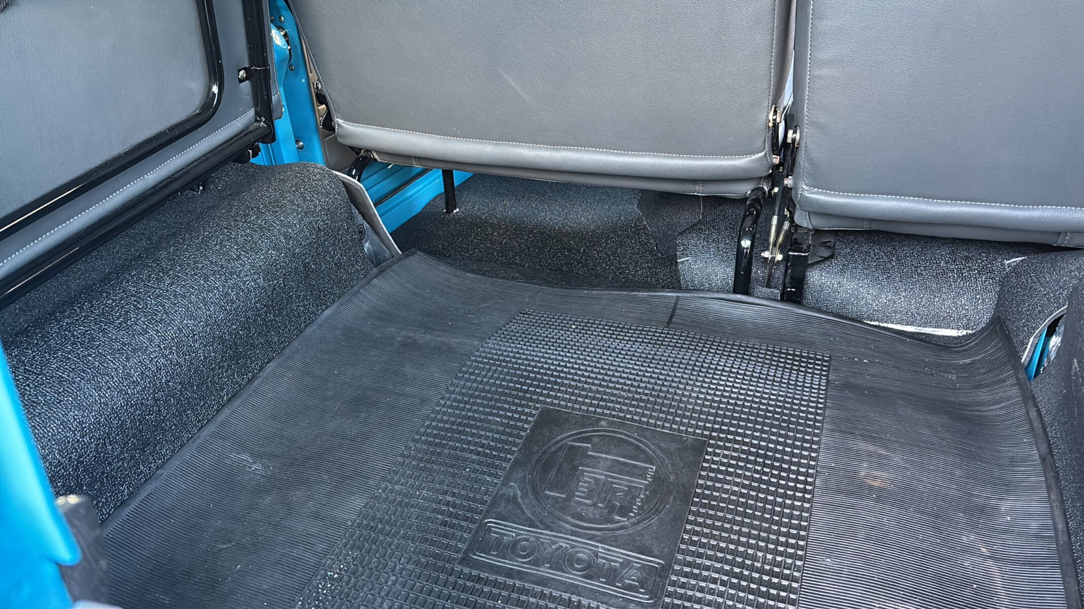

I know the FJ40 isn't meant to be luxurious, but I wanted to make it quieter for longer journeys!
I used Canopus 2mm self-adhesive mat followed by Dynadeck.
Took about 6 weekends to get it cut and fitted. I'm sure it could be done better but the Dynadeck is tough to form!
Should also say I put Dynamat extreme in the doors, with some success, but didn't stick very well. Also put Dynamat hoodliner on the bonnet!

Regarding the sound deadening, being a soft top we did not use any sound deadening but, having travelled in a hardtop 40 in the past, it is a necessary addition and it will enable you to hear the radio.

Covering up all that lovely blue paintwork was tough, but I wanted to make it as comfortable as possible to drive around. I think it has made a massive difference and as said, I can now hear the radio!
