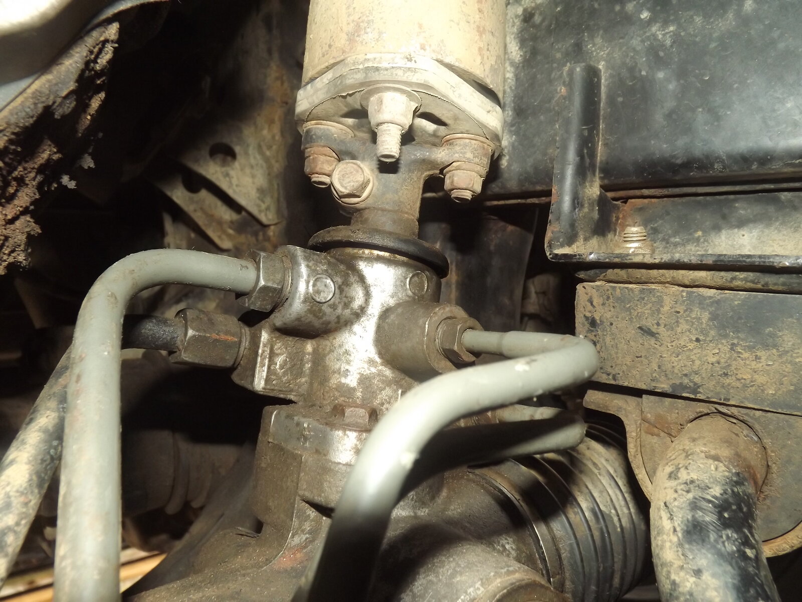

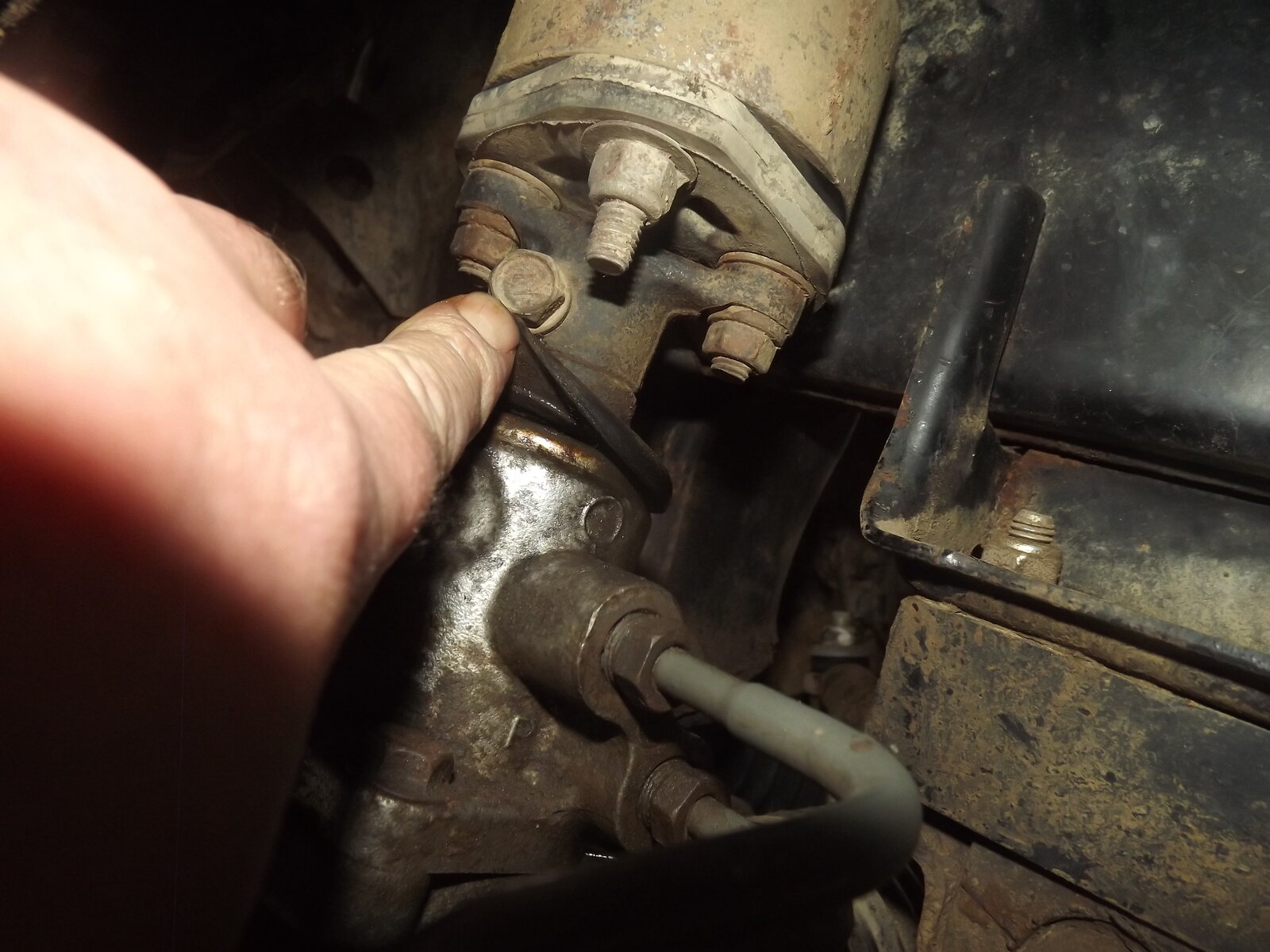

Bushes need replacing to and i can find no mention of this repair on the web so shall i go for a new rack ?

Cheers Bodhi your post made me look again and notice the pump is a separate part . Unfortunately mrT doesn't sell it separately though so the choice is £300ish from Roughtrax for the full rack , bushes and tie rod ends which despite not being genuine does at least come from someone with a reputation to protect , or , a new pump from some bloke in China for £35ish :think:
That thing is called the actuator (it's not the pump) from memory and there is a rebuild kit for it comprising of some very thin O rings. It often seems to go after fitting a lift kit. If the steering rod isn't quite floaty enough it seems that the actuator takes a bit of a kicking leading to it leaking. Pretty sure someone did do a thread on the repair.
Thanks Chris just knowing what its called helps . Roughtrax does a repair kit of some kind and had assumed it was for the pump on engine , i better look again .
I seem to recall that there are 4 thin sort of ceramic rings and a rubber one. I changed the rubber one and that fixed it. The ceramic ones looked a bit challenging. Now, I am sure I still have them in the packet after all these years. See what RT have etc and you might be sorted but if it comes down to having to get the lot from Mr T at silly money I can send you these. But like I said, you probably only need the seal

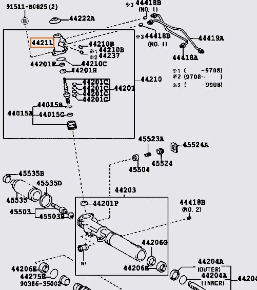

It's called the control valve. My mistake. You can see all the bits here.
Excellent now we are getting somewhere , i do like the idea of just changing the rubber bit i will do some googling but i'm already hoping Simon knows which one is the rubber one , unless i can trouble you that much further ?
44210C is the one that leaks I think. You can see the 4 other rings lower down. It was a VERY long time ago.
44201F is described as a seal so at least i have a choice to present Simon with , thank you for your help much appreciated :thumbup:
