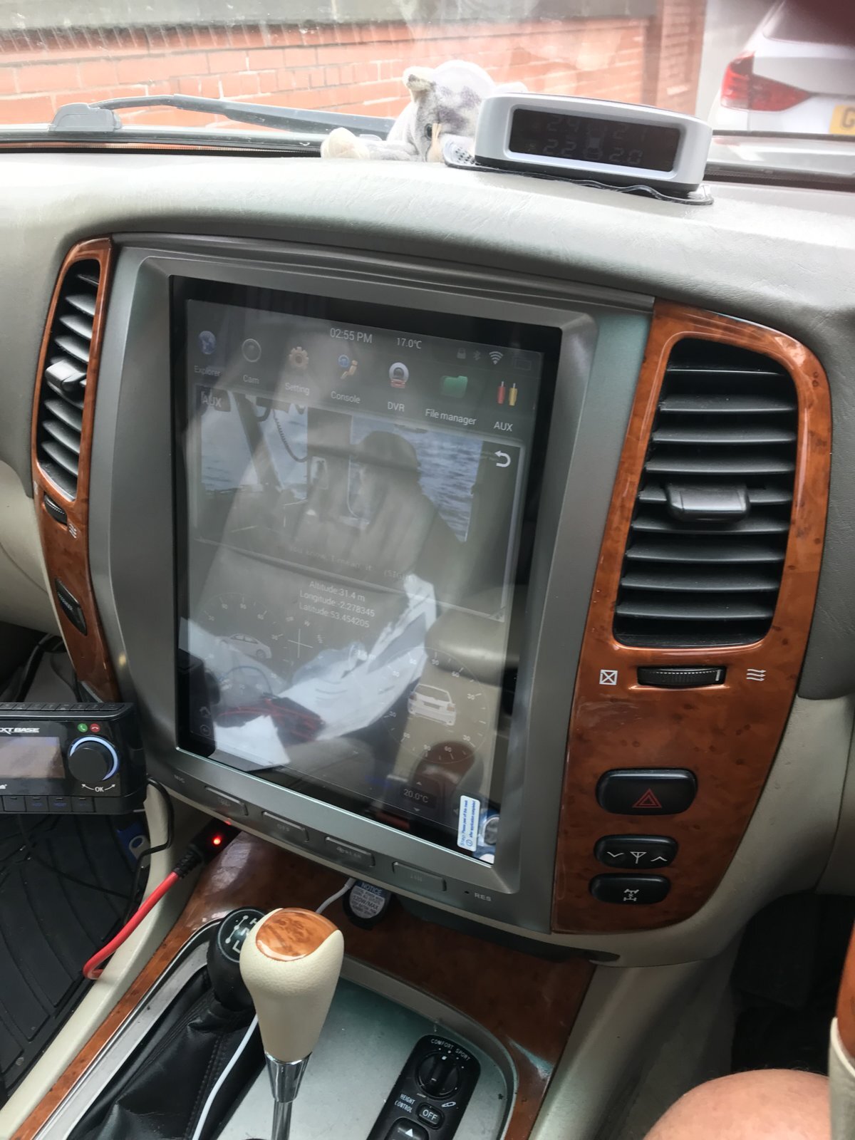

well ive fitted the tesla screen it works well and sounds a lot better if anyone wants more info contact me .
Does it incorporate all the functions of the Cruiser screen and a lot more? a pic or two would be appreciated.

my conversion was virtually plug and play and im still learning. Aircon works fine as do all the other things ,the only fault i could find is the front and rear fader doesnt work (this doesnt worry me) and on start up its about 22 seconds (just like turning on a phone).ive added tv and it works great and the sound quality is superb.
so to cut to the chase mine was plug and play ,there are alot that arent so beware.I purchased mine from symacshop, ithink it said italy but i suspect a front for a chinese company but having said that theyve been ok to deal with and they take paypal,you can also find them on ebay and they take paypal which is a god send for protection.when you look remember lexus 470 same car.
