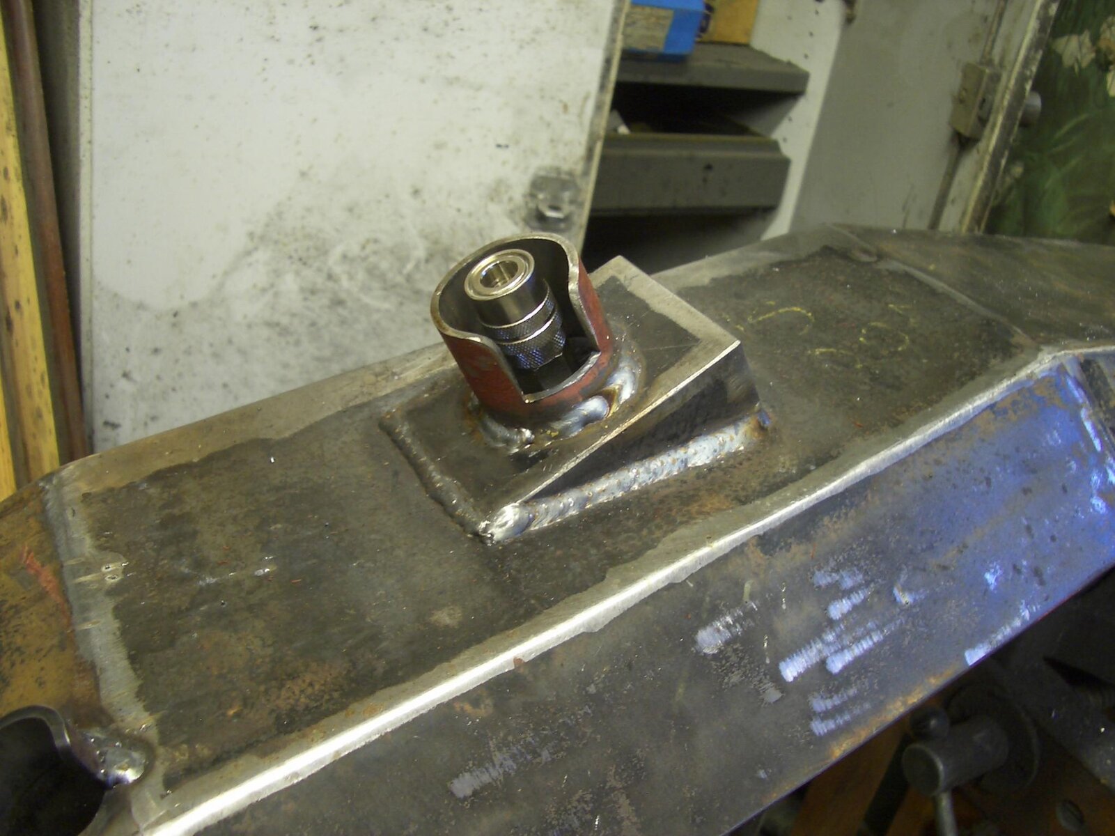

Very nice Lazz. Another idea you could nick from Chris is the air outlet protection that he made for Lil'Blue and his current 80. There must be pics somewhere..
Ahh yes, the shroud. I did that on this truck and Lil Blue. It a piece of gas pipe profiled and welded around. Despite my best efforts, I have never hit the outlet. Filled them with mud, sure. But all you do is pressure up, then shove a screwdriver in and Fsssst! All the mud is blown out. The pipe I use will take a tow ball cover actually, that keeps them clean.
