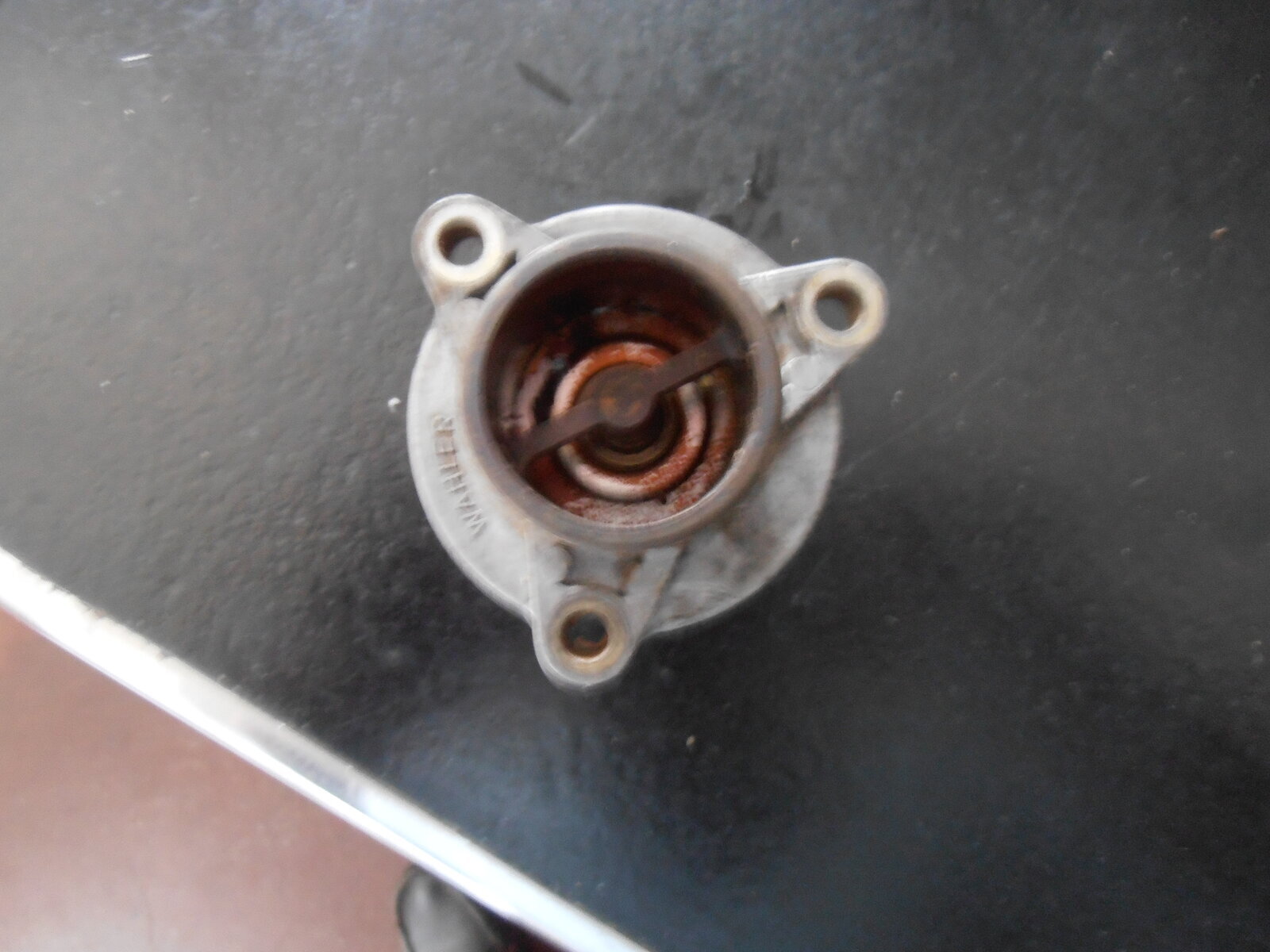

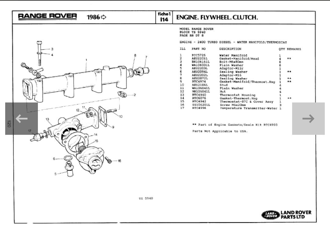

I'm adding some info here for anyone else with a VM 5 cylinder BJ73.
The thermostat is not the same as the one on the VM 4 cylinder, that would br too easy!
The VM5 (VM66A) has its thermostat built into a housing which is three-bolted onto an end piece from the engine coolant collector.
I have been unable to find a part number, nor any information on this thermostat.
There is a Land Rover with a similar VM engine that has a similar thermostat but it opens at a higher temperature to the specs on the Land Cruiser.
It's a Wahler thermostat but there are no other markings on it.
A mechanic I trust said it could be possible to cut out the original thermostat from the housing and use a thermostat which is inserted into the coolant hose.
If I find anymore info, I'll post it here.
