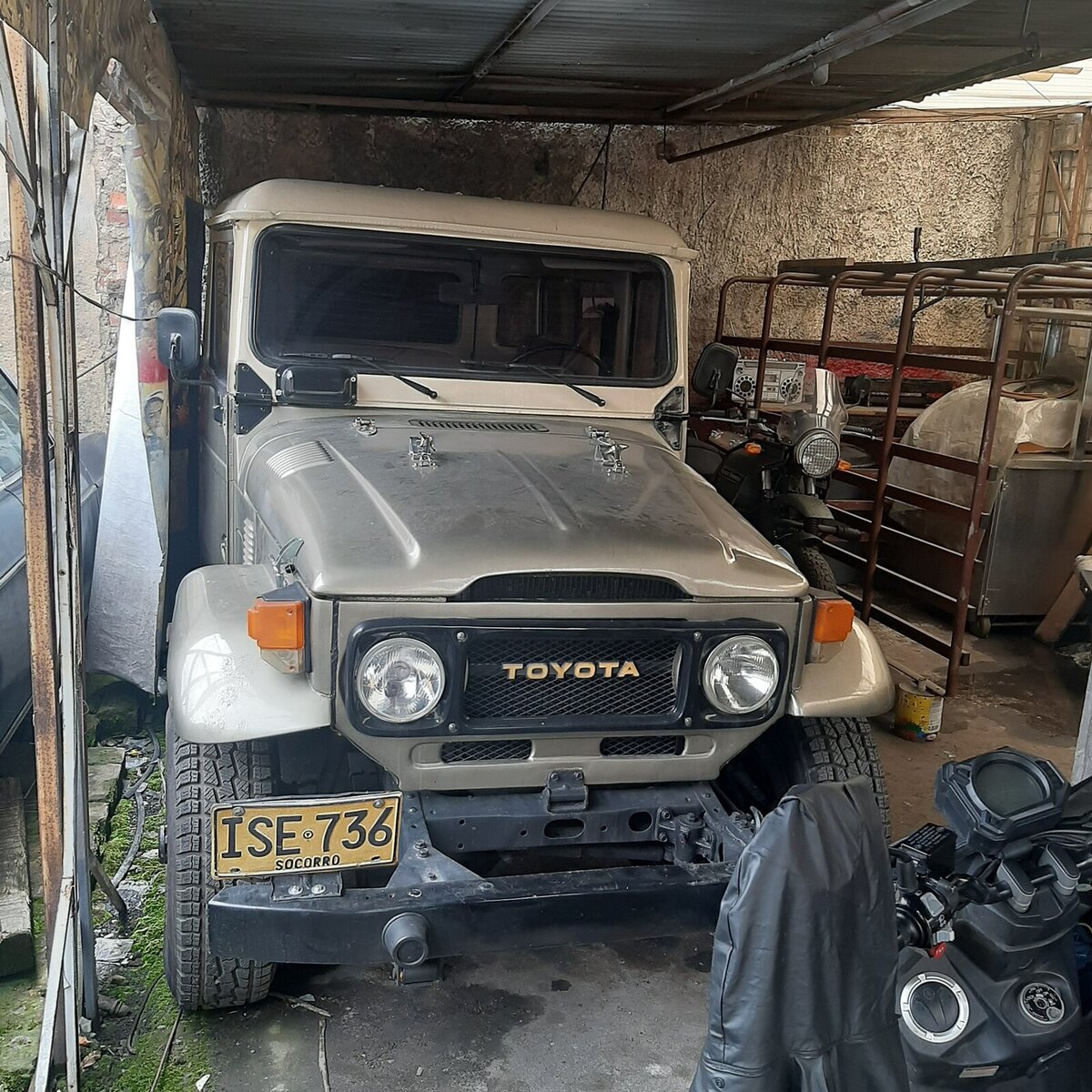

Hi folks, restoring this 1978 FJ43 landcruiser.
Best tires for it? Probly 50% off roading driving.
33x10.50-15's look the best but I've heard they need a 2.5" lift...

I can't help with a 40 because i never owned one , but if your new to this it might save you a packet to find a build thread and copy it '
Sometimes the discrepancy between what size is written on the side of a tyre and the actual size once fitted to a rim is as much as 2 inch difference !
Also pay particular attention to rim offset , or backspace i think Americans call it , used by others to get the look you want .
I've an inkling subtle is not what your looking for and so i would suggest you search google images for "FJ40 4" lift just to get an idea of the end result .
