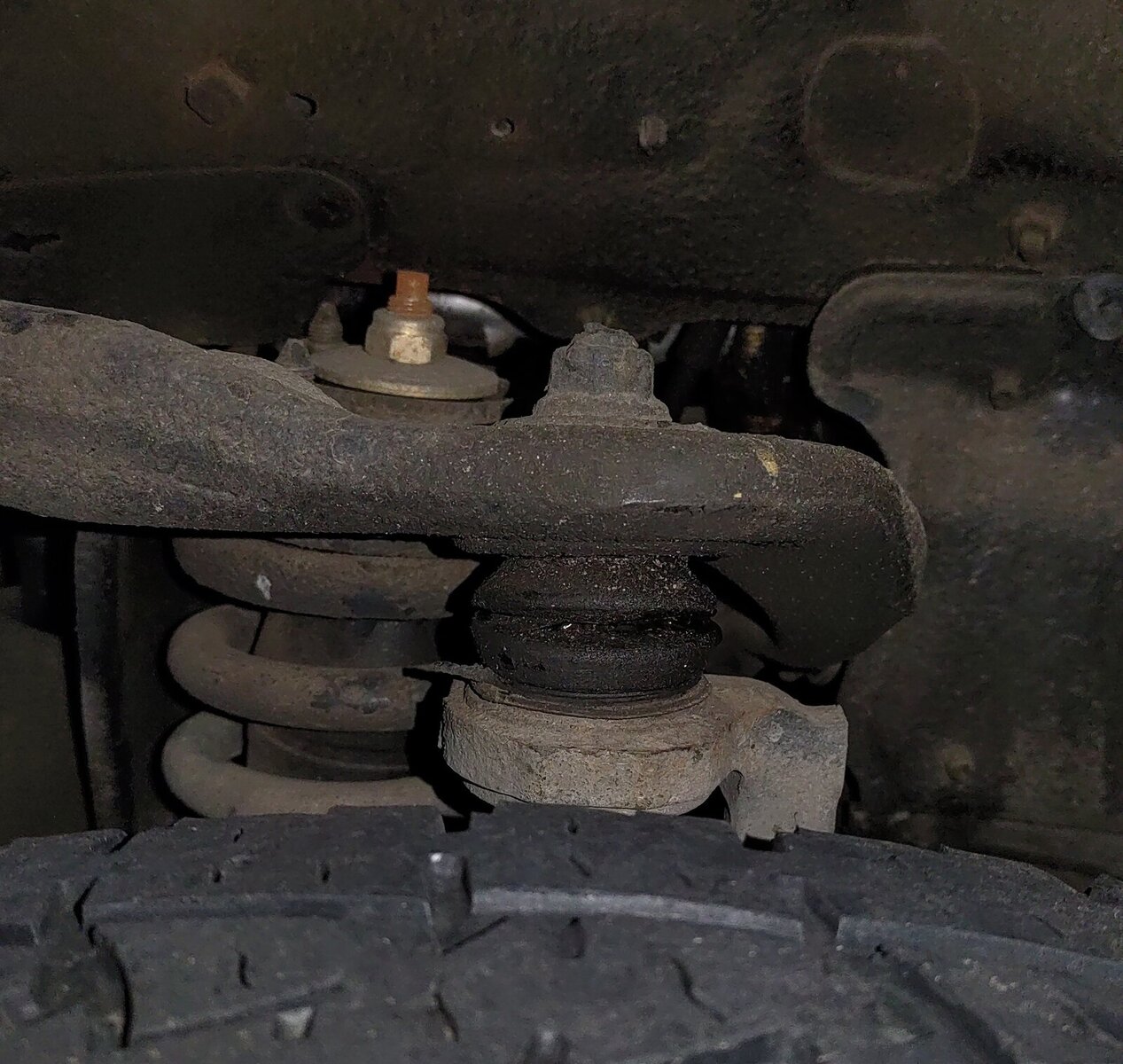

So I was looking around today and found a split in an upper ball joint boot. Looks OK inside and it's just a narrow slit at the moment plus I don't think it's been there long as I last inspected them 6 months ago.
Anyway looked in the trusty Haynes manual and replacement of the UBJ (or UBJ boot) seems simple, looks like you unbolt and split the UBJ off the upper control arm then the whole knuckle droops down. Doesn't look like you need to remove any other suspension components or half-shaft etc.
Surely it can't be that simple? Has anyone done it and if so what kind of splitter did you use?

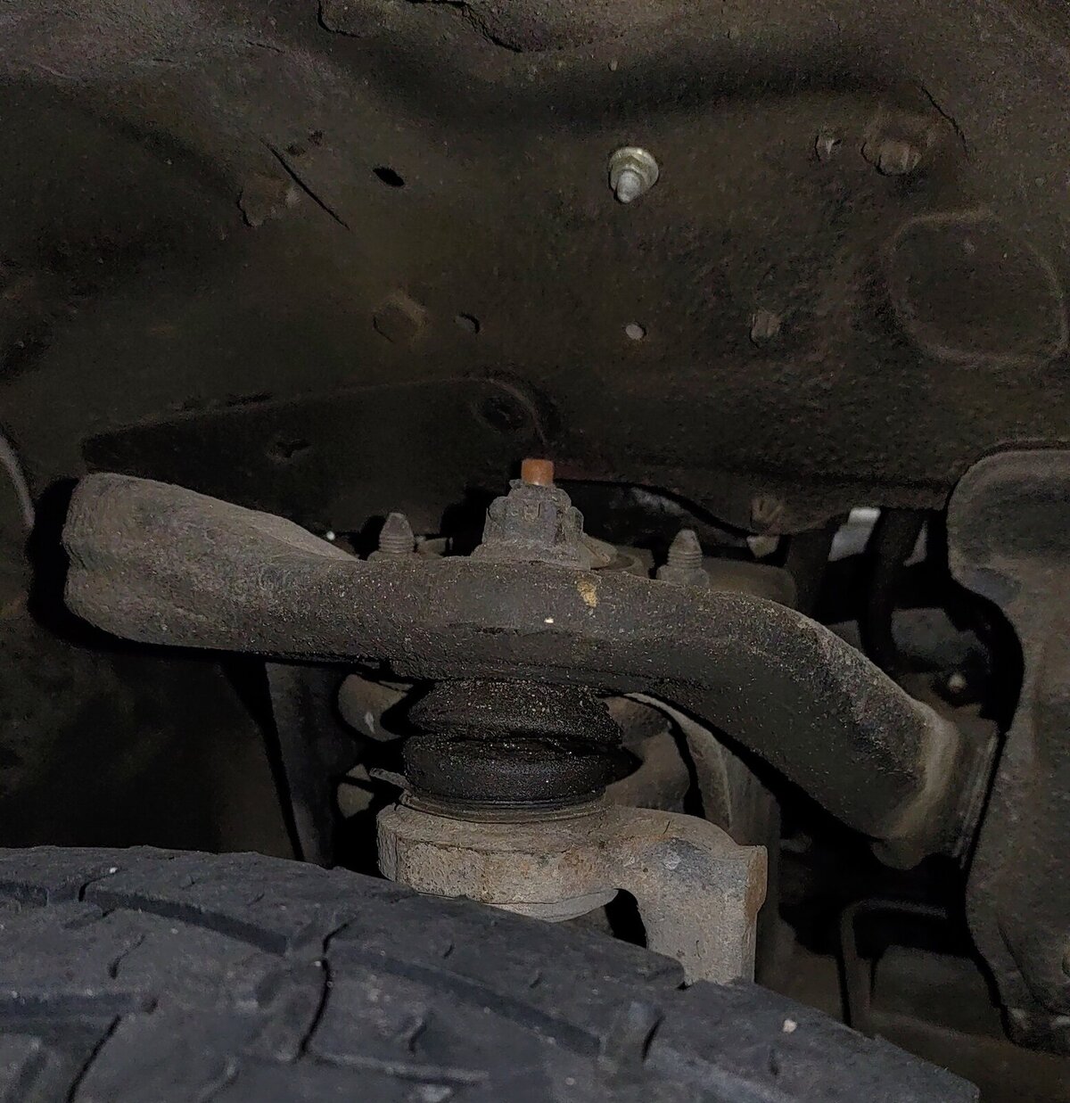

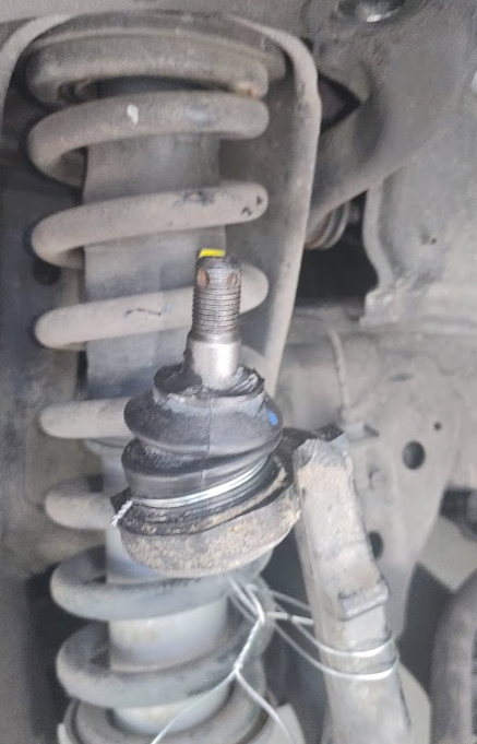

Thanks Bob seems like something I might be able to do. Here are some pics. Hopefully not as rusty as cars your way get but I expect it will put up a fight!

The procedure I used was as follows. Note though I am not a mechanic so this may not be correct.

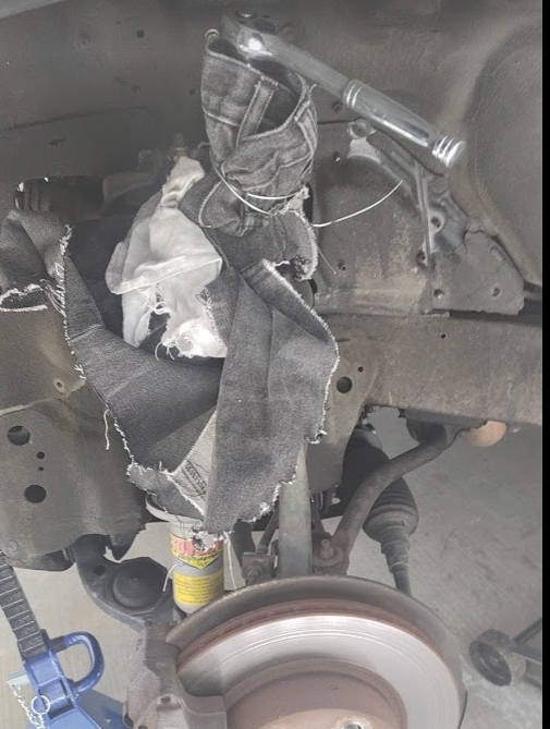

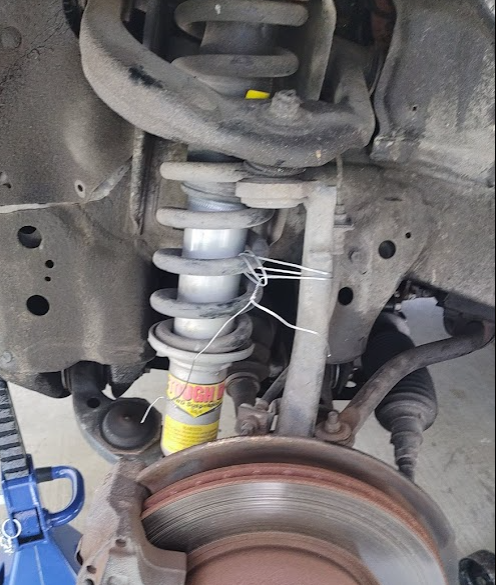

1. Jack up and remove wheel and wire knuckle to the spring. You don't want much slack in the wire as otherwise the brake hose will get stressed. This car doesn't have ABS but if you do you might need to remove some sensor wire bracket.

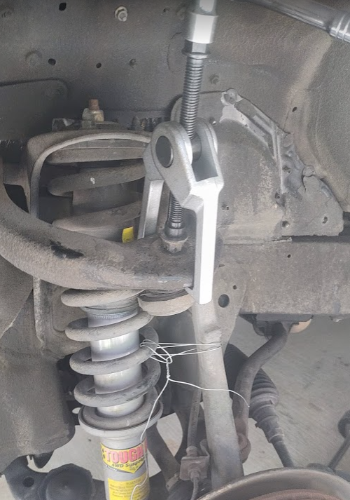

2. Remove cotter pin and castle nut and turn castle nut upside down and screw it back on leaving about 1-2mm of space before it touches the UCA. The setup separator and tighten 1/2 turn to hold in place:
3. Wrap separator in rags and tie up (in case it flies off or breaks):

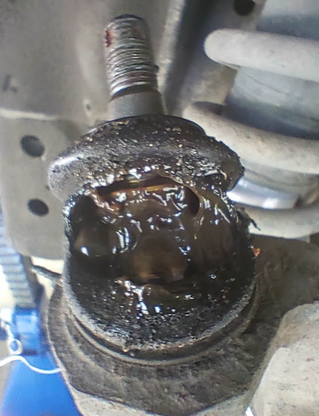

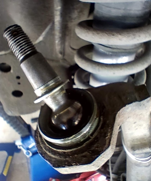

4. Separate UBJ and free from the UCA, Luckily my grease hadn't become full of road dirt:
5. Clean up UBJ and check for freeplay etc. My Haynes manual says <= 0.5mm acceptable but I could detect none in mine and it was still reasonably stiff but not over stiff:

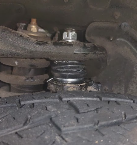

6. Repack UBJ and boot folds with grease and then tie off UBJ with wire. Note the wire twist tang should be pointing front or back, not to the side:
7. Remount UBJ and torque (Haynes manual says 105Nm) and install new cotter key:

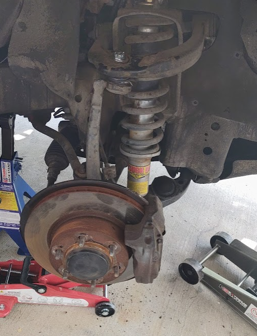

8. Rinse and repeat! Note I used a spare car jack to support the LCA.

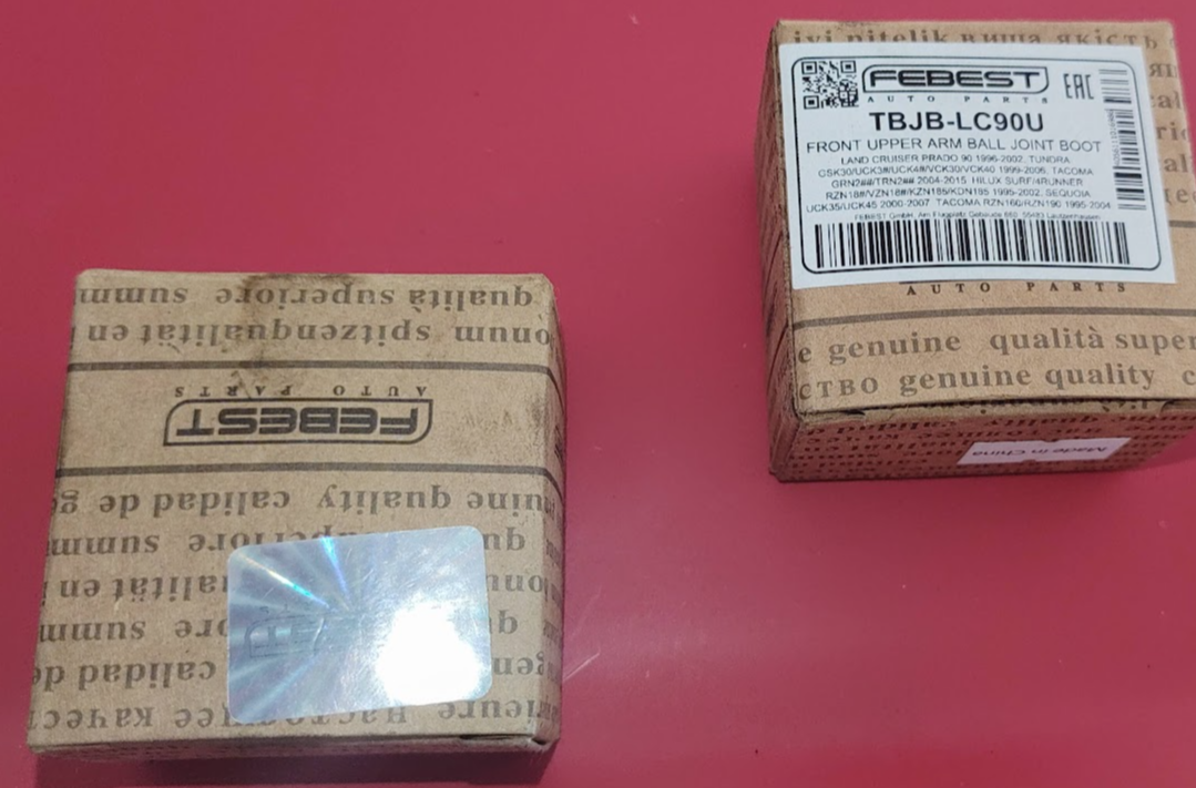

These are the boots I bought (ebay). They are pretty good quality I think but I couldn't work out the wire thing they supply (step 6) - it was a bit like a loose keyring and flat. I just used some galvanised wire I had hanging around.
