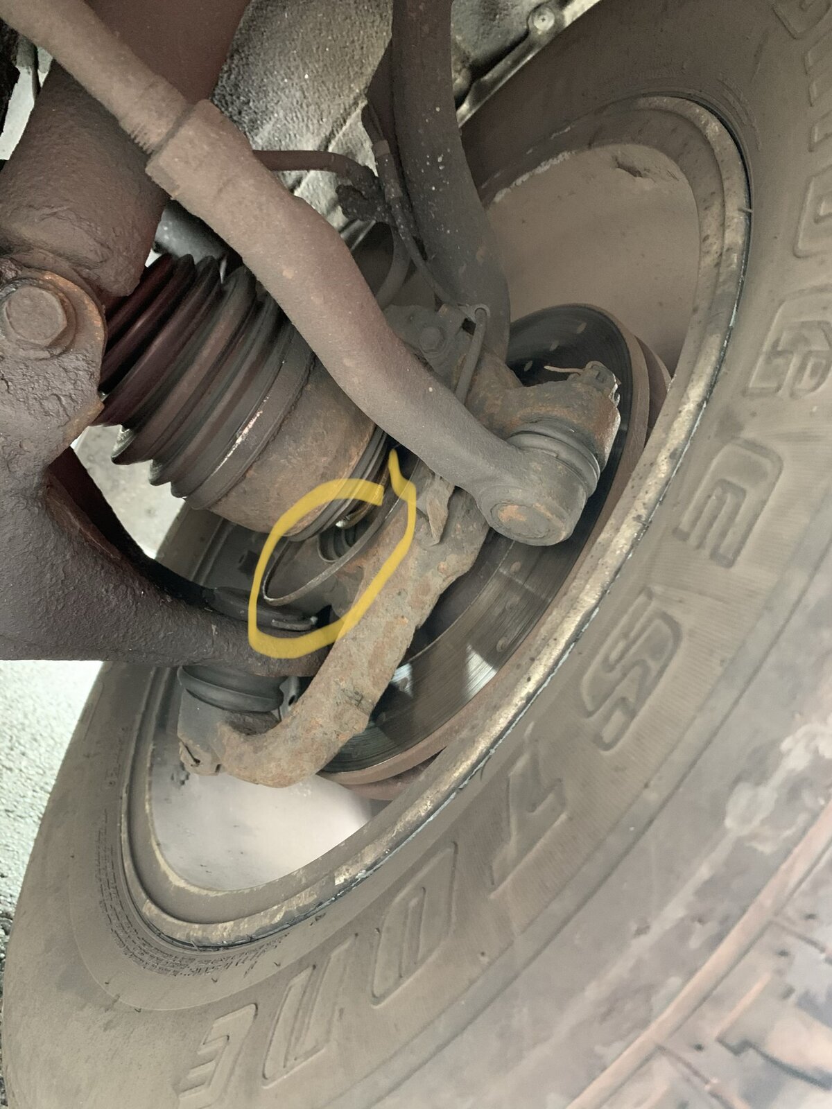

Well last sunday all wel until i pulled out of garage ,then there was a horrible grinding noise from the auto box thinking gearbox had gone i went on facebook to tell my tales of whoe while waiting for AA,suddenly a member of one of the forums came to the rescue , put it centre difflockand itll drive ,at which point AA man arrived we did it and it drove ok home with him following , he went under the car and sure enough the shaft has either broken in the hub or the split ring failed .Either way new shaft and hub being fitted monday.typical my mechanic was away last week
