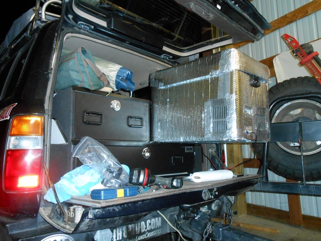

Heres my DIY 'wrap' before our year long trip.
Worked well but not scientific measures
Was a 60L 'cheapie fridge+freezer($250) (worked well until I below it) but eventually had to switch to Engel
