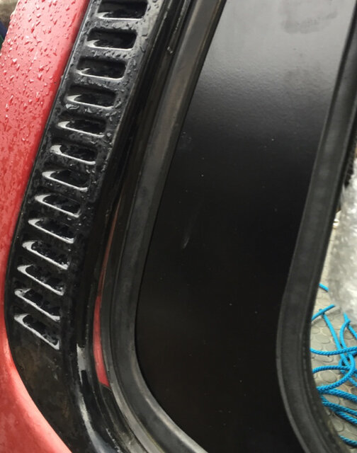

Have a look on the gullwings thread. They are very slightly different. What I would say, is if you have the sliding style windows, clean the junction of the vent panel with the metal of the frame and stick a length of black electrical tape down the length of the join before fitting the glass for which you will need the fixed window rubbers (number in the gullwings thread), one each side. The rubber covers most of the tape and join so it's not a bad compromise. Longevity? Don't know yet. [emoji4]
Thanks Brian, but the louvre panels look the same to me...:think:

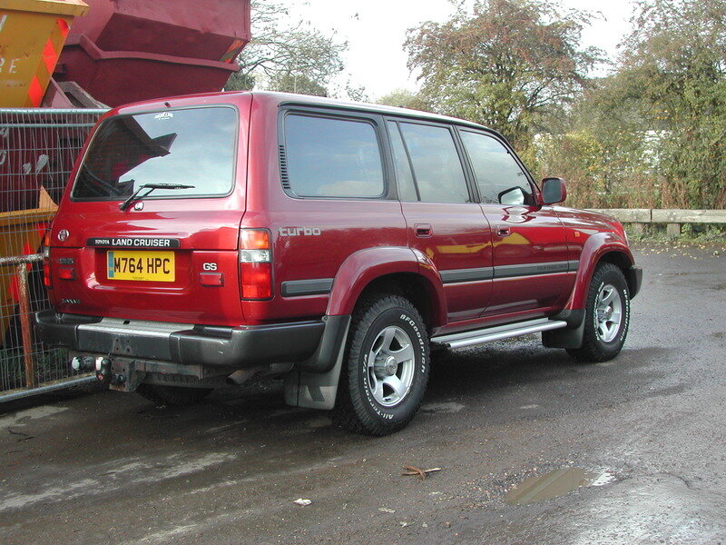

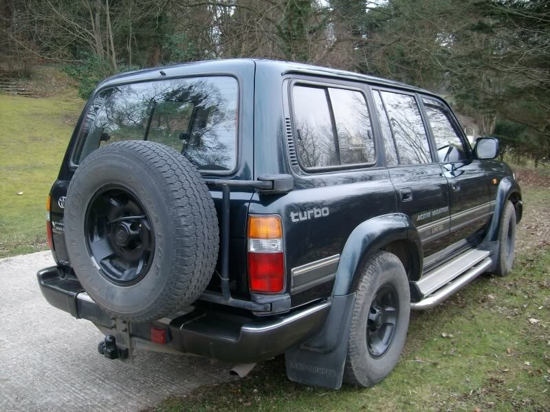

Assuming the 'hole' in the metal is the same the louvre on the fixed window looks thinner to me.
I can't see any difference from them photos,
Perhaps need more of a "full on" picture of each?

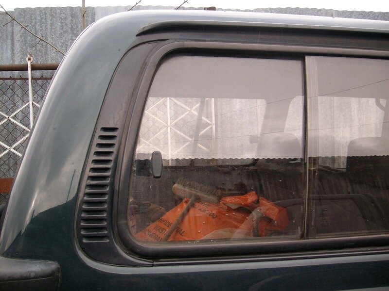

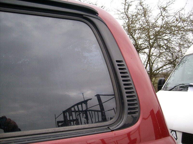

Chas's sliding window style louvre.
The fixed window style extend further towards the rubber and are broader at the bottom curve.

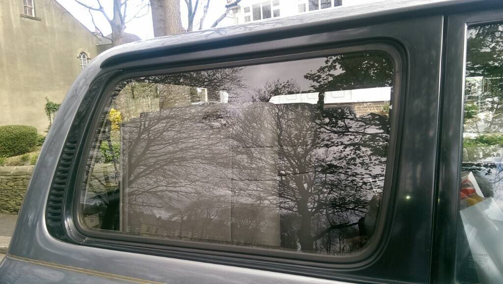

Just got mine back c9ed2f5b7e4083270707a1bea407cce1.jpg1b28ec1060db2015208cc42c60383bb0.jpg. Complete rotten framework all good now, the plastic vents are definitely different the are deeper on none sliders
Sent from my HTC One using Tapatalk
I also think the fixed glass looks a lot cleaner than the sliders
