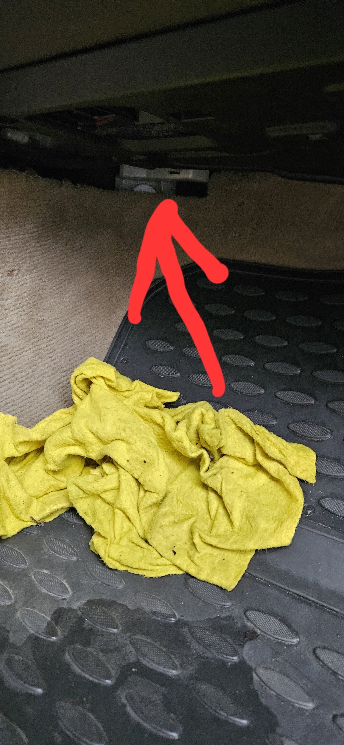

Hello all,
I got some water dripping on the passenger side down on the floor mat after starting the engine, not much but I’m worried a bit. After start driving there are no more leaks. Looks like is pushed by the fan once the engine starts. Anyone has encountered this, and what can be the cause? Car is parked outside..
Thanks a lot!
Sunroofs are supposed to leak , they have drains which can get blocked letting water into the car .
Make sure the drains under the scuttle panel are cleared out. In autumn/winter they fill up with leaves etc then the water cant escape and flows back into the fan.
+1. There are trees near my land, and this time of year they float all over the lc, resulting in scuttle, wiper spindles and bonnet hinge clearing once a fortnight. Wet leaves stick to everything.
