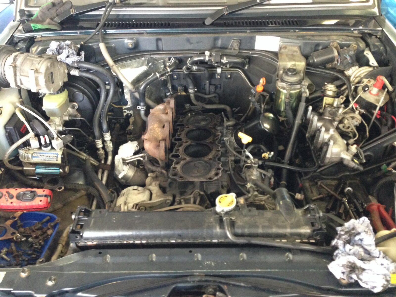

Got the head off yesterday

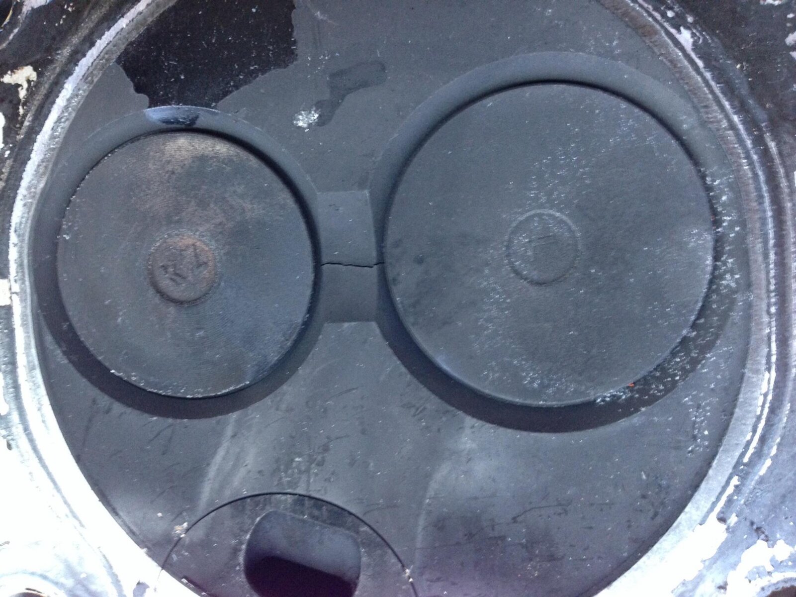

And the usual cracks between the valves

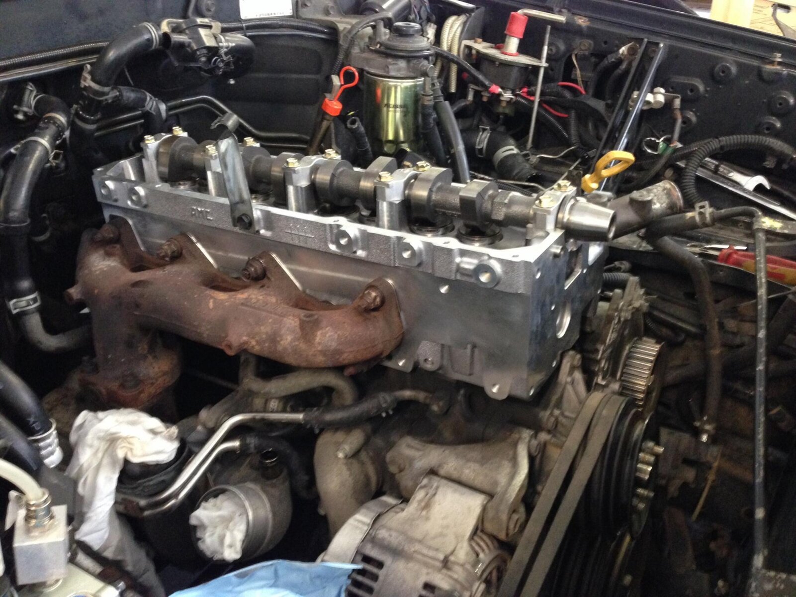

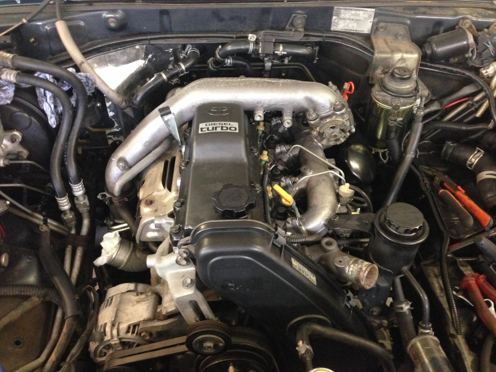

But have my shiny new head on today
Just waiting for my shiny rad from Allisport.
