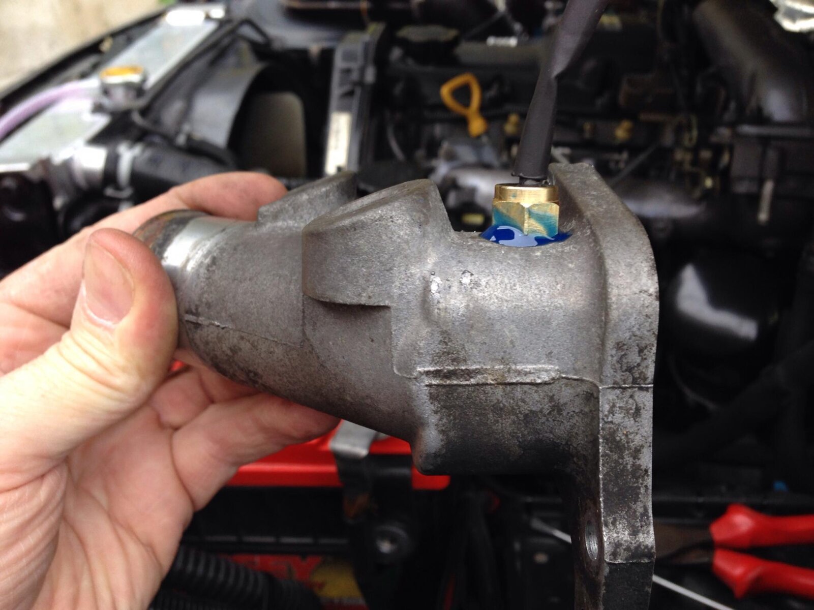

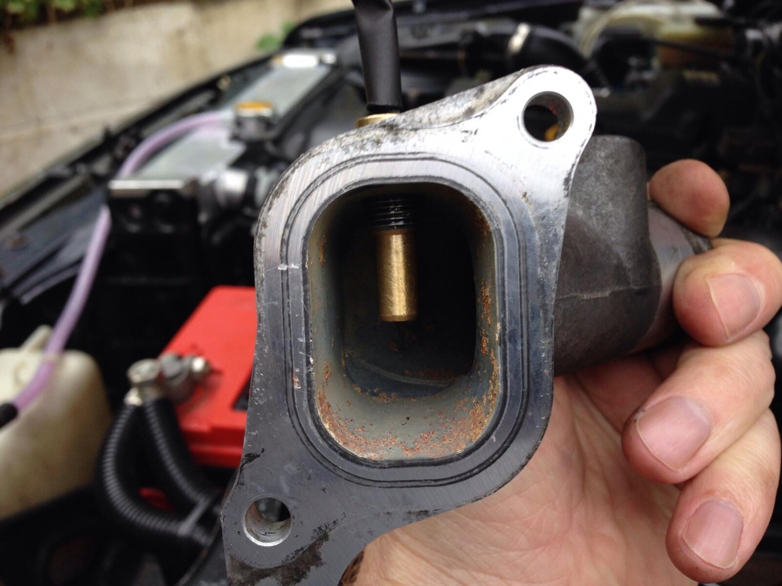

Today I fitted another and upgrade on the after market temp gauge and alarm, it comprised of another temp sender that a drilled and tapped into the top alloy water outlet the standard one I had originally fitted just bolted to the alloy housing and although accurate after fitting the new sender I realised it was about 6 degrees lower.
Now the running temp at tick over is now around 80 and rises to 88when driven quite hard.
Looks good Rich, the only issue is that if a rad hose bursts/something goes through the rad and you loose all your coolant I don't think you will get an accurate reading to say your engine is overheating.
