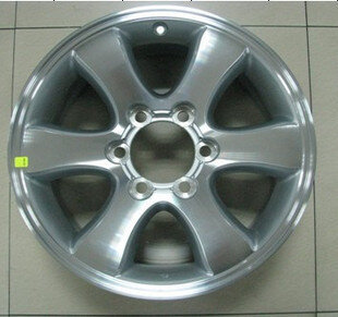

Graham Well-Known Member Joined Mar 22, 2010 Messages 3,981 Garage Country Flag Feb 16, 2013 #1 Hi all. Am I right in saying the standard Toyota rim like this is 17 inch dia 7,5 inch wide 30mm off set, the rims are center line of the rim is 30mm closer to the vehicle center bore 106,2mm PCD 139,7 with 6 studs Gra.
Gary Stockton Super Moderator Supporter Joined Sep 10, 2012 Messages 4,075 Garage Country Flag Feb 17, 2013 #2 Yep. JJ rim section Sent from my iPad using Tapatalk HD
