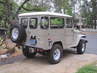

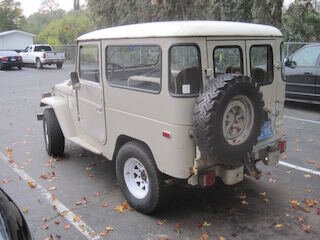

There has been a lot to this build so for now I'll post photos and down the road I'll fill in a few specs... Currently I am about one week from taking this project on it's first test drive :dance:
Day 1

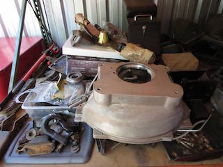

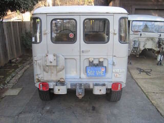

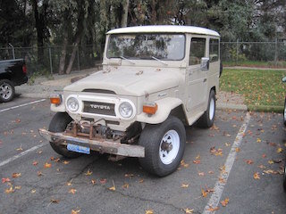

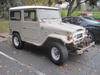

2nd owner 1975 FJ40:
Engine: 2F
Trans: 4 Speed
OEM PTO winch
Solid stock cruiser
Hundreds of up to date build photos found here:
Click Link
On my Cruiser Innovations Youtube channel I will be posting the first start up of this cruiser which should air in the coming week or two. Stop by my Cruiser youtube channel and subscribe to be immediately notified of it's reveal:
https://www.youtube.com/user/CruiserInnovations

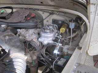

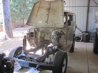

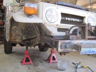

The idea of the cummins conversion was a toy'ed idea at this point. Step one was to make the cruiser handle...
Hydro boost brake booster for the 4 wheel disc brake conversion
rebuild front and rear axles
Tear down time.

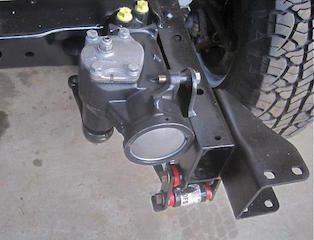

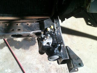

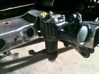

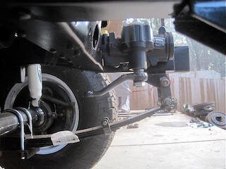

Saginaw Power steering

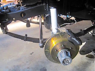

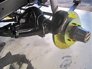

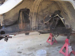

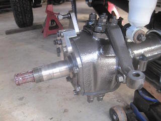

Front axle removed, stripped, rebuilt, wilwood disc brake conversion, Skyjacker soft ride 2.5" lift springs, and some other crap...

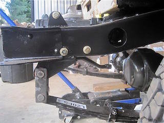

New brake lines, Procomp ES3000 shocks, steel braided flex brake lines, and new u-bolts (Of course)
I have yet to see a straight OEM tierod bar so as a rule of thumb for me I either replace them with heavier DOM bars or sleeve them like I did here.
New tie rod and drag link ends.
Power steering pump retro fitted to the 2F... For now :)

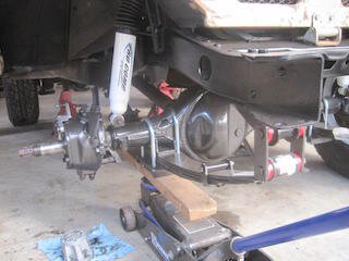

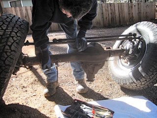

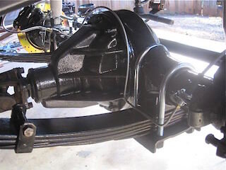

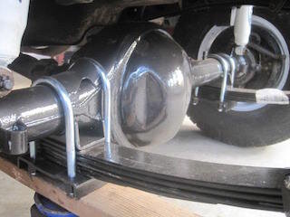

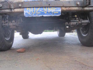

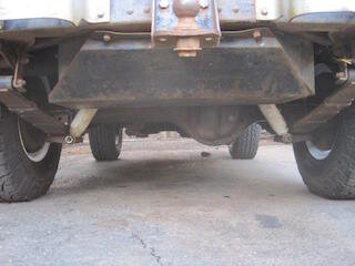

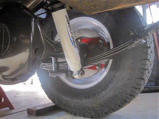

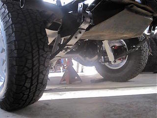

Rear axle time:
Rear axle removed, stripped, rebuilt, and GM disc brakes installed.
Skyjacker soft ride 2.5" lift springs, Procomp ES3000 shocks, new brake lines and phase 1 is done...

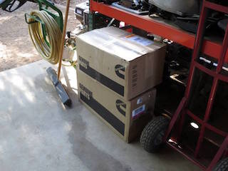

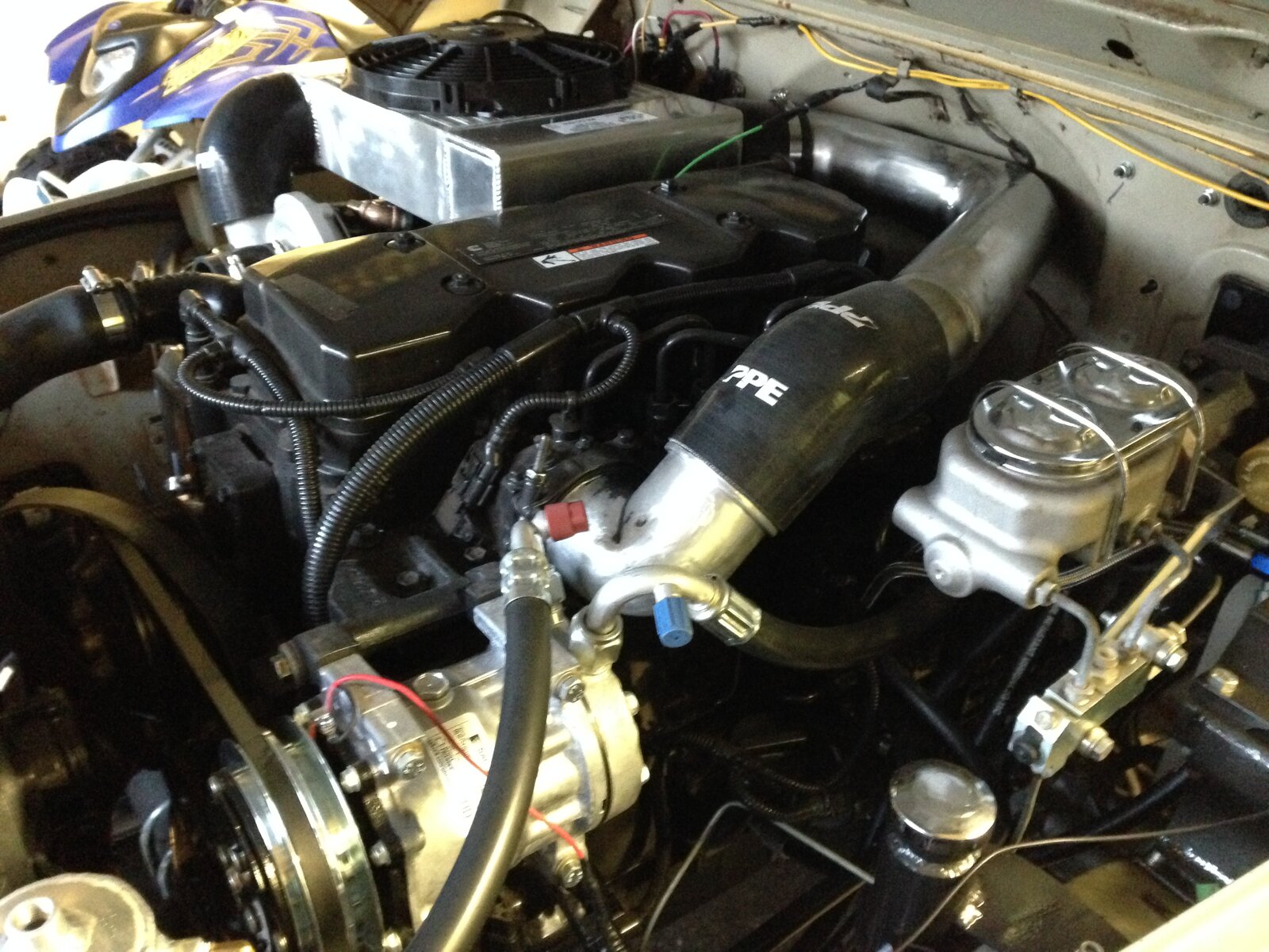

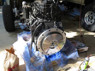

The cruiser was delivered and driven for a good 2-3 months when the decision was made to move forward on the cummins conversion..
What you see here is:
2013 4.5L Cummins
Rebuilt NV4500
and a few other boxes of goodies...

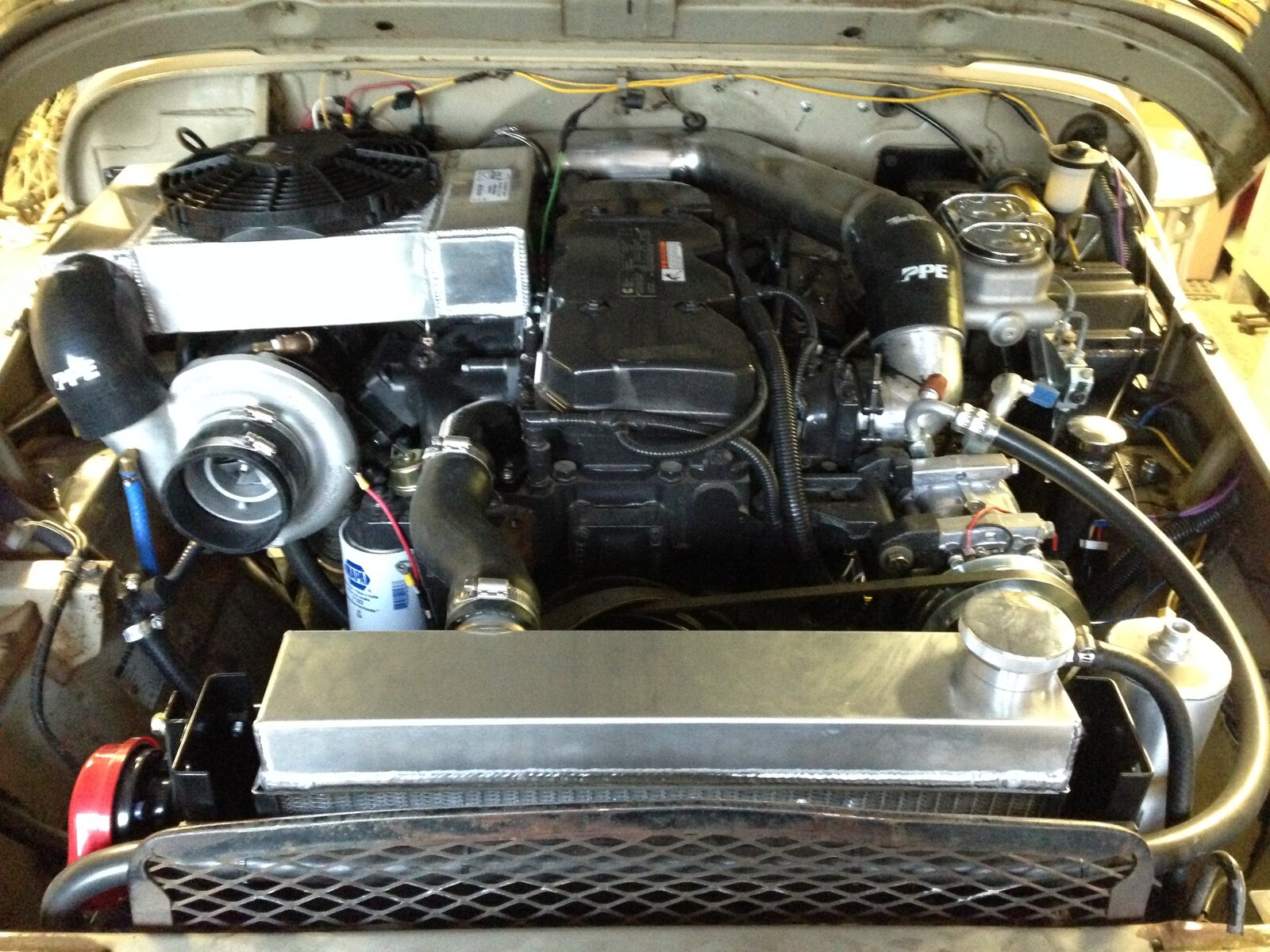

Inter cooler / intake system amost DONE!
