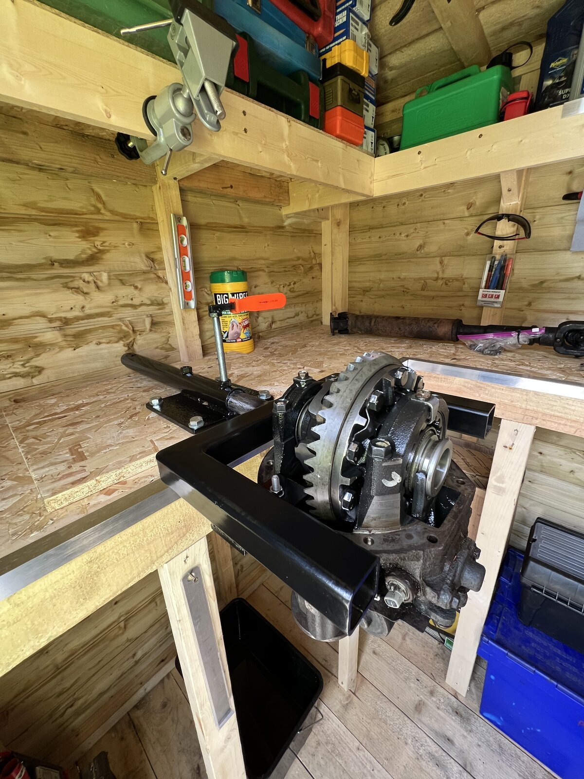

Hi all,
In my haste I’ve bought a 4.11 ‘US Standard’ ring gear and pinion. I was after a ‘Nitro’ 4.10 setup but the suppliers were all out of stock untill at least July 2022, so I just had to buy the closest ratio I could get.
Is there any reason why this won’t work ? I’ve read somewhere that tire inflation alone could be more of a difference that the difference between 4.10s and 4.11 when used simultaneously.
I would really appreciate some advise/commentary on crush sleeve v solid pinion spacers also.

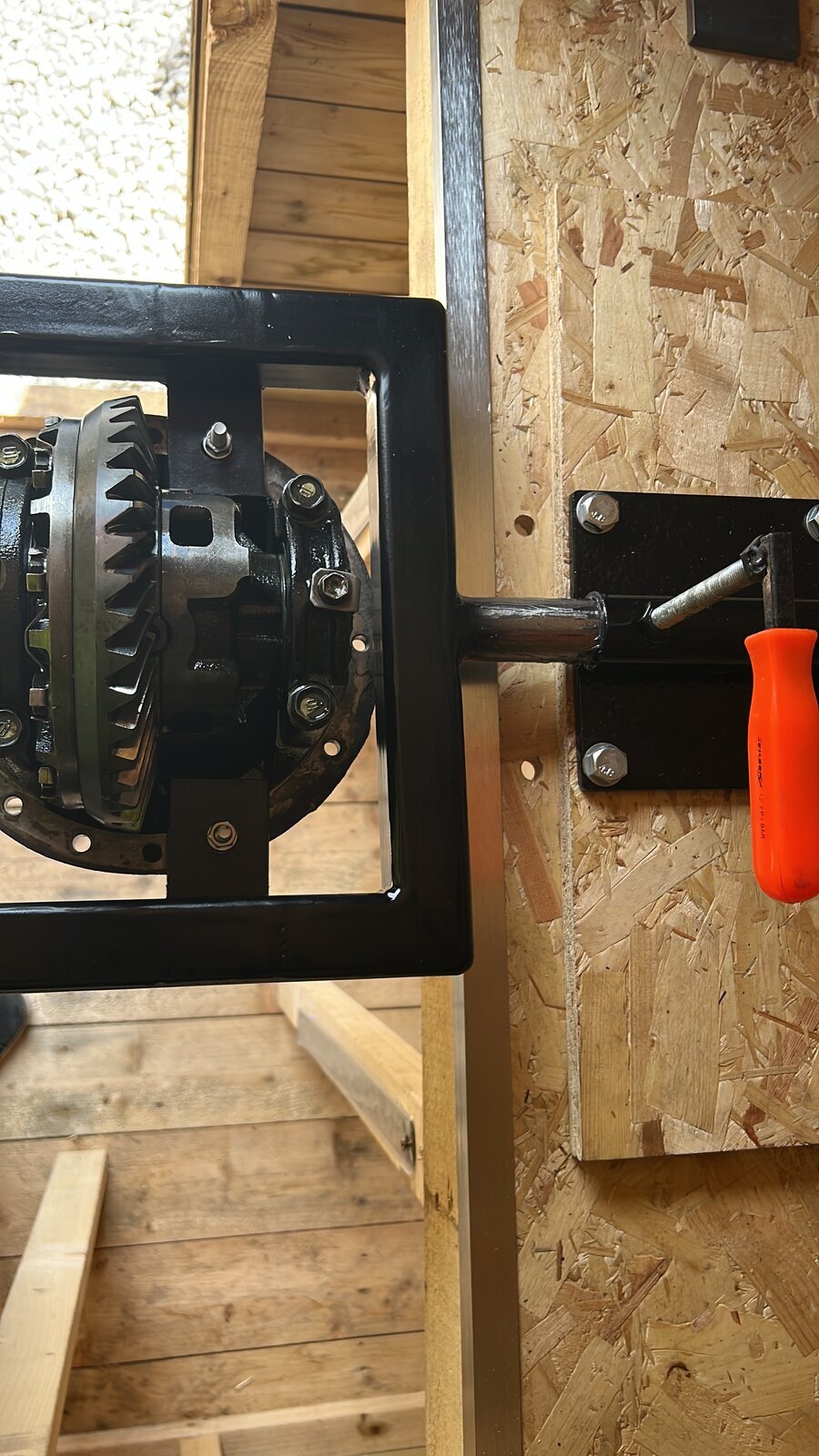

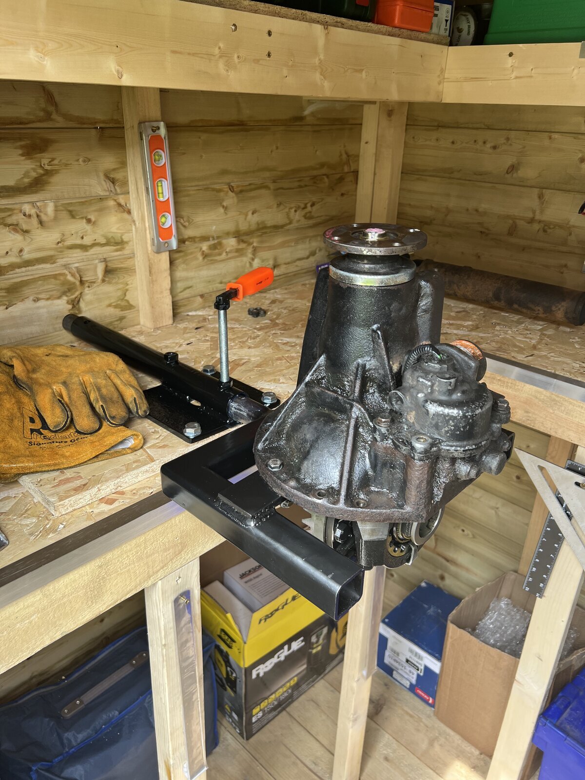

I’m in the process of rebuilding my front differential completely as you can see below.

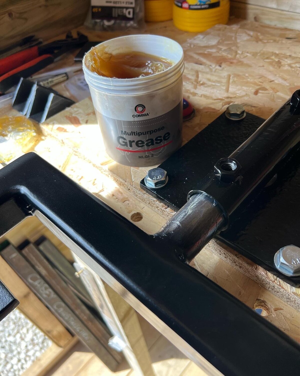

PS, I fabricated this bench/diff holder from some old mild-steel sections and a used pry-bar handle. I’m hoping this makes my life easier.
Thanks in advance all !
Mark

@Beastrider yes I’m certain. I believe back in the day Toyota in America the 4.11 was the preferred option (37 teeth ring and 9 teeth pinion: 37/9 = 4.11) it then got redesigned to the 4.10 (41 teeth ring and 10 teeth pinion 41/10 = 4.10). I’ve read on many forums that the 0.01 will make no difference but I wanted to check with my own community that it will be fine.
In-fact, Yukon still only make the 4.11 option, when speaking to the supplier they said there will be no difference but me being me ‘I just have to make sure’, I’m spending hours and hours rebuilding this differential.
