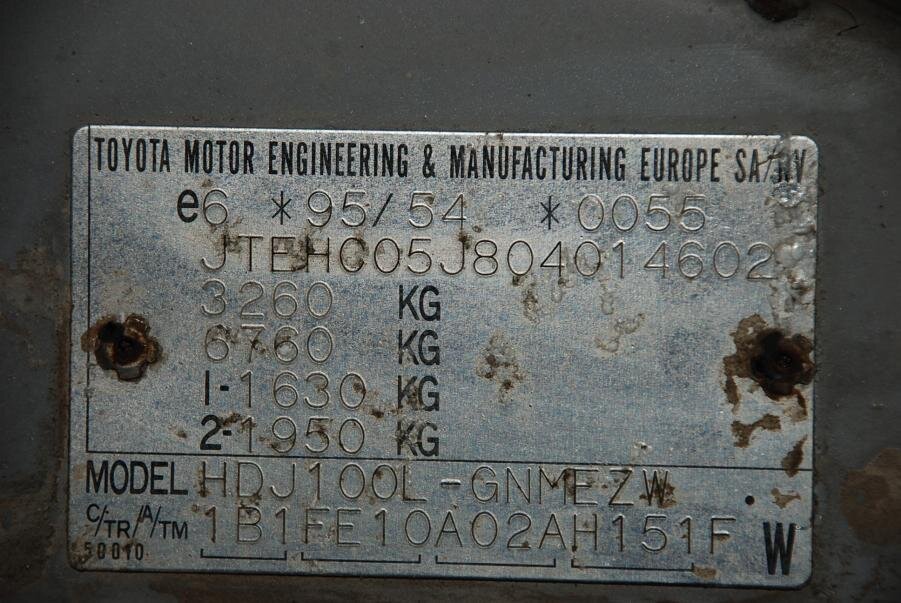

As an introduction we might see the VIN number and move on from there :icon-twisted: ...

It's this, then:
Market
Europe
Year
08/2002
Make
TOYOTA
Model
LAND CRUISER
Frame
HDJ100
Vehicle characteristics
GRADE:VX:VX TYPE
DESTINATION:EUR:EUROPE
DRIVER'S POSITION:LHD:LEFT-HAND DRIVE
ENGINE:1HDFTE:4200CC DIESEL TURBO
TRANSMISSION:MTM:MANUAL TRANSMISSION
GEAR SHIFT TYPE:5F:MTM, 5-SPEED FLOOR SHIFT
:lol:
you could just read the gearbox code on the VIN plate, bit of a give away :lol:

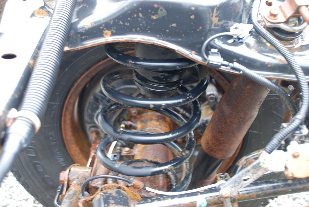

It was bought from a military auktion some 4 years ago. How long it has been a "convertible" I dont know. It has only 73.000 km and many parts look fine. Since it was a B6 armoured vehicle some parts are different -and it is kind of interesting looking around and find some things that look different from mine :icon-ugeek:...
The obvious are the suspension parts:
The coils are not 11mm but 16mm thick and the torsion bars are not 28mm but 32mm

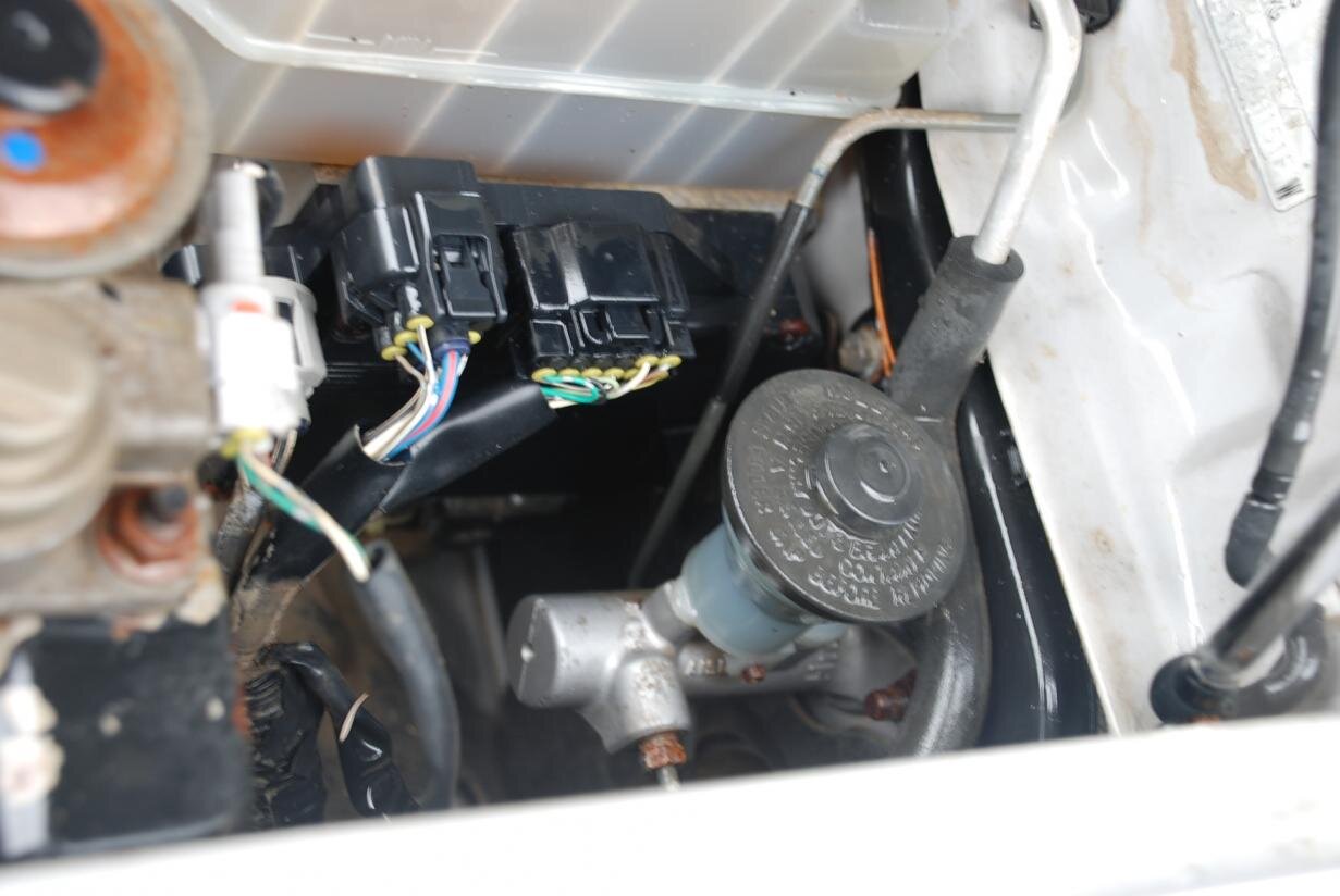

I found this "thing" -in the left side towards the torpedo. Looks like a minature brake cylinder....but!...what is it really ???

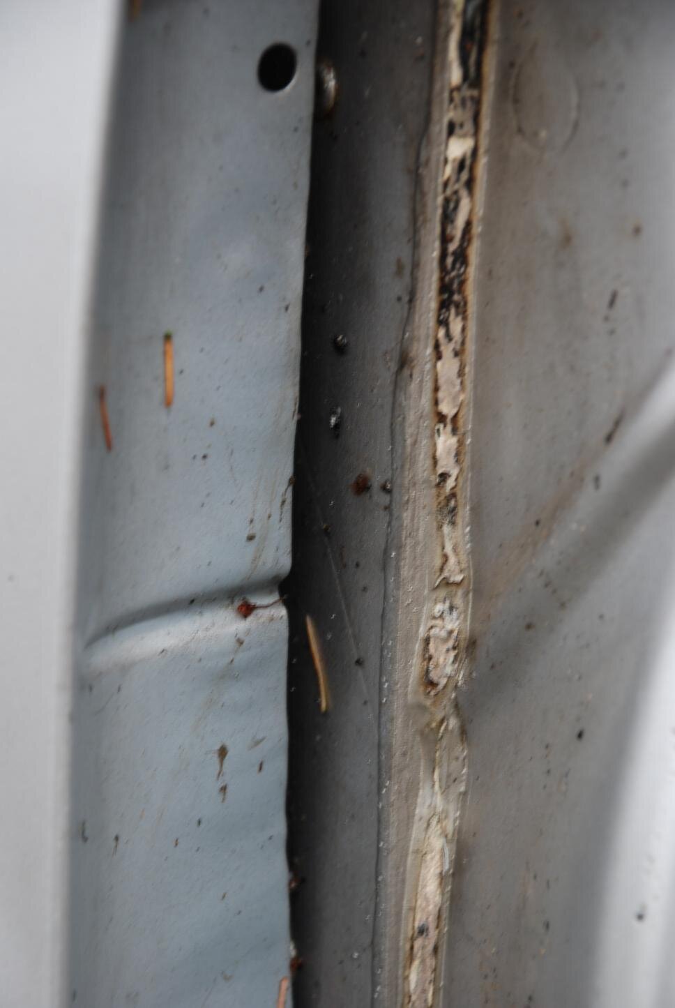

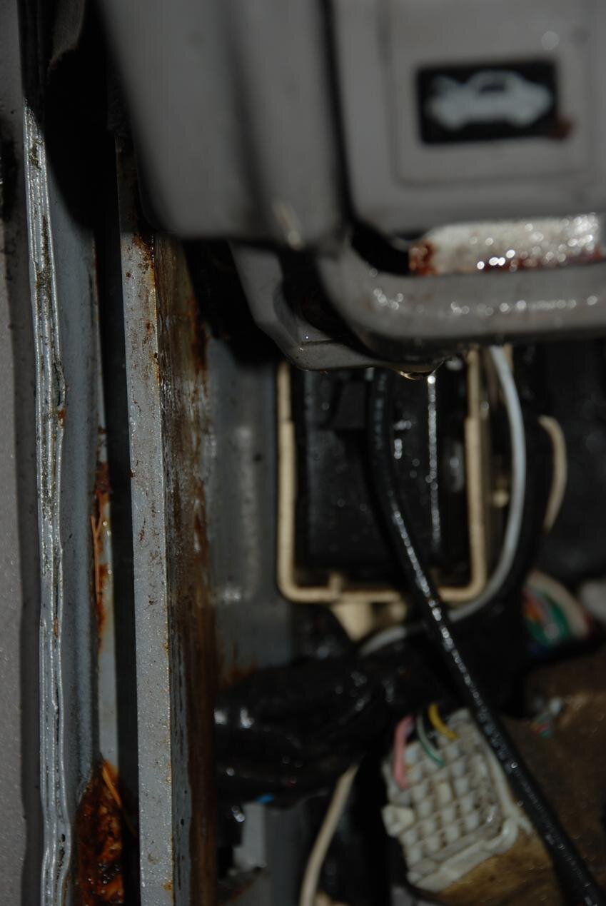

The front is armoured with 6mm "ballistic steel"...
this image is between inner and outer wing....
this image is the door sill....
:thumbup: Pictures are good now, but the picture of the 'thing' isn't showing :think:

Are you having a joke with us Lars? Looks like the clutch master cylinder :icon-wink:
ehm yeah Jon, I'm just pulling a joke :oops:.....kind of forgot about the manual box. Just focusing on what looks different from mine....hmm, jokes on me then!
