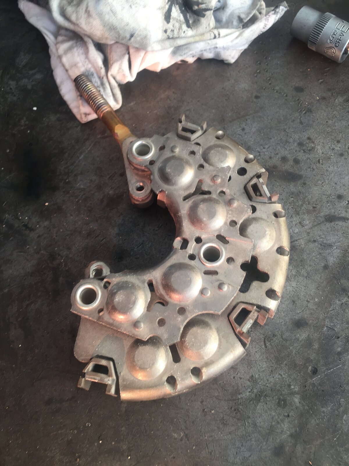

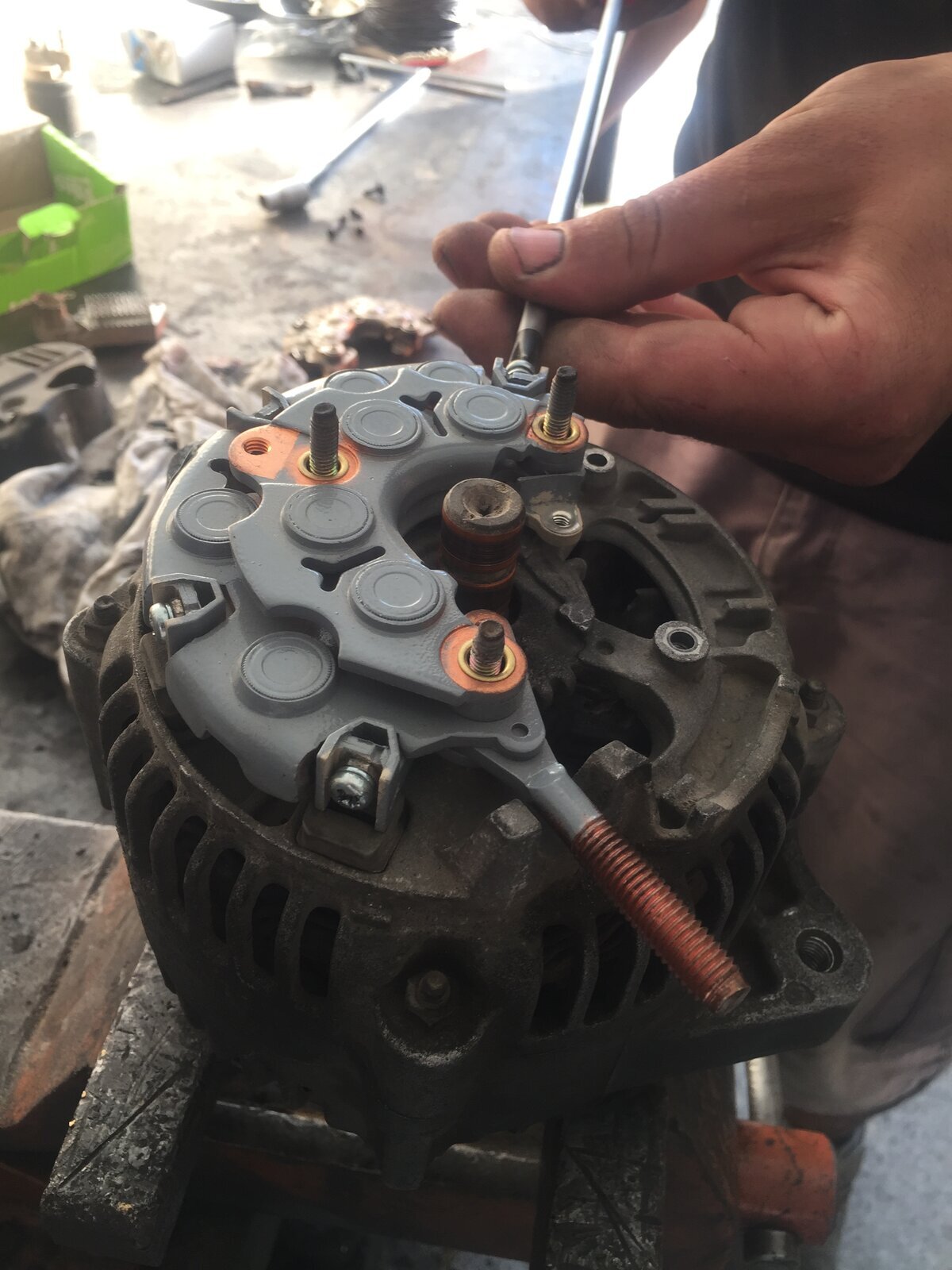

Guys today finally got round to getting the alternator out. It appeared to have a weak Diode set fitted last time. Perhaps not as good as was on the alternator from stock.
Is the new rectifier a Toyota part? They are almost the cost of a complete alternator. Sorry I might have misled you at the beginning due to my haste in replying. Should have known better as I work in electrical engineering
I doubt it TBH Mick, a generic one not sure of the make. Easier to repair here in Cyprus than ordering one from overseas. This setup is temporary now as if I’m in Cyprus for next season will probably be transitioning into a trailer / caravan set up with solar and taking out the fridge & accessories.
