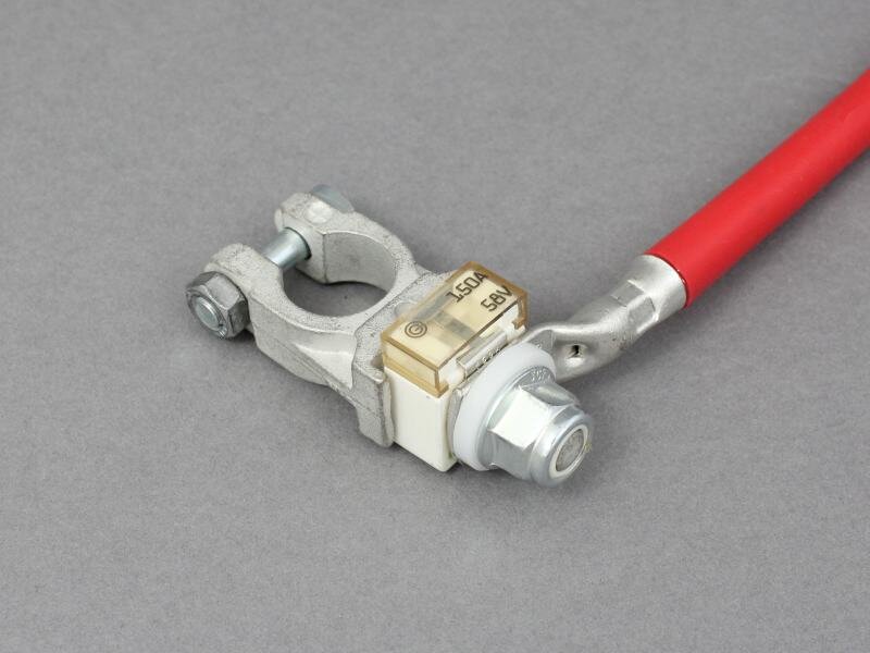

Why that? If you want to put a fuse on the battery link then use simple calculation. For every 1sq.mm. thickness of the cable add 5 amp. In other words if you put 20sq.mm. cable on the link use 100amp fuse....35sq.mm. cable 175amp. fuse.
