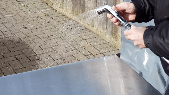

I finally have water!
Next week end we go out to test the new system!

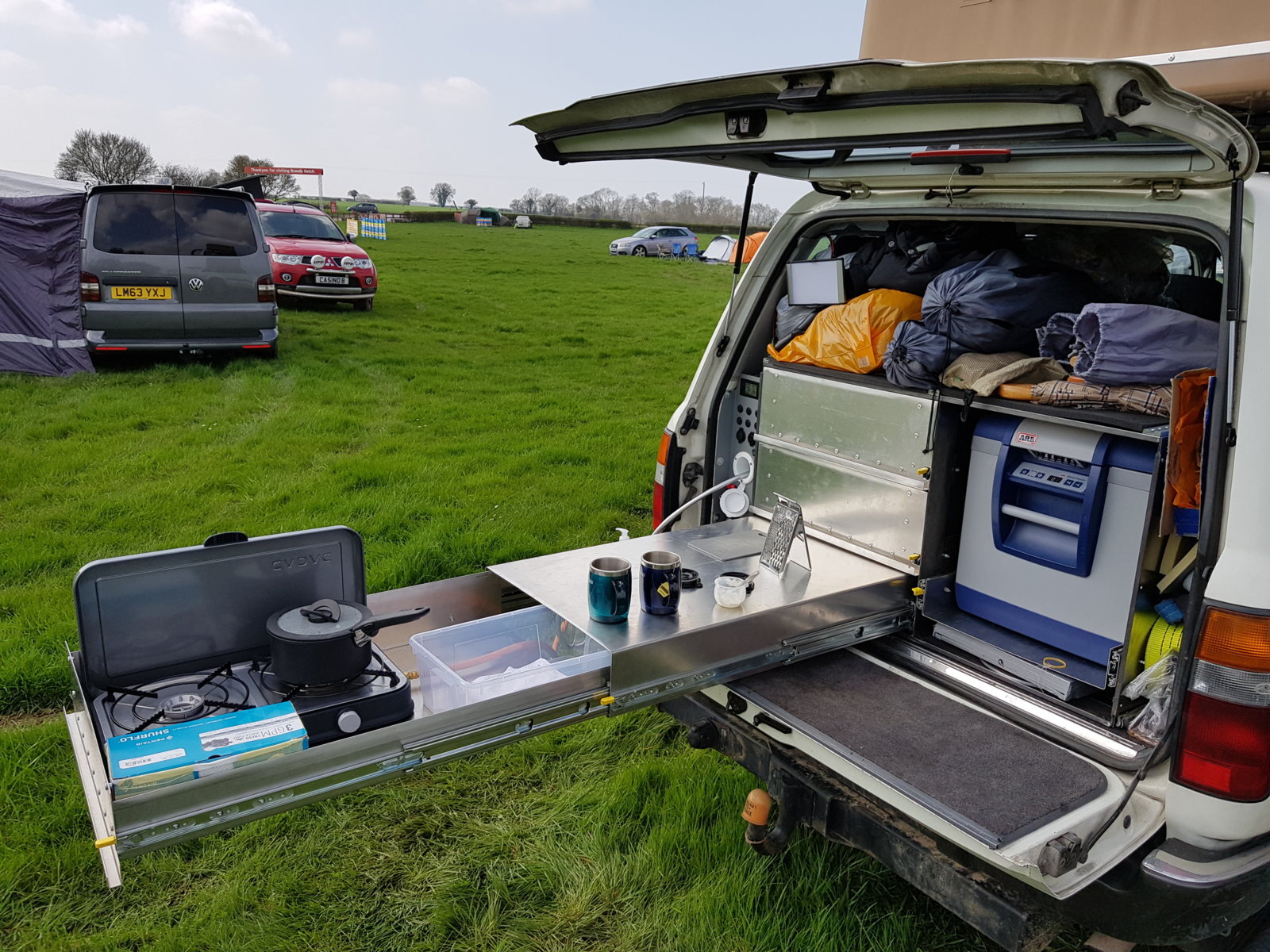

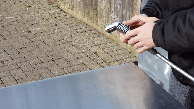

I like that a lot Marco. That’s an excellent idea with the shower hose. Usable as both a kitchen tap and a shower. And neatly stowed away. :clap:
Is the shower fitting and it’s stowage pod available off the shelf somewhere? :whistle:
I mean do you have a link to where the water outlet for the hose and spray came from Marco?

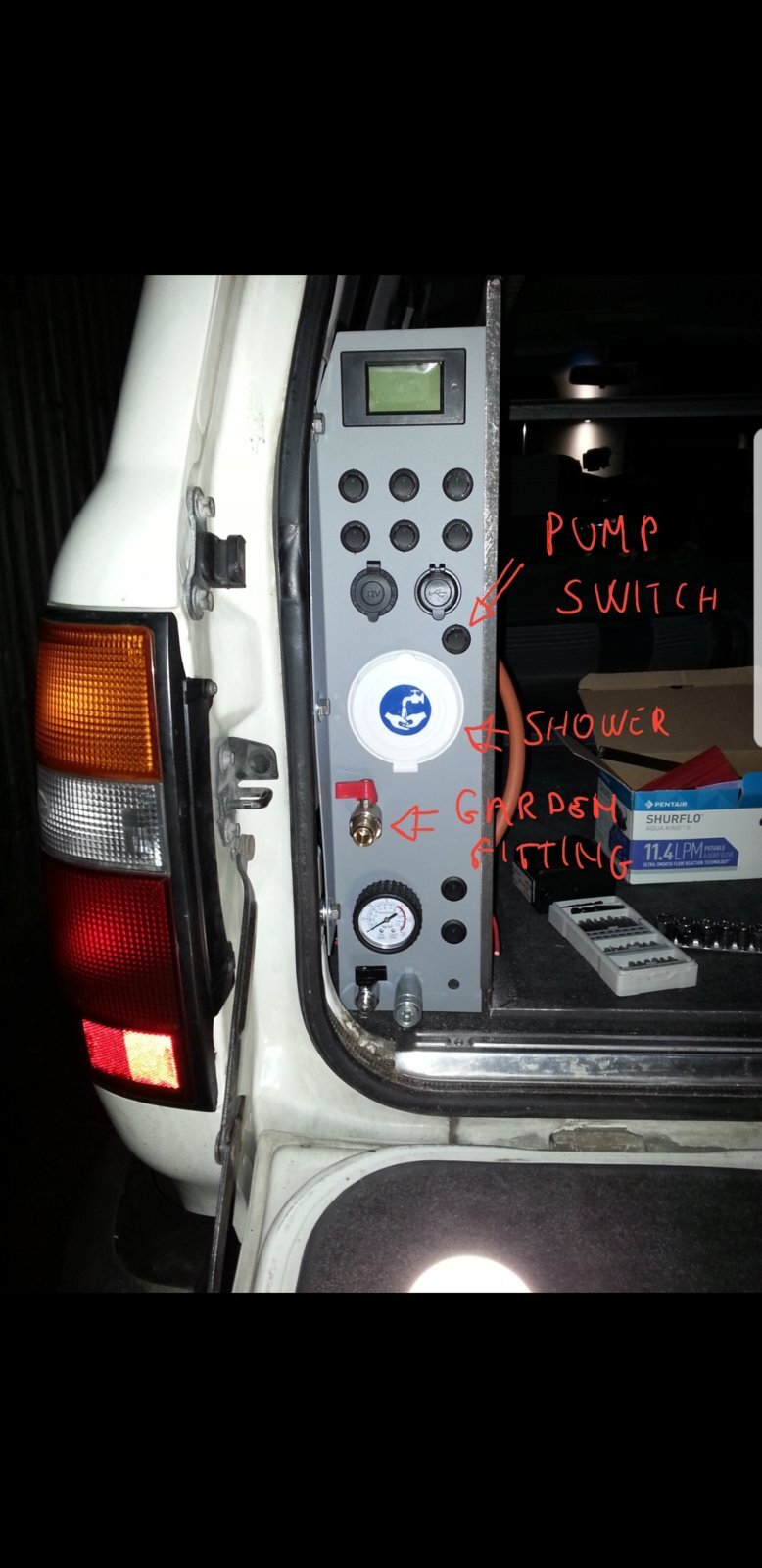

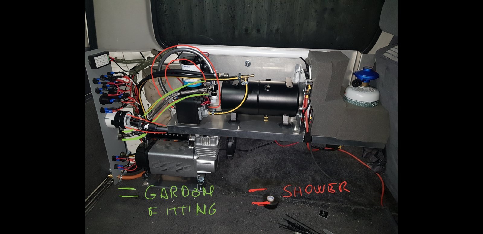

The shower is a fix installation, I fit also a standard garden fitting to be able to connect everything.
The shower pipe is running into a dedicated space.
I attach same pictures... consider that, I'm going to install a junction between the shower holder and the pipe stowerage pod

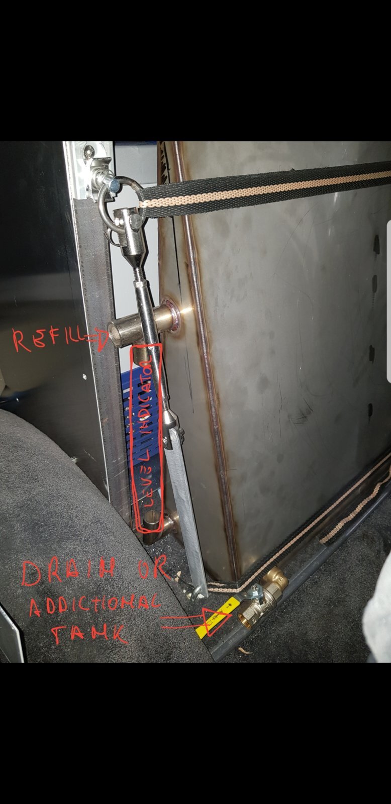

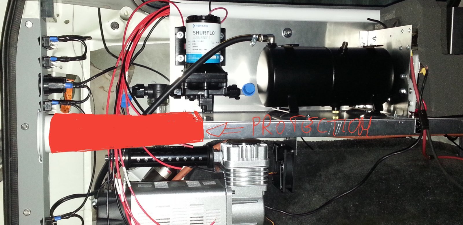

I fitted two ball valves, one hitch side of the water tank.
The left one is connected to the pump, the right one is used to drain the tank or connect an auxiliary tank.
Ah... between the pipe and the shower I fitted a regulator in order to choose the quantity of water I wanna have to the shower.
(To avoid to use too much water if I don't need it.
Thanks Marco. Where did you get this bit?
Thanks Marco. It takes time finding these things. :thumbup:
That’s pretty good Marco. Same quality as my Kenwood one. Nice and neat too. Almost wish I’d gone for that setup but too late now.

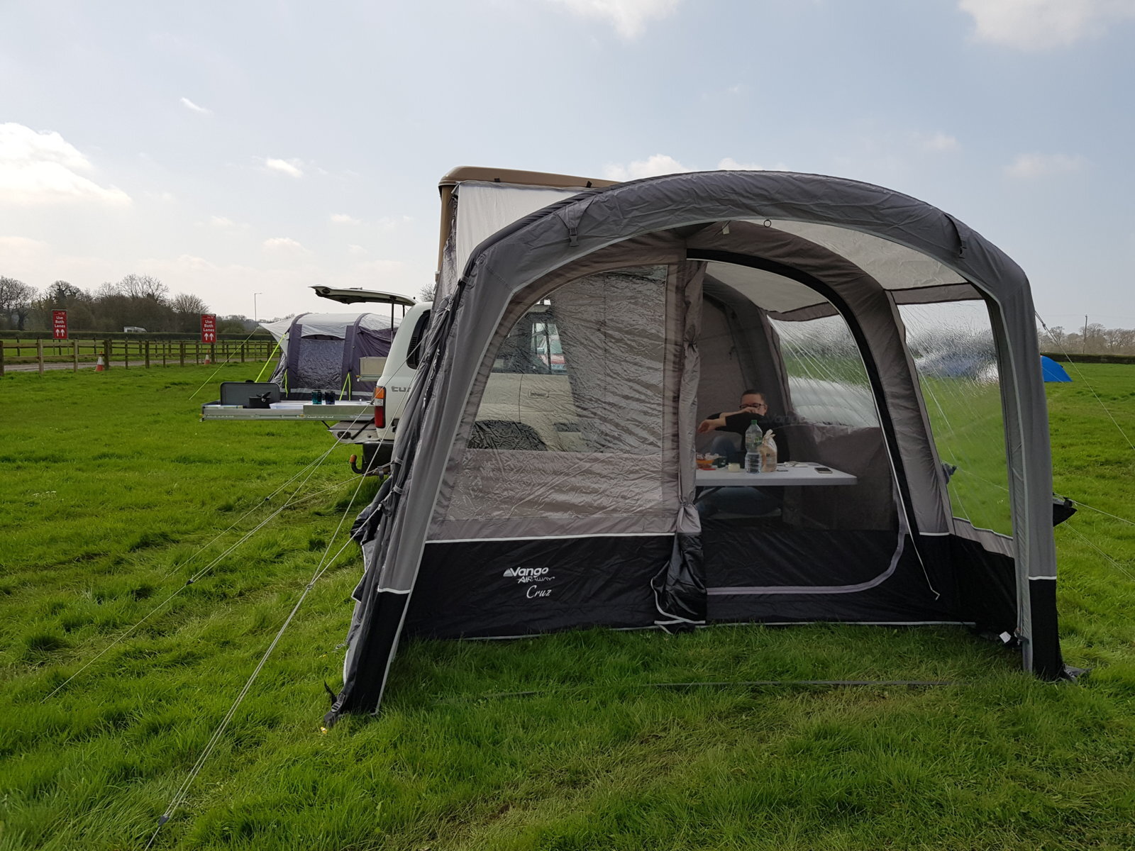

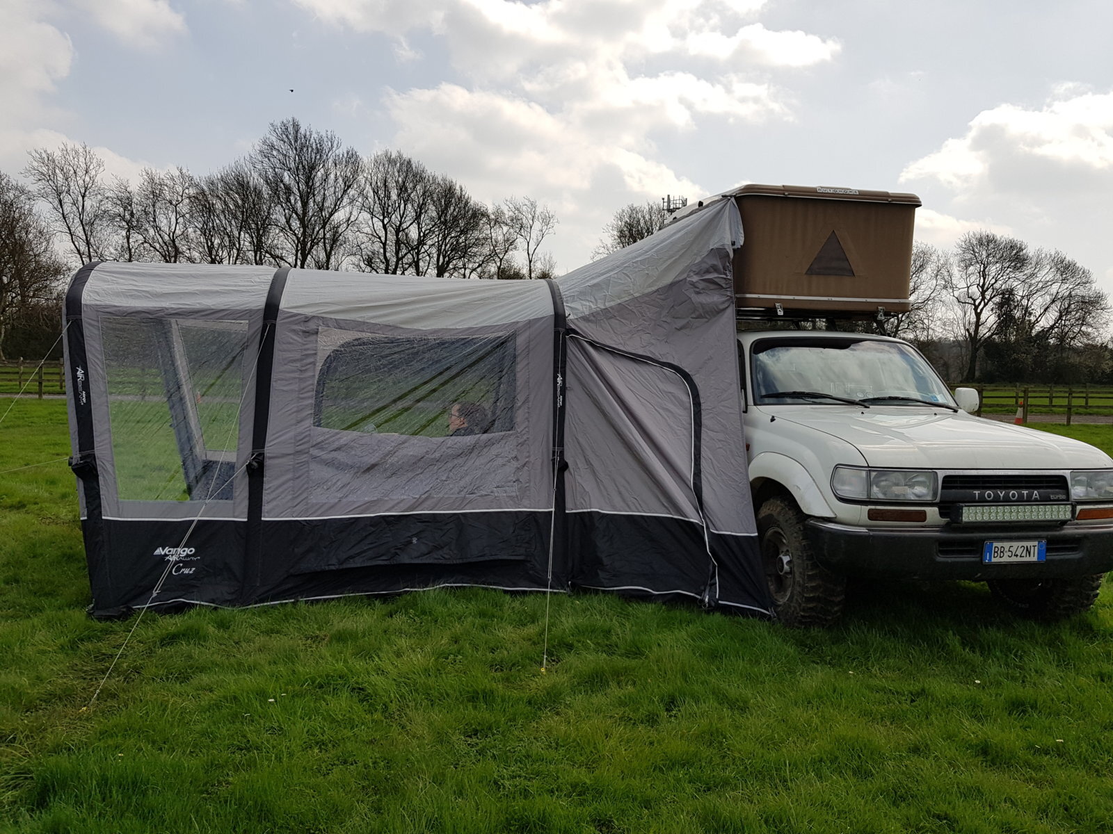

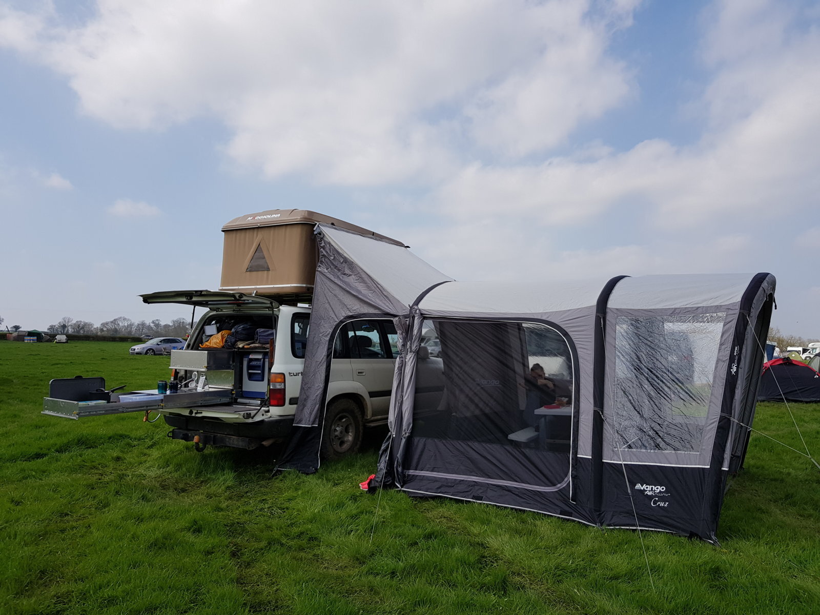

That’s looking like an excellent setup Marco. I like what you’ve done with the drive away awning. Means you can leave most of your kit, go out for a day then come back to it in the evening. :clap:
