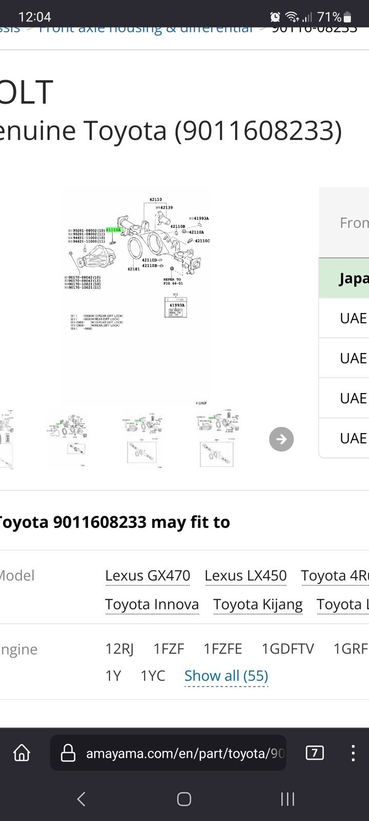

Yeah I wanna try replace all of them but not sure where I can find that specific stud. I did use a torque wrench but I think I followed the wrong torque spec online somewhere. I’ll have a look at roughtrax though. Thankyou very much
Feel free to check my working out
Feel free to check my working outView attachment 334632
Thankyou, had a look for the 41110A Toyota part, didn’t seem to get anything. When I searched up the 9011608233 I found the rear stud, not sure if they’re the same or not but I’ll check to see. Thanks for the help, appreciate it.
I checked, but the rear diff stud is larger than the front. So still no luck there, thanks anyway though.
