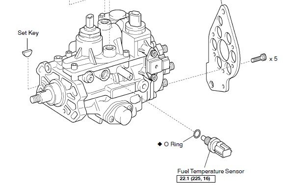

It would help if you also gave us more info one the model you drive is it petrol or Diesel, what year etc.
You should be able to find what you need and where on ToyoDiy.com or in the FSM which you can download above in the service tab.
Resistance around 2 Kohm around 20 deg celsius. Resistance goes up at lower temps, and down to under 1 k at higher temps. Around 300 ohms at 100 deg C.
(Handbook says to check it the same way as the water temp sensor.)
