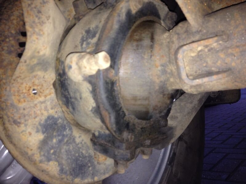

Here you go is this bad or fair? I hope its fair as I'm leaving for Morocco on Sun.

That's a pretty good looking swivel really. No oil running down it which means that your inner seals are probably ok. Even if it had been leaking and the diff was now dry, you'd see the mess it made. Should be a decent one to work on.
You know the swivl end, knuckle, cannon ball isn't actually a bearing part? It only needs to be smoothish so that the felt seals sit nicely and keep the crap out. It's nice when they are polished and shiny but it's not essential.

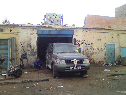

That's me (TheWarden on the HuBB) getting my axle repaired in Boudjour 2011 after the rear upper link bar mount sheared n the WS. 2 teenagers and the town welder fabbed a new mount from scratch fed me breakfast and lunch getting me back on the road in about 5 hours.
I've since had that mount replaced and all the other strengthen by a local engineers for £300 and the diff rebuilt with ear bearing and 2nd ring gear and pinion for £350 Only thing I haven't done are the bearings
