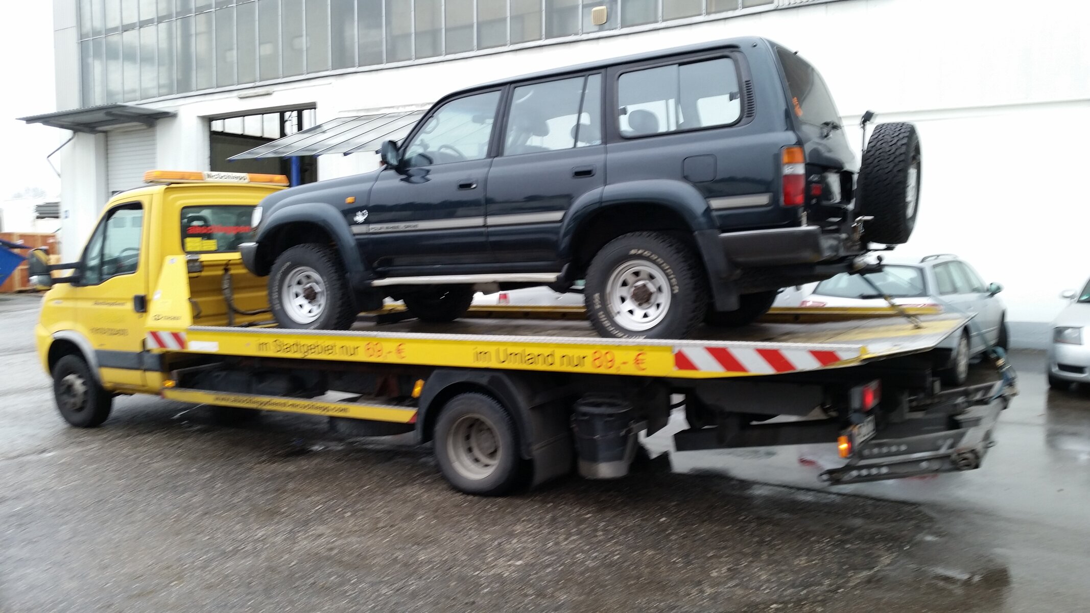

Yesterday driving through Munich traffic, I heard a noise as if I had driven over 2 sheets of metal... except the noise came from the gear box... Kept driving a bit as no more noise and, no other signs.. then a few mnute slater a more wizzing like noise starts.
Quickly I decide to pull over and stop.
The car basically had no more power and makes strange noises when in R,D,2 or 1. It also will not hold its own on a small slope on P.
The car is now on it's way on a flat bed to Hungary and I hitched a lift to Hungary last night on one of my mates trucks.

the tow truck operator could do with a lession in strapping the cruiser down.
You should near strap a vehicle down from the body like that always on the axle so the suspention can move, did he use the winch on the front aswell?

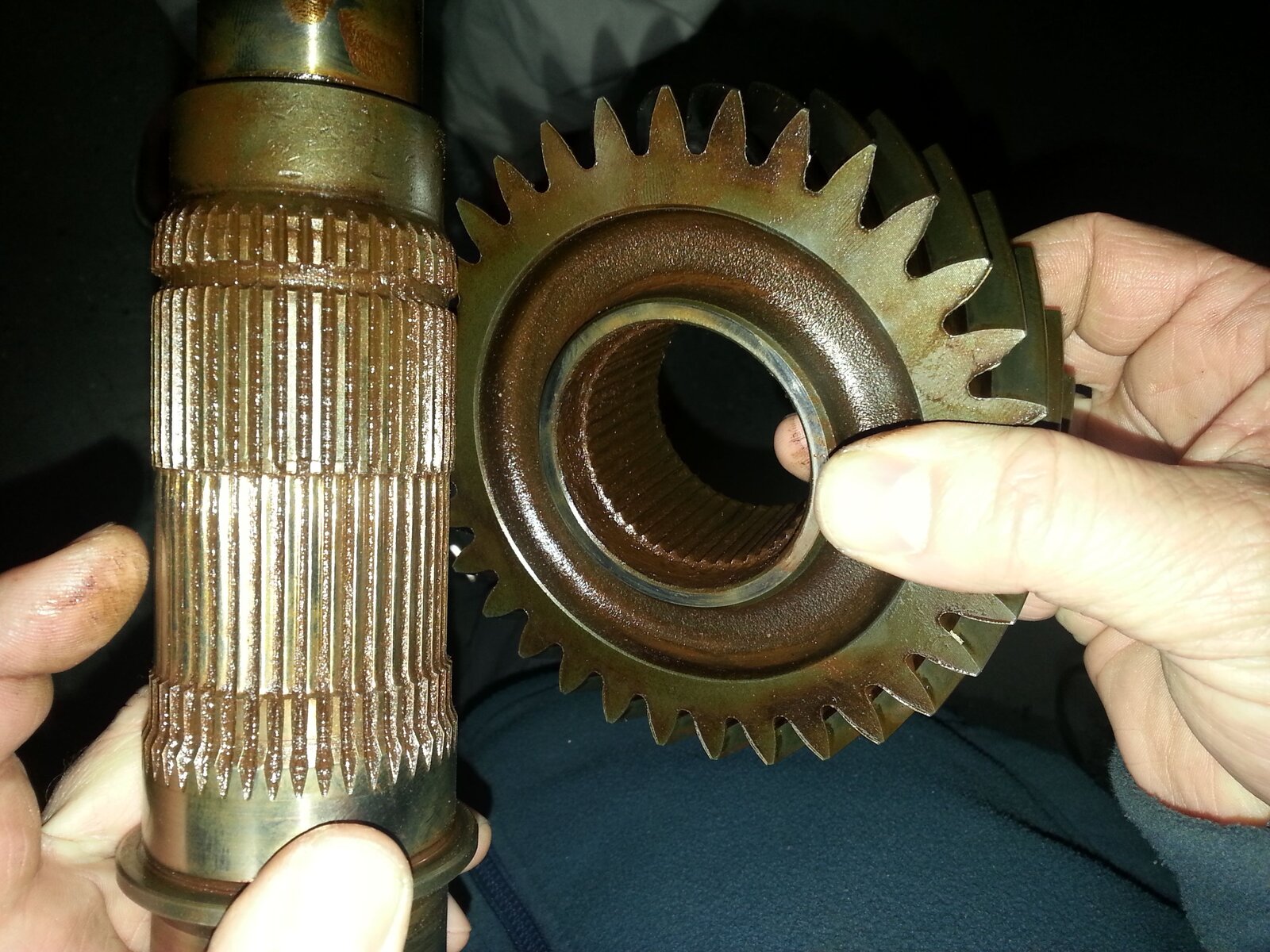

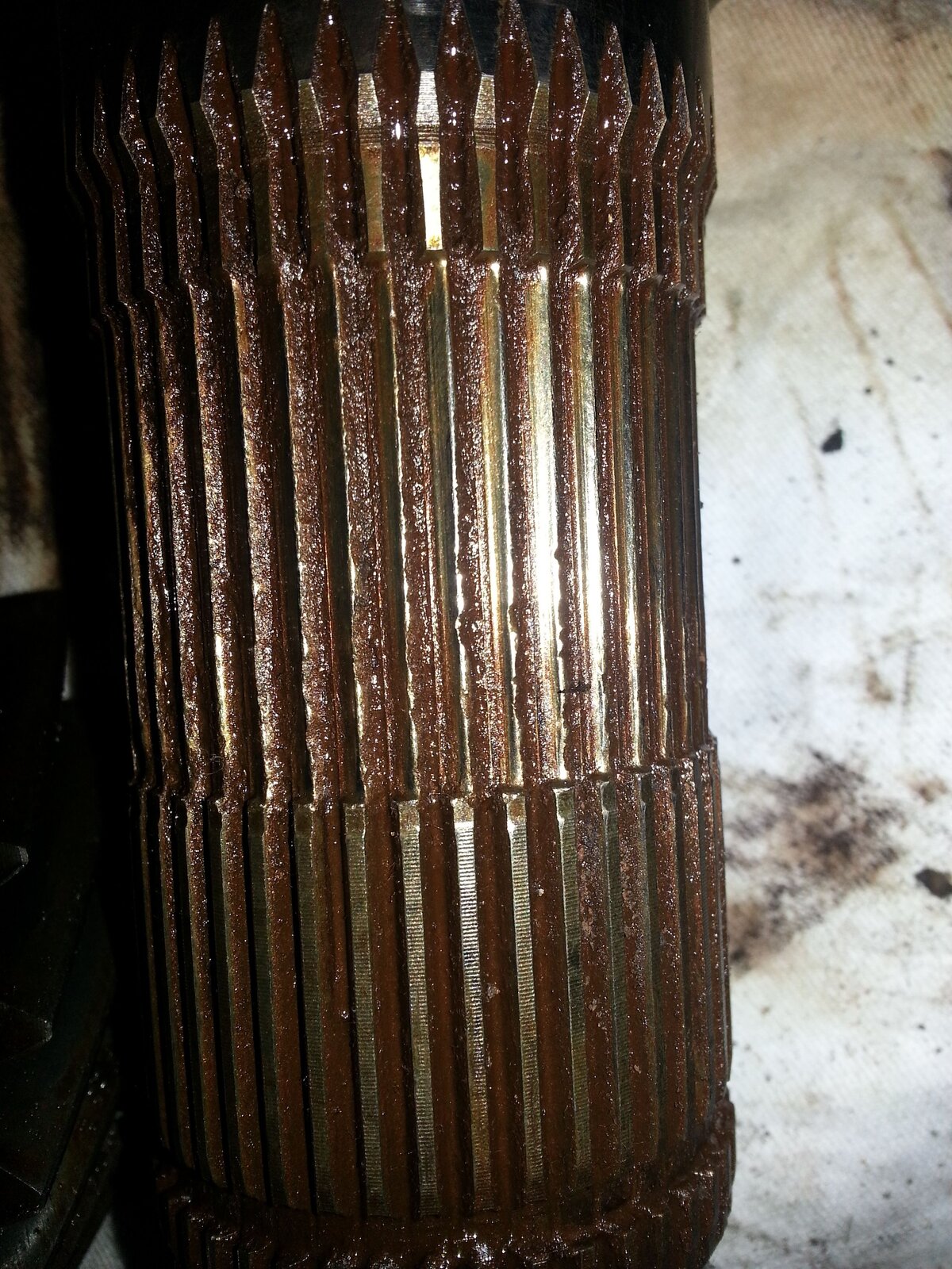

Here are 2 pictures of the parts that they have change....20150108_110532.jpg 20150108_110607.jpg cost including labour approx. 900 euro!
Any idea what it is?
Anything else I should look out for...
Worn out, that's what I would say it is :wtf:
But I'm surprised it's so worn, maybe ATF failure due to overheating... ? I'm no expert, but I'm sure you'll get some educated responses soon.
So they have found the issue , unfortunately my man who can translate the from Hungarian to English is on the Dakar managing the Hungarian Land Cruisers on the race....
Here are 2 pictures of the parts that they have change....View attachment 17042 View attachment 17043 cost including labour approx. 900 euro!
Transfer box shaft and gear that is, nothing to do with Autobox. Looks like its been low on oil or suffered oil pump failure. Seen it before in heavily loaded worked trucks. First they get real noisy under load (chattering almost) then they strip the splines like yours.
Transfer box shaft and gear that is, nothing to do with Autobox. Looks like its been low on oil or suffered oil pump failure....
I wrongly thought the transfer box would be splash fed, I didn't realise there was a pump in there too.
Is that rust? Looks like water has got in. Rust is very abrasive and would wear through splines unless the gearwheel is pressed on which I don't think they are. Transfer oil should be changed every 36k miles.
Yes there is a pump and it's driven from a sort of small key that sits between the T box and the A box or G box on a manual. Could be that the two were split at some point in the past and that key not put back in. It's pretty small and very easy to miss.
