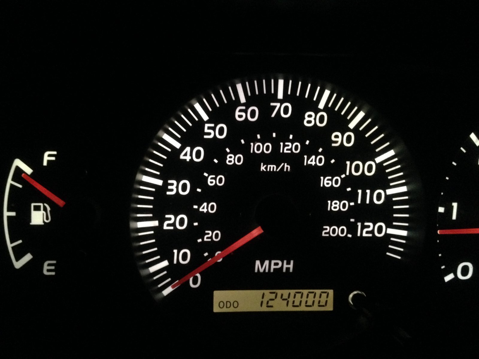

124 today.
With only 122k on the clock when I got it I thought I'd won the lottery, it's not been plain sailing since!
