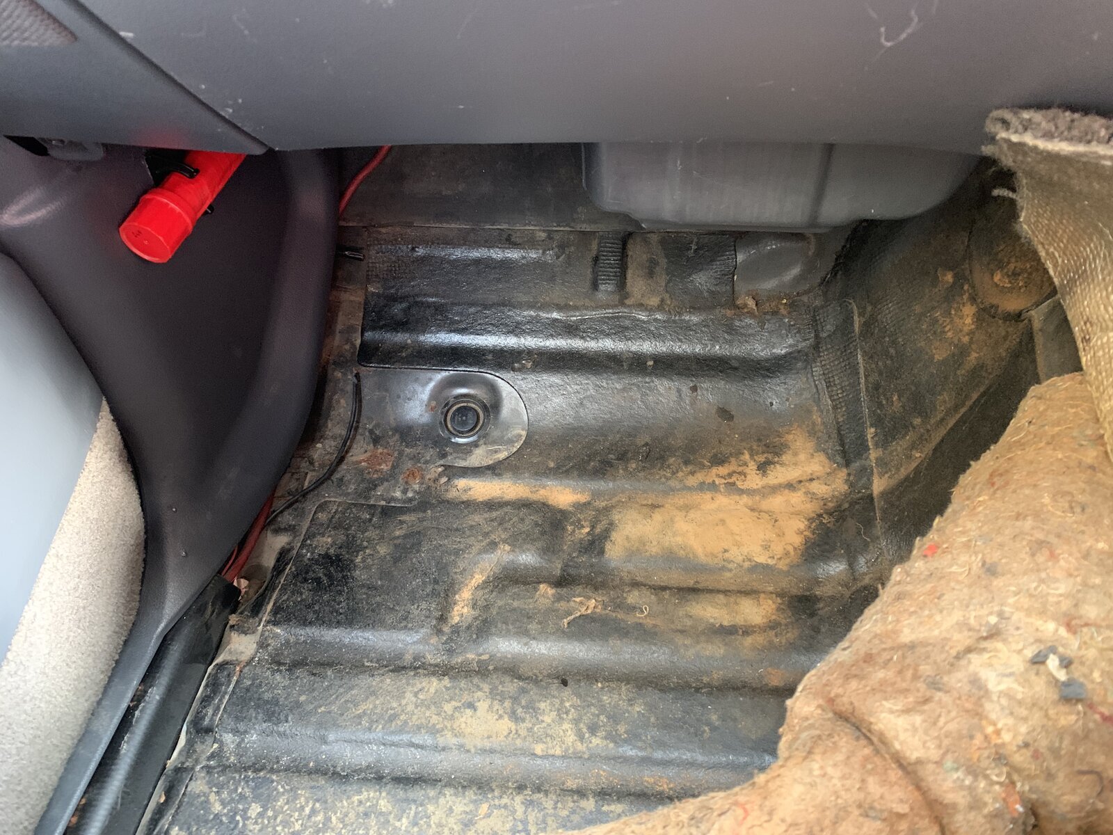

Did find the left passenger carpet wet but unsure if it’s rain getting in somehow or the heater matrix issue I replaced some years back. Driving it with the blower heat on (no real heat) didn’t see any water running down as far today in the passenger well and no signs of red coolent now so I’m hoping that’s not the issue because that’s a real pain in the ass job lol

Checking the passenger side under the floor carpet revealed water only on the seat/door side and not the inner tunnel/bulkhead side. That needs further investigation.
Yeah, that was my first go to seeing water where there shouldn't be in the footwell Andy.
Would you not smell the damp area? Anti freeze coolent has a nose. Are you finding the coolant needs topping up?

Just seen this after heavy rain. Upon review it’s clean water. Not sure where its coming from?

Update after another night of rain for some reason no more water came in and all dried up.

A quick taste of fluid will reveal what it is. Water; No taste, Coolant Sweet, Brake Fluid, Bitter, Oil No taste but obviously oil when added to a little water. Doing so will encourage plenty of saliva for spitting out.
I have never had the problem so can't be of much help but i'm sure there are many threads relating to blocked drains . A separate issue that cleared itself maybe .
Tasted it as being water the other day and was thanking my lucky stars it not being the heater matrix Frank. Thanks
Shayne checked today again the sunroof / front windscreen pillars and all were dry after days and days of rain this last week. I thought the outside front windscreen gully may be the cause and was gonna blow compressed air to help unlodge anything blocking the drainage but now the water disapeared. The investigation continues lol
