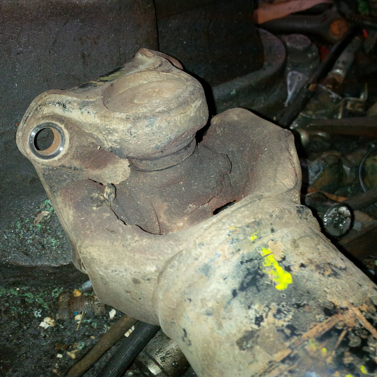

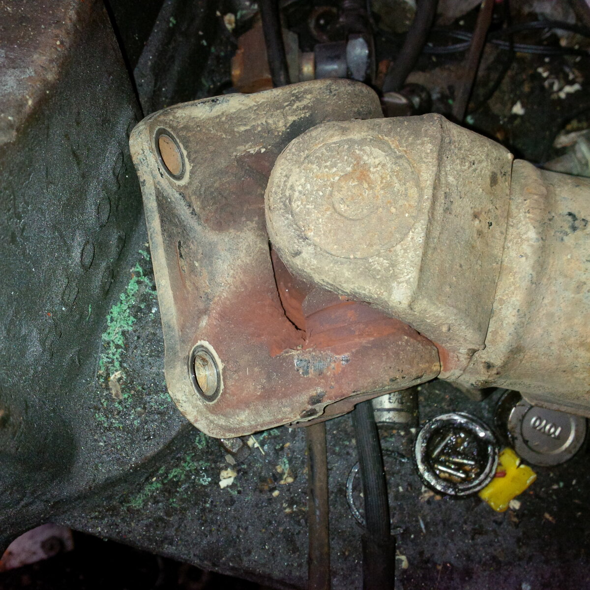

Thanks for the tips, after going home from work last night the truck did start squeaking when you pull away so I pulled the rear prop off and did indeed find the rear uj had been seized and was now well worn. IMG_00000026.jpgIMG_00000027.jpg
You can see the rust in the second photo.
I guess when I checked underneath last week I had a brain fart and thought all would be well with no slack in them.
I have ordered all new uj`s and will triple check the circlips are in good and tight then all should be well.
I haven't measured the backlash yet but is it correct to have more play in the front diff than the rear?
Andy I did wonder if was the dodgy goods I was buying but the ride is too good now:dance:.
Frank 4500 miles you say maybe I had one too many zero`s and thought they needed doing every 45000. :oops:
Once again thanks for the tips guys. I will check the backlash tonight and see what we have there considering the truck is up at 318000 miles now.
Cheers, Mark

The problem is the care with which they are greased rather than the interval. The first few pumps force grease past the seals and you think ah that UJ's done. But probably there is one of the 4 joints on the spider where the grease has not come through. With mine I keep pumping until the stubborn one is passing grease. These stubborn ones are the ones which eventually go dry and look like a red egg timer when you take them apart.
