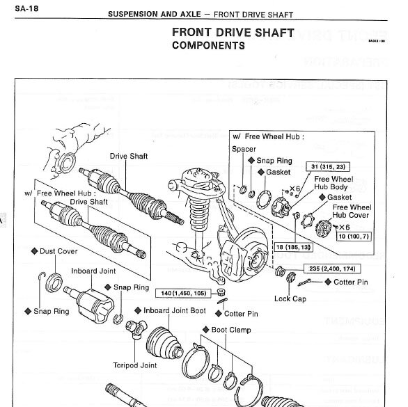

Am out side working under flood light finishing off for the day and need to know how tight to do up my hub nuts. Tight as I can without breaking them or special talk setting then backed of a bit?
