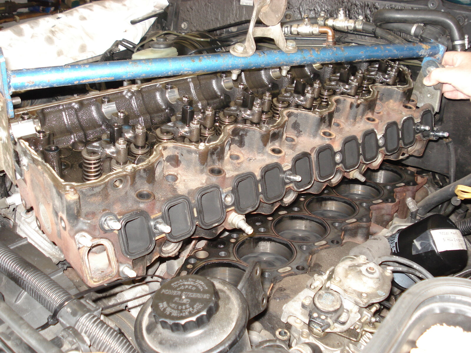

I normally sit in the engine bay and hurt my back lol.

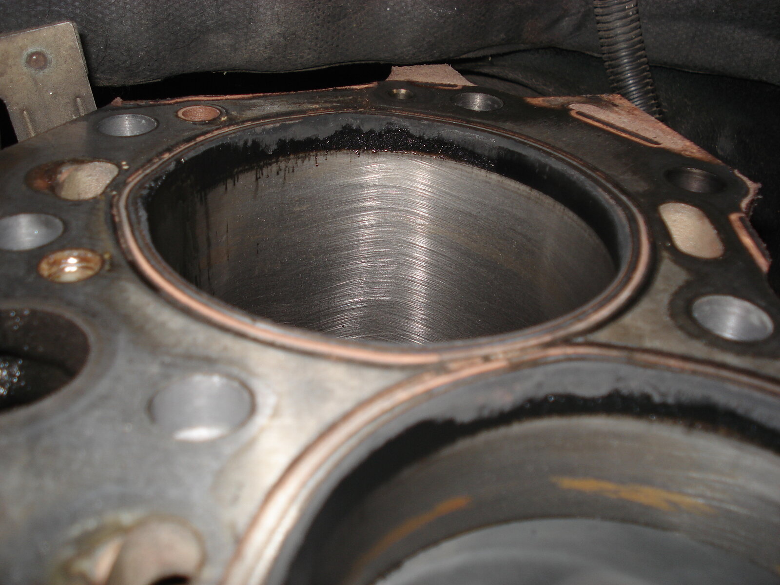

How many miles do these engines do? I can see the original honing marks on the bores. There is no ridge where the top ring comes up to .
I recall reading the block has a higher nickel content making it very hard wearing. The 4.2 lc engine I read about was iirc around 250000 miles and looked like yours internally. Might be wrong but weren't they designed for 1 million km or similar with some rebuilds on the way to that.
