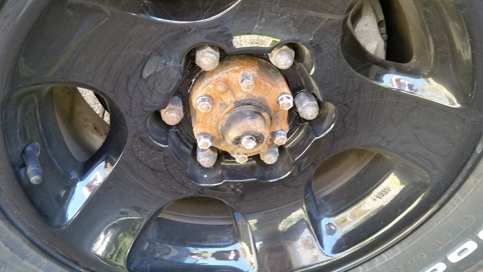

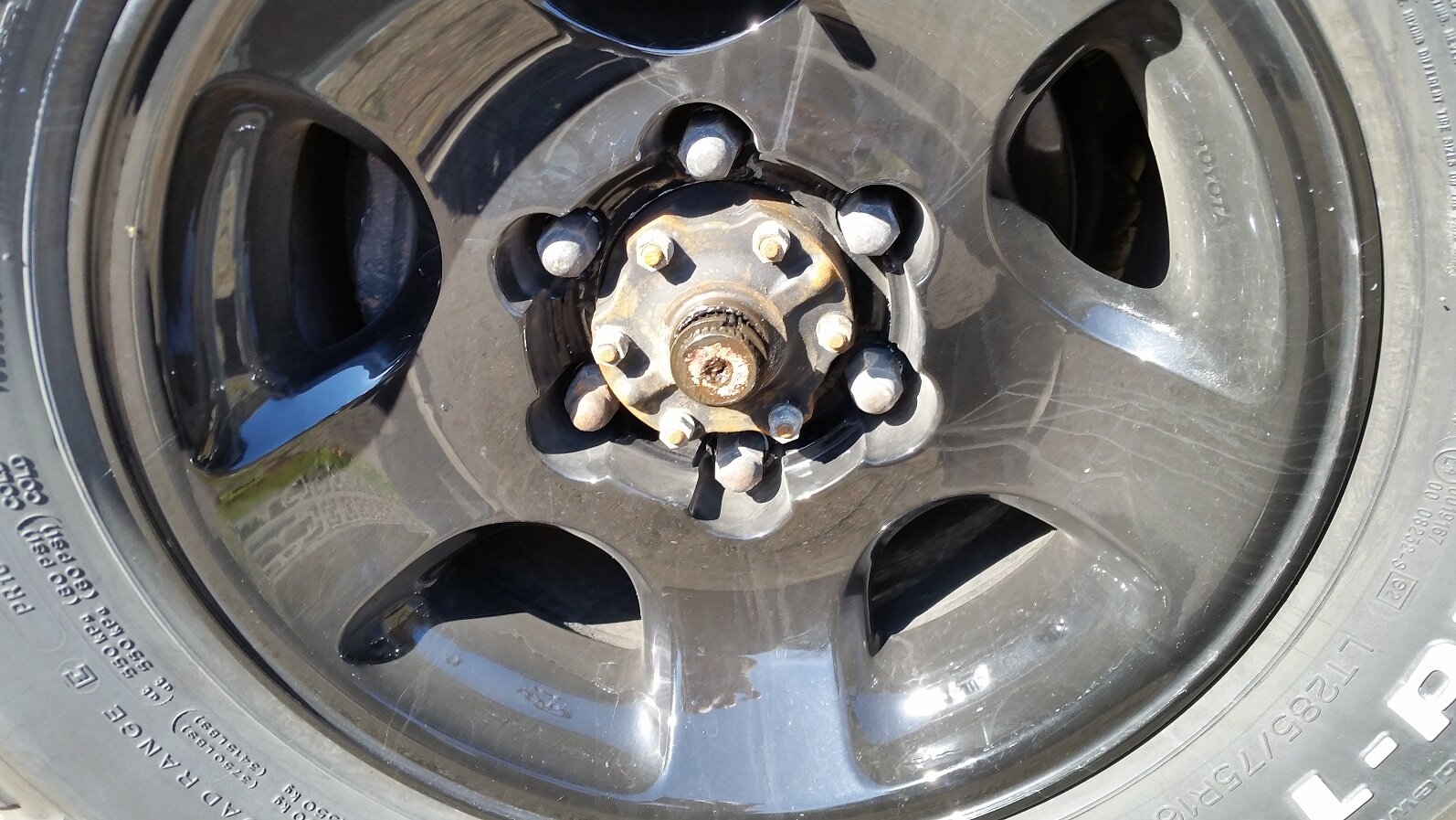

Just arrived in Scotland from Switzerland on way to Lincomb tomorrow and noticed that my plastic wheel cover and also the metal cover for the axle is missing...
Not sure how they could have both come off...
Do you think if I put the plastic cover on I can get down to Lincomb and then home to Switzerland, is their anyway I can they parts to the meet...

As long as you aren't wading in filth water they'll be fine. Odd though. They take some pulling off normally. Wonder if they have been nicked. You wouldn't get pressure in there that could blow them off.

Something looks wrong in those pictures; I'm pretty sure there shouldn't be a bolt through the metal cap (and presumably into the cv). I've no idea what the clearance is inside the plastic cap, but perhaps the thickness of that bolt head was enough to push the plastic cap off when the cv moved through the splines a bit?
The first picture looks like maybe there's a combination of the newer long spline cv joints with the old shorter spline flanges.
You can probably make it to Lincomb (even back to Switzerland), but I think you'll have new cv joints and flanges in your future!

ON the top pic it you are missing the metal cap.
I would stay out of the mud and water if it was me until that was resolved.
with Toby about the presence of the bolt.
Was on the phone earlier and couldn't see the photos very well.
Toby is right. The truck has the long cv in it. That means that it will move and push the metal cap off. Someone's drilled a hole in the cap and bolted it to the cv so it stays in place. Sort of anyway lol
I would say the bolt came undone, the cap then came lose and rattled around inside the wheel cap until it went astray.
As others have said above safe to drive on the road but stay out of dirty water if off road.

Just to be clear, the photos are of each wheel as is for the moment ie. 1 missing and one not. So can we fit just deeper covers on each side?

We did a cv refurb on the side now with missing cap and a bolt was not fitted and a new original cover. ( just spoke to the garage.)
mussy
Just needs the bigger flanges. New cap and job done. 15min job :thumbup:
Yes Cive! Drove down to Lincomb and the next morning Karl was there with the correct bits and bobs and together with Richsims all was done in 20 mins....
