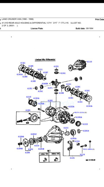

If you own a Japanese import, HDJ81 you may be interested to know that ALL Japanese 80's came with a different diff ratio to the Euro model.
Euro model manual 3.7
Japanese model manual 4.1
This is the same ratio as the UK Automatics.
Your build plate will confirm which ratio your vehicle left the factory with.
