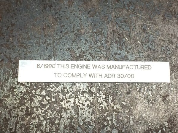

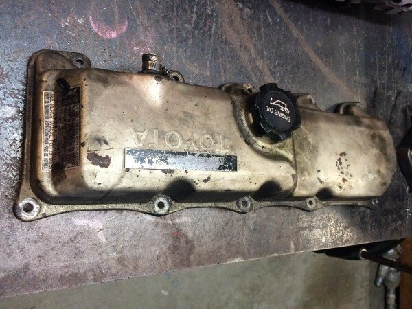

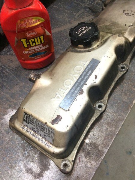

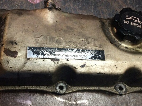

I was keen to salvage the compliance plate from the rocker cover of the blown engine that had been painted black.
T cut worked well.
That can be stuck onto the top of the new engine.

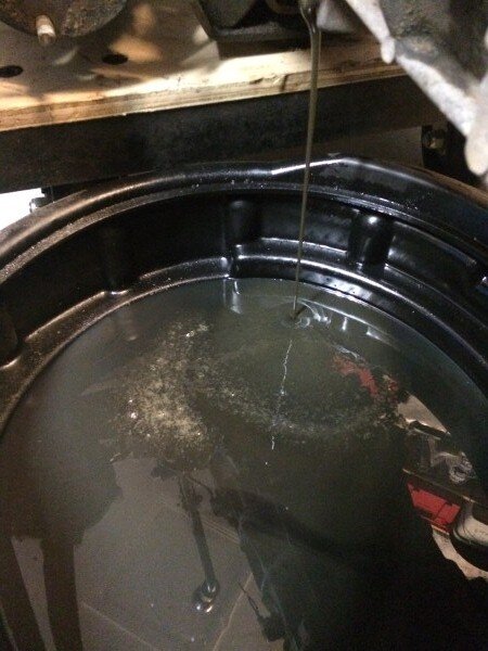

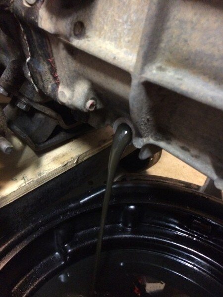

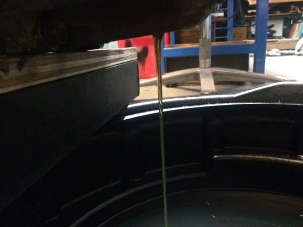

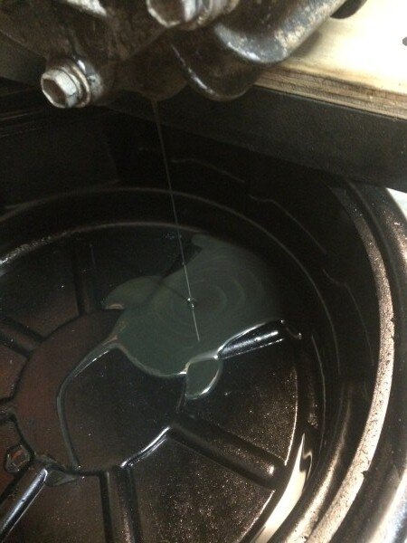

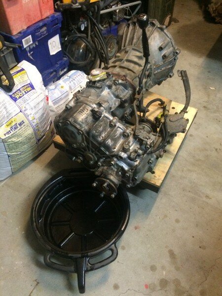

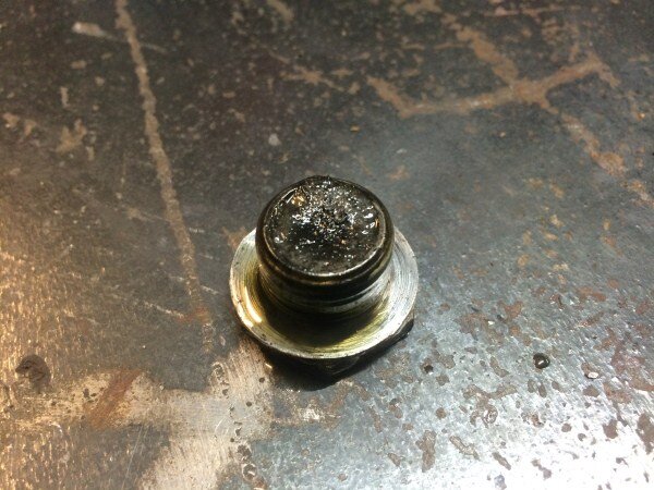

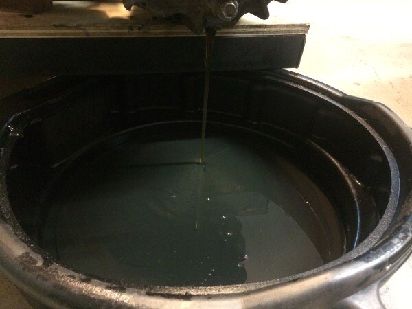

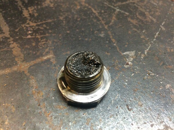

I wanted to drain the oil out of the transfercase that I bought cheap. The previous owner had told me that he had driven the truck with no oil in the T-case.
At first only a tiny bit came out.
But it kept coming out until a good few litres was in the drain pan. The oil looked pretty good and didnt smell burnt at all.
The magnet on the drain plug had picked up a bit of swarf but not a huge amount.
So I'm now thinking the transfercase might be good after all. :think:

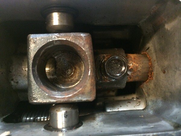

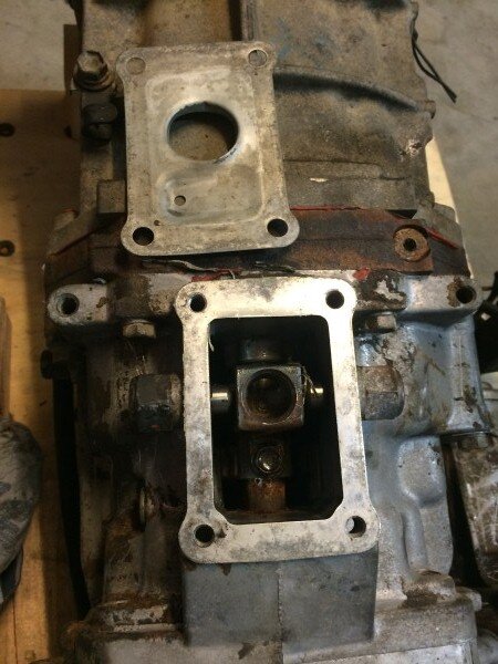

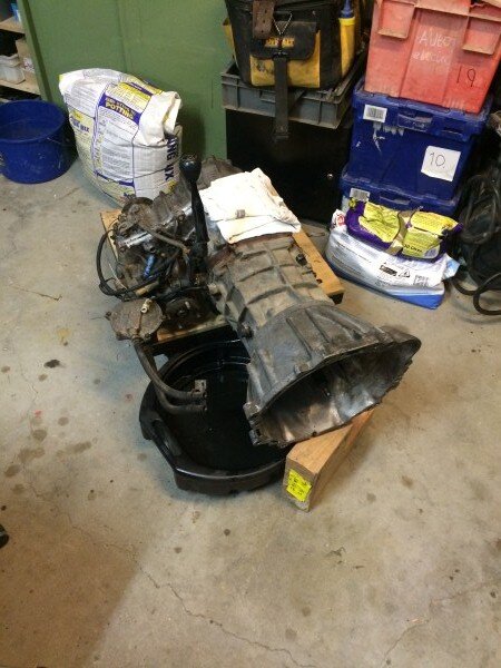

I took the top off the G-box where the stick normally goes.
A little bit of rust in there but not too bad really.
Lexi kept me company.

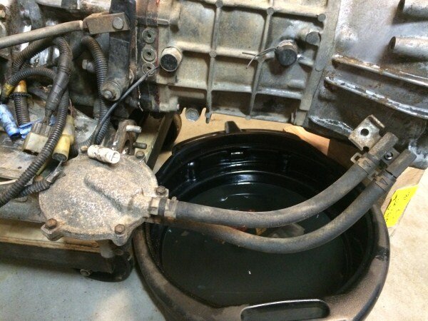

I re-positioned the G/T-box so I could drain the rest of the G-box oil (a few litres had leaked out while I was bringing it home).
Most of it looked pretty clean but there was about half a litre of water at the bottom with the oil above it.
I'm very tempted to fill the boxes up with fresh oil and fit it to LJ so I can test them to make sure they work ok. :think:

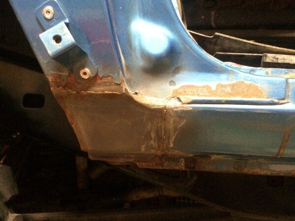

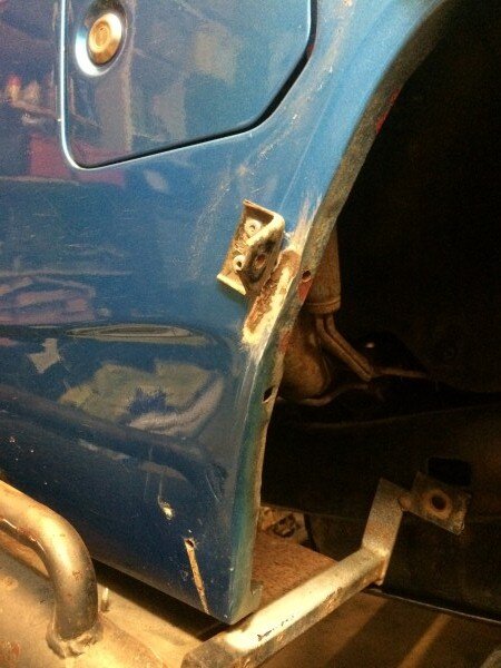

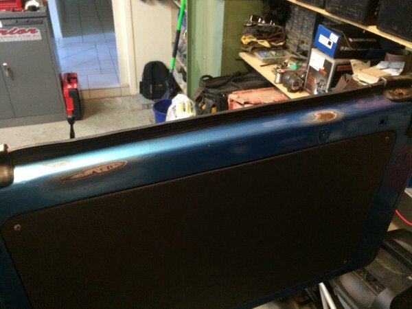

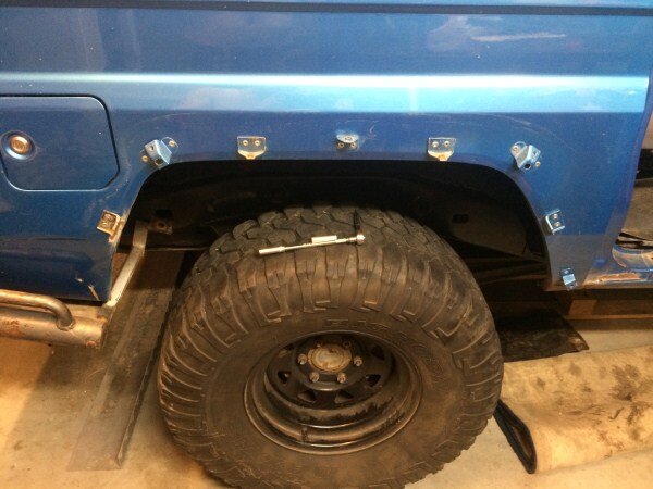

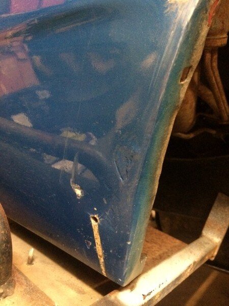

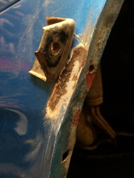

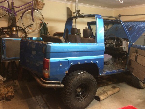

I did a bit of work on the body.
Removed one of the arches.
To inspect and treat any rust.
A little bit here.
And some filler in this bottom section of body work, which I knew was there as that was the only place on the body my magnet wouldnt stick to when I inspected the car before buying it.
There is a section on the drivers sill that has been repaired and needs painting.

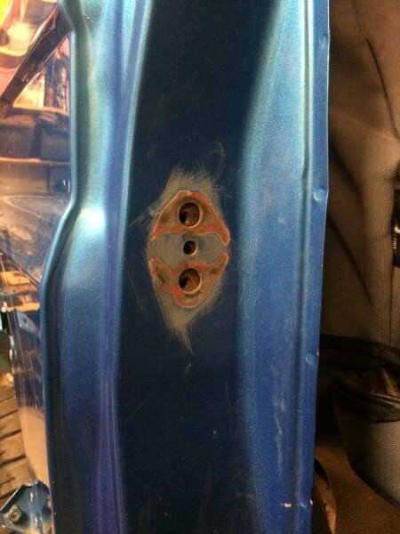

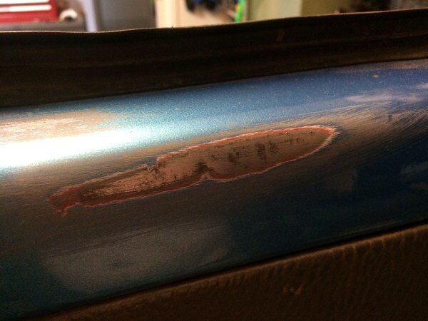

Sanded the surface rust off the area on the B pillar where the bit the lock engages with bolts on.
And a few spots on the back doors.
I rust killed all of those and I want to source some touch up paint in the same shade of blue so I can make it look good again.
In a few years time, before the body goes on LJ I want to get it stripped and re-sprayed. Until then I want to preserve it and have it looking OK for road use and light off road use. :cool:

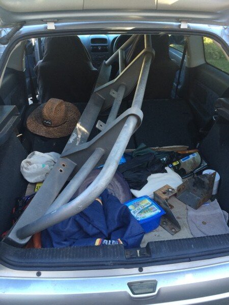

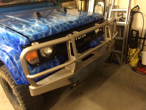

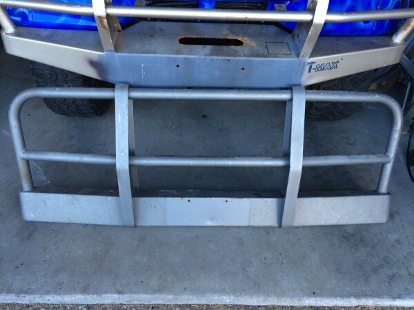

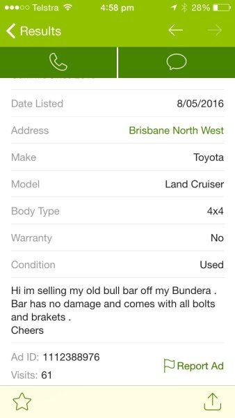

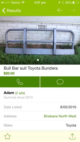

I spotted a very cheap bullbar on gumtree.
Decided for that price it was worth getting as I should always be able to sell it on if I dont use it.
So yesterday we had a drive out and picked it up.
I'm not sure I want to put a winch on RJ, so thought rather than keeping the bullbar thats on it, I could buy and fit this new non-winch bullbar instead. :think:

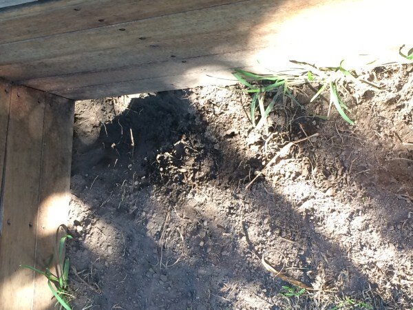

Shes also been tunneling under the deck. :thumbdown:
As far as puppies go though shes actually really well behaved and hasnt destroyed anything of ours or damaged the house at all yet. :icon-biggrin:

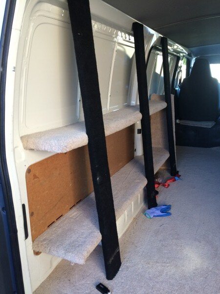

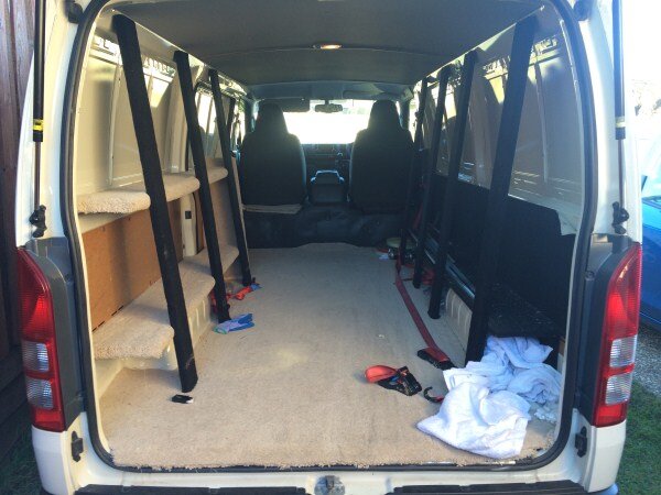

Work have finally given me a van!
Not the new one I was promised, but oh well, atleast I wont have to use my fuel anymore.
Pretty empty inside so it can be loaded up with enough mirrors, shower screens, glass kitchen splashbacks and wardrobe sliding doors to last the day.

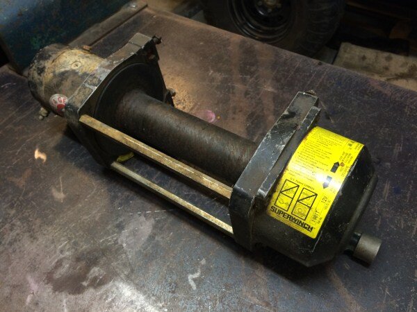

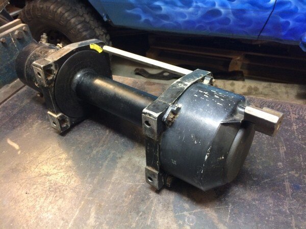

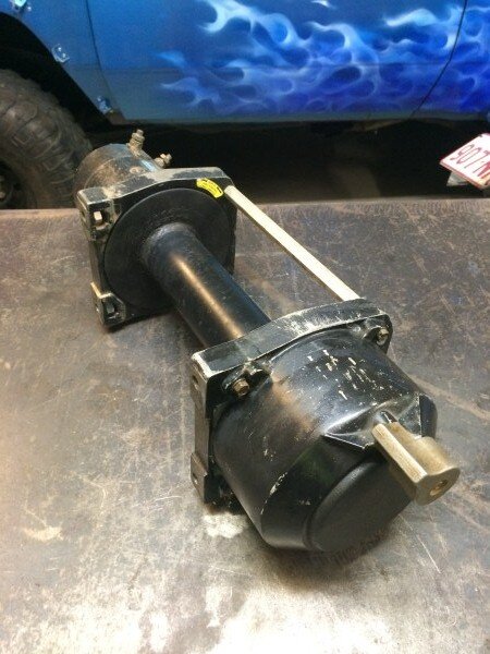

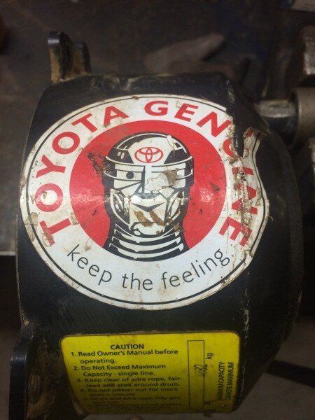

The winch that came with the RJ70 project is a Superwinch X9 with Toyota genuine stickers on it.
I didnt know much about these winches so I did some research....................
On the Superwinch website it says:
They don't build them like they used to." The thing is, Superwinch is still building the X9 and S9000 exactly as we used to, in fact that's the reason so many love these two winches. Toyota even offers the X9 as an option in Australia; that's how tough and well-built these winches really are.
The Superwinch X9 is the original equipment/genuine winch in Australia for the Toyota HiLux, LandCruiser 70, LandCruiser 200 and the Prado for over 10-years.
:think:
So it must be a pretty good winch, I really like the fact its built in America and not China like the majority of winches. :clap:

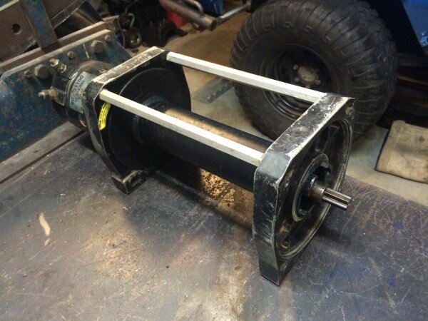

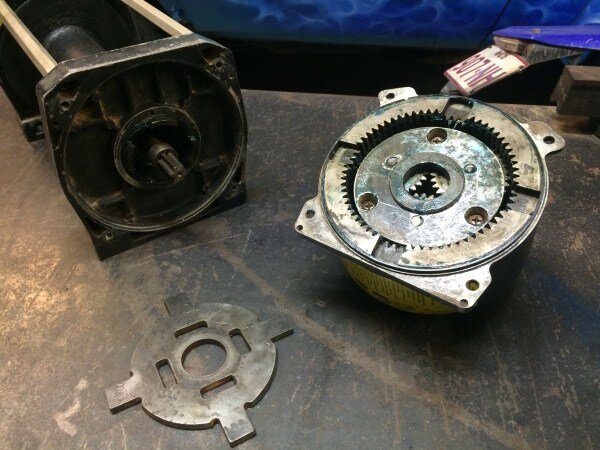

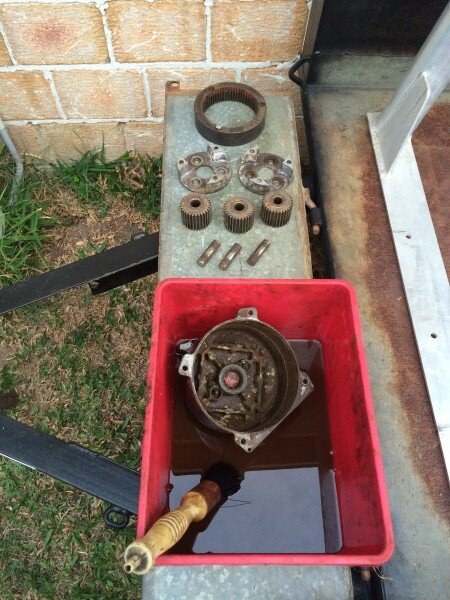

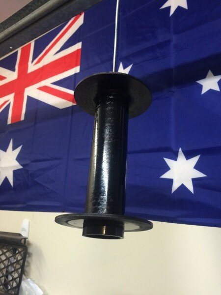

As I needed something to do, I decided to rebuild the winch. :shifty:

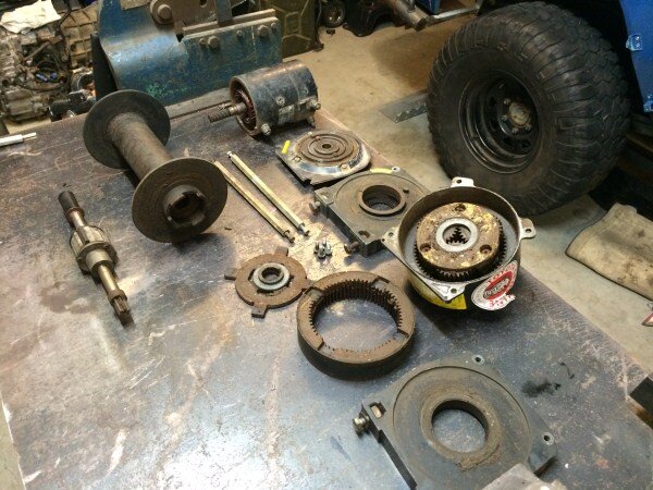

Got it on the bench.
It came apart really easily.

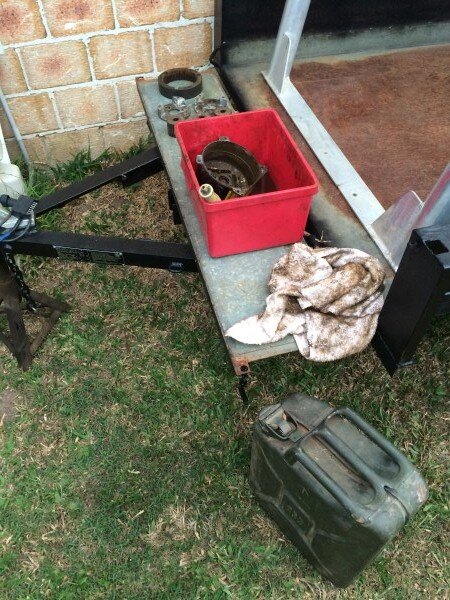

I had to bring the parts outside to clean them in petrol to save stinking the house out.
The trailer made a good work bench.

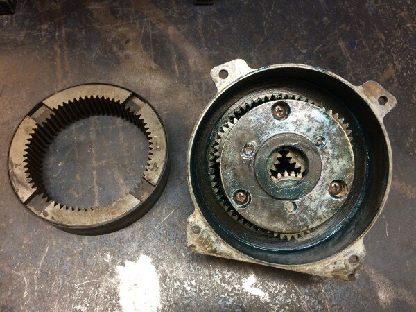

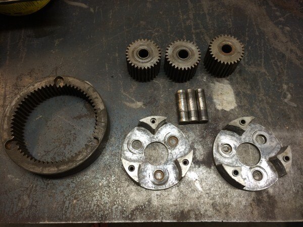

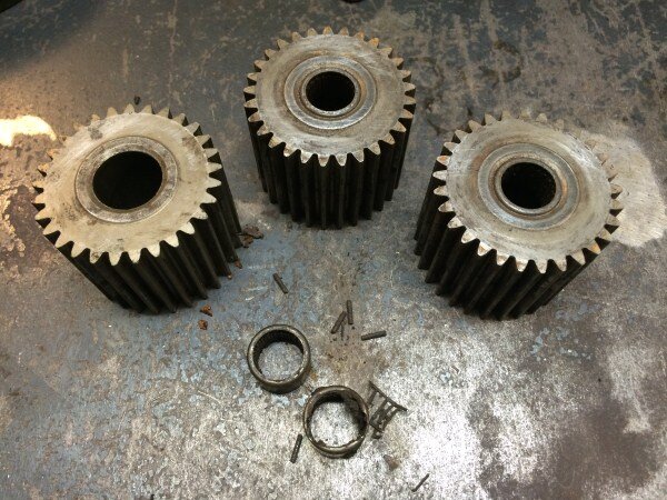

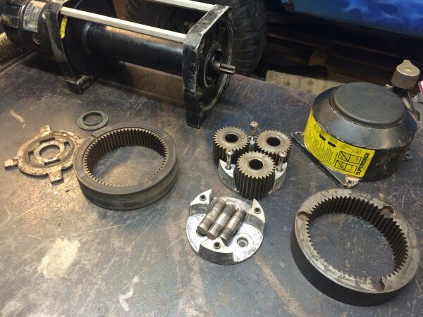

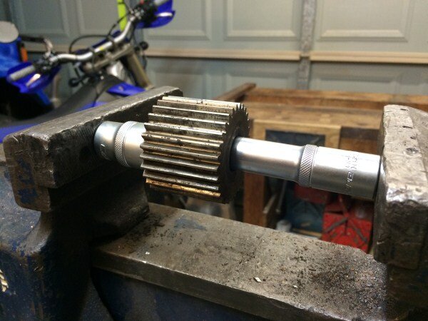

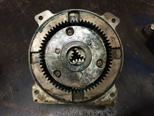

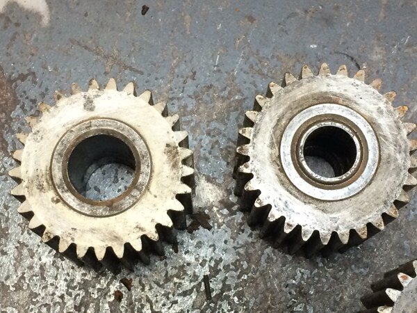

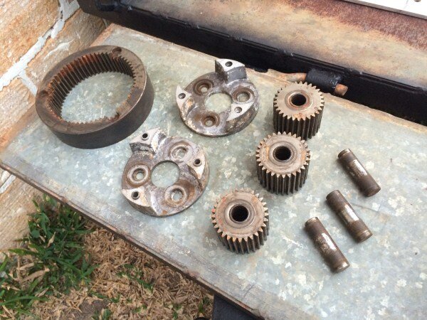

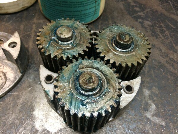

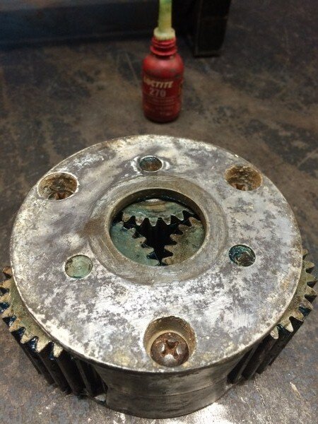

These are all the gearbox parts.

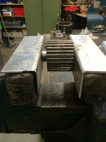

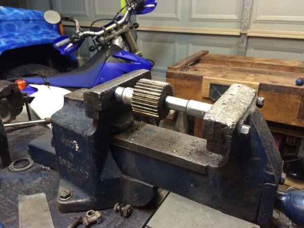

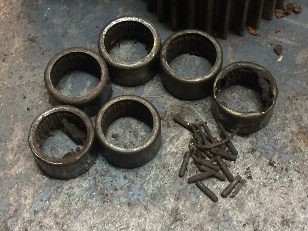

Inside these cogs were needle roller bearings that were completely seized. :doh:
They came out easy enough in the vice using 2 sockets.
Got them all out.

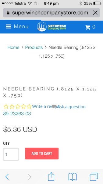

Finding replacement ones proved tricky. :thumbdown:
Superwinch in the USA sell them and that was the only place online I could find them.

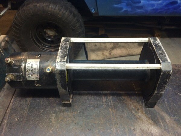

I carried on stripping and cleaning the winch.
I gave the winch drum a clean up and fresh spray of paint.

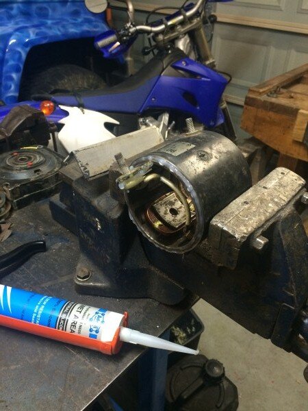

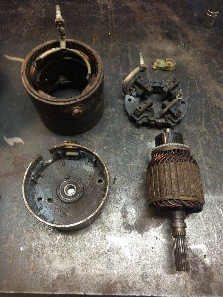

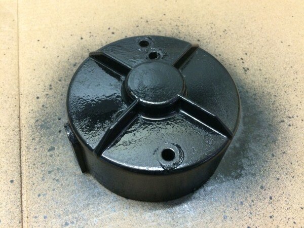

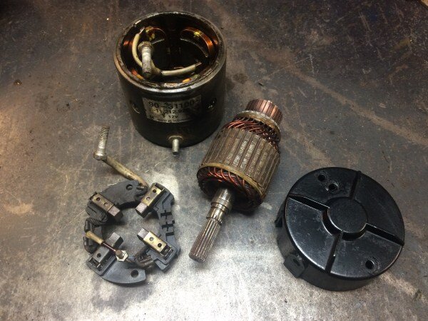

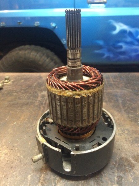

Stripped the motor down next.
Cleaned and painted the end cap of the motor.
The genuine stickers had to go.

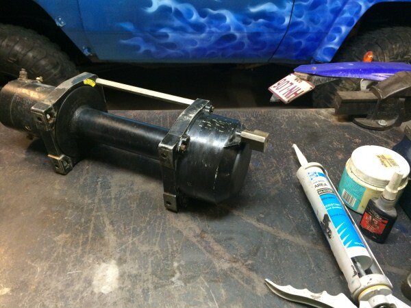

With all the motor parts cleaned I could re-assemble it all.
I used a smear of silicon to hopefully make it water tight.
I left it clamped together overnight while the silcion dried.
Carried on bolting it all back together.
That was as far as I could go without the new bearings.

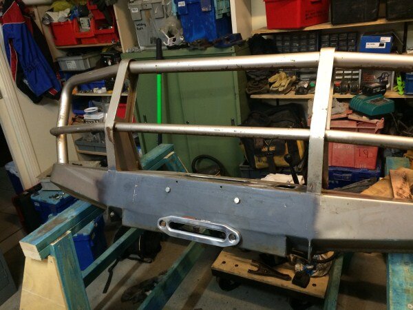

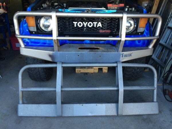

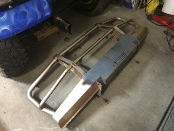

I bolted the empty gearbox case on so I could finish the alternations to the bullbar to make it fit.

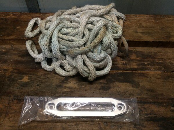

I picked up a fairlead and dug out my spare winch rope.

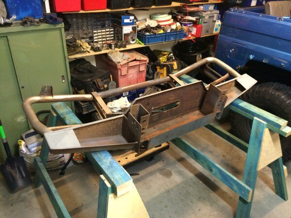

The previous owner had started modifying the non winch bullbar to fit this winch but hadnt finished it.
Bullbar off.
And on to some saw horses for modifying.

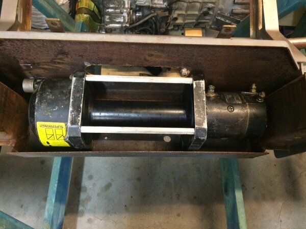

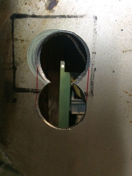

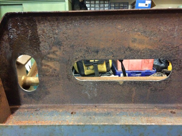

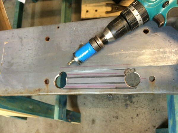

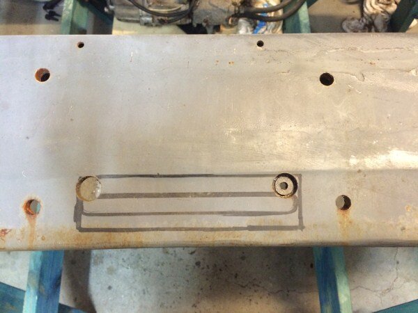

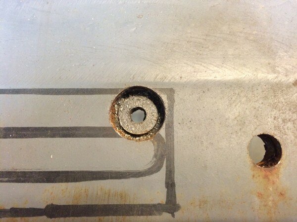

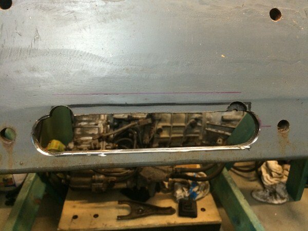

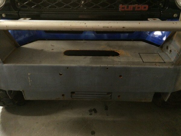

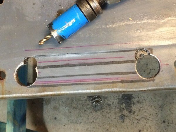

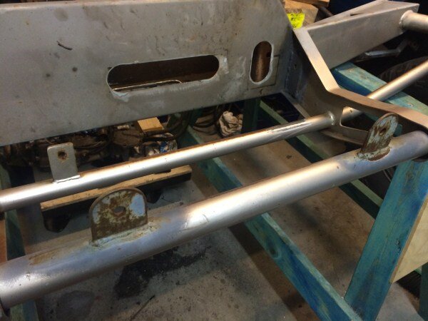

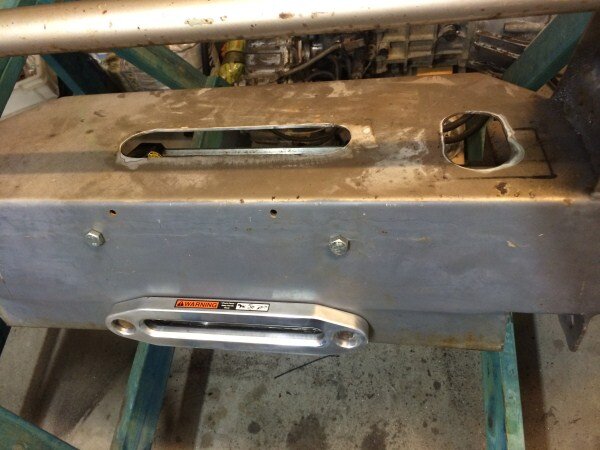

First job was to position the winch and work out where the cut out needed to be for the free spool lever.

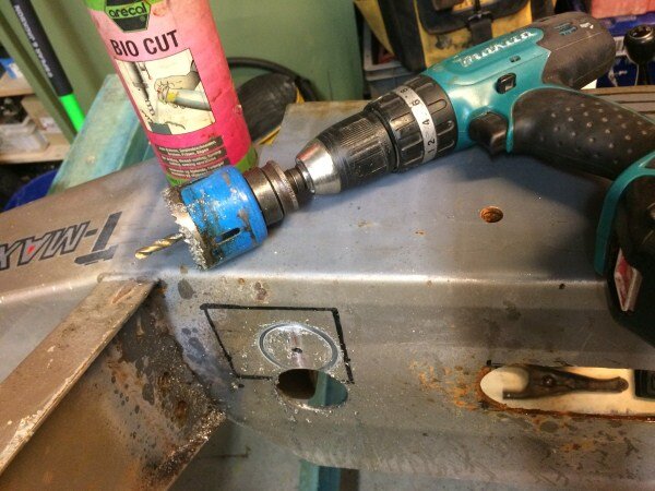

Marked, center punched, pilot drilled and put 2 holes in with a 60mm hole saw.
I opened those holes up with the angle grinder and die grinder.

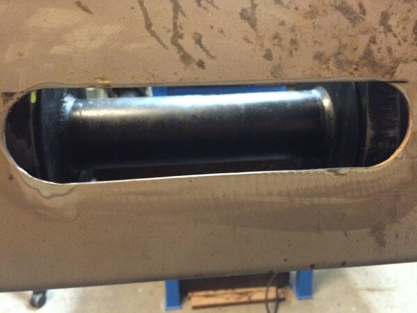

Winch back in place for more checking. The cut out for the freespool lever was in the perfect position.
And the opening to view the winch drum was also good.

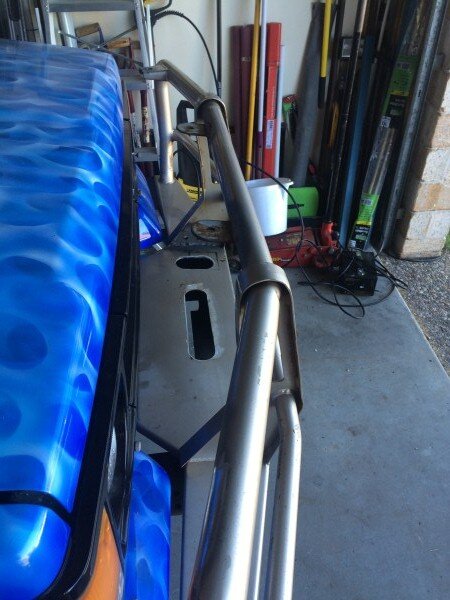

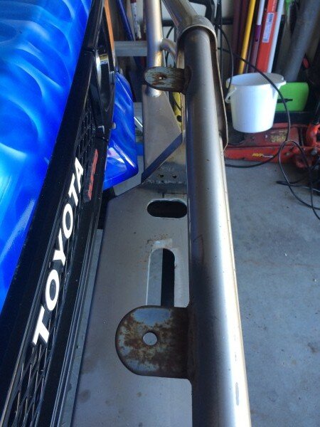

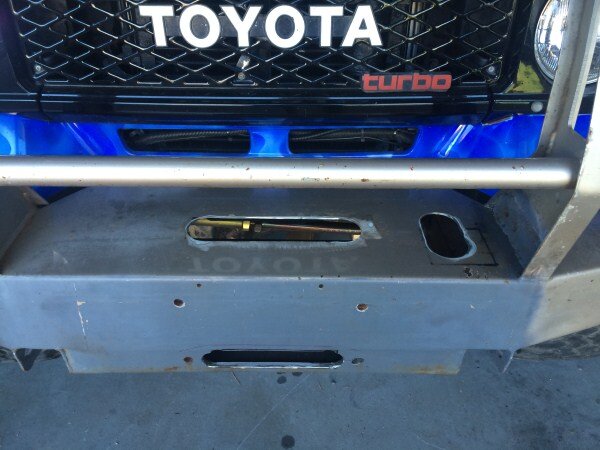

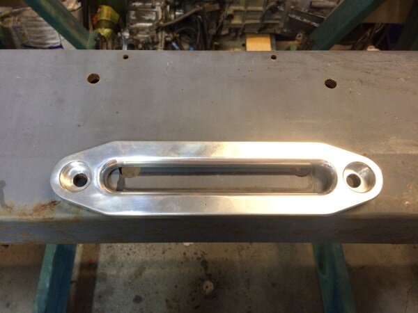

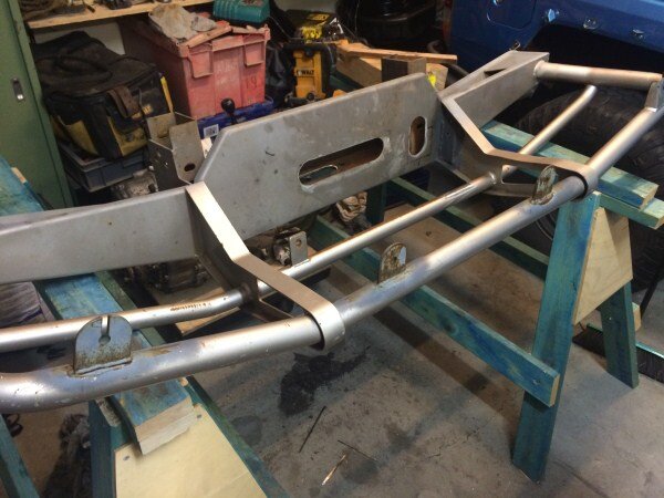

Next I needed to cut out for the fairlead.
The previous owner had made a start using a magdrill.
I didnt want to go quite as high as the previous owner had wanted to as I've seen fairleads snap in 2 if their not properly supported behind them if you cut too much out.
Opened them up with the grinders.

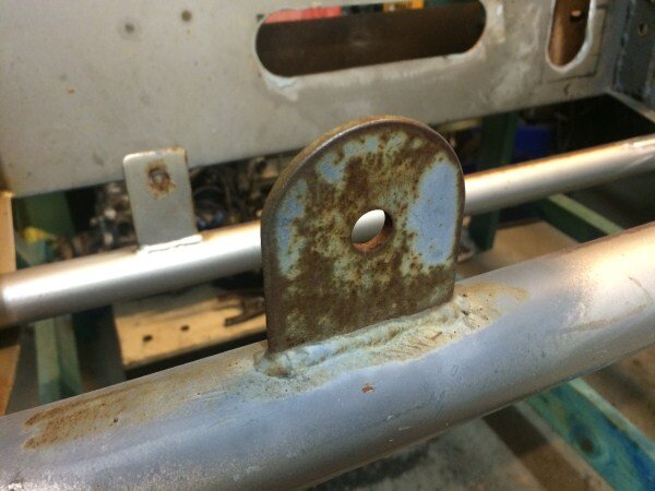

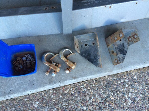

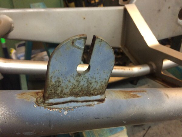

I decided to cut off some of the aerial and light tabs as I dont need that many tabs.
Bolted the bar back on.
Looks better without all the tabs.
Decided to keep the very middle ones for now, but they probably will end up going.

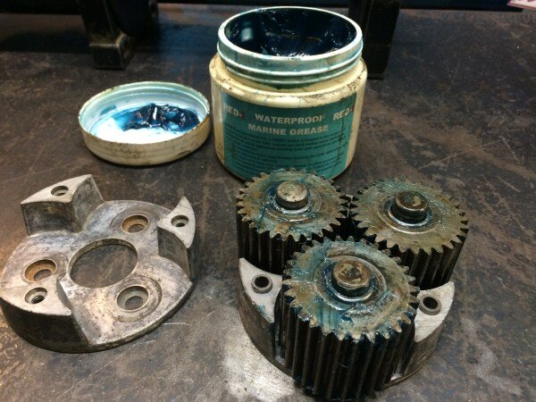

I pressed the new bearings in.
Packed the new bearings and cogs with marine grease.
Thread-locked the bolts holding the end cap on.
Re-assembled it all.
Just one more part to drop in and its done.
Applied a smear of silicon to the mating faces and bolted the gearbox on.
So the winch is now ready to be bolted into the bullbar after its been powdercoated.
