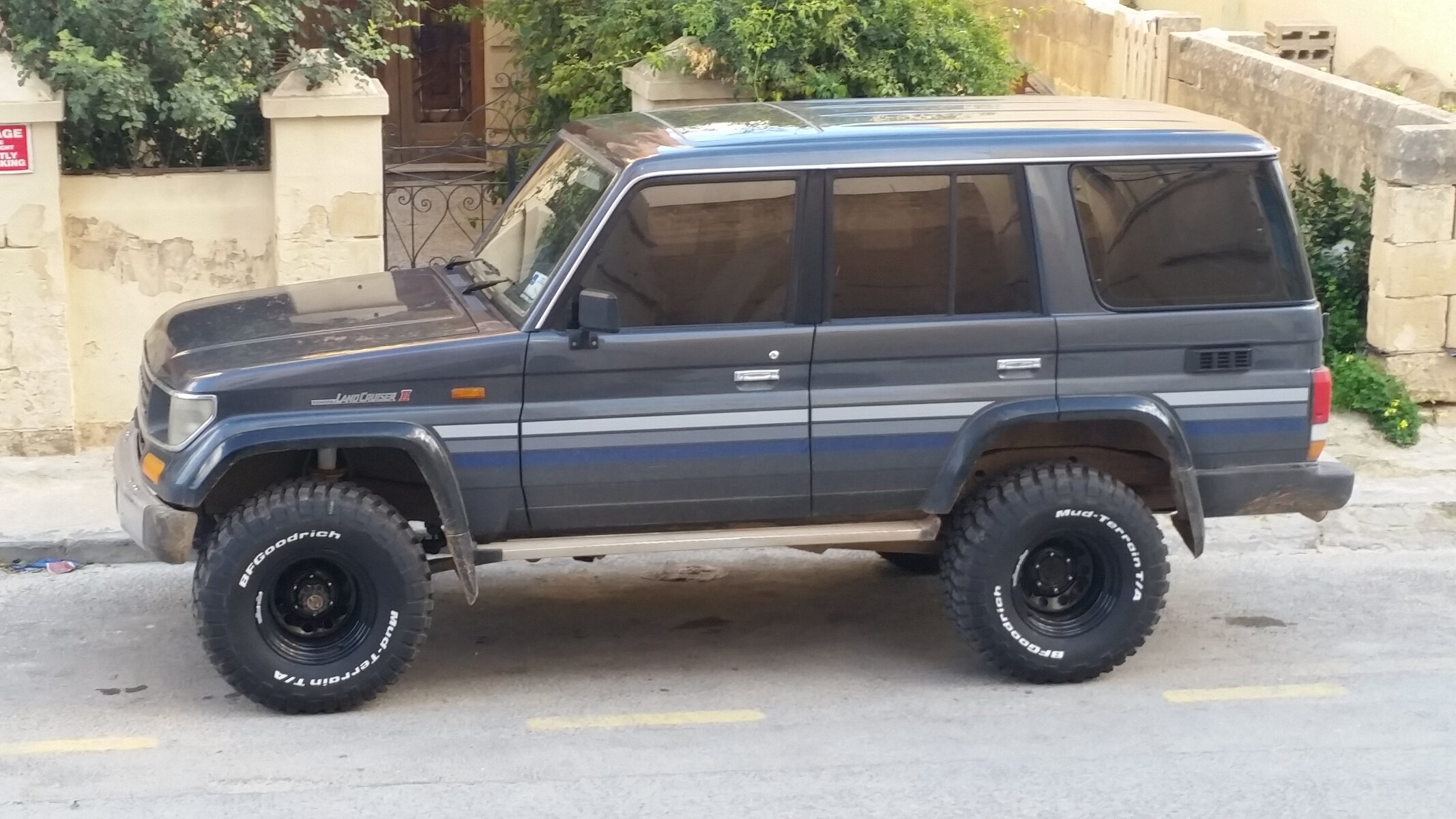

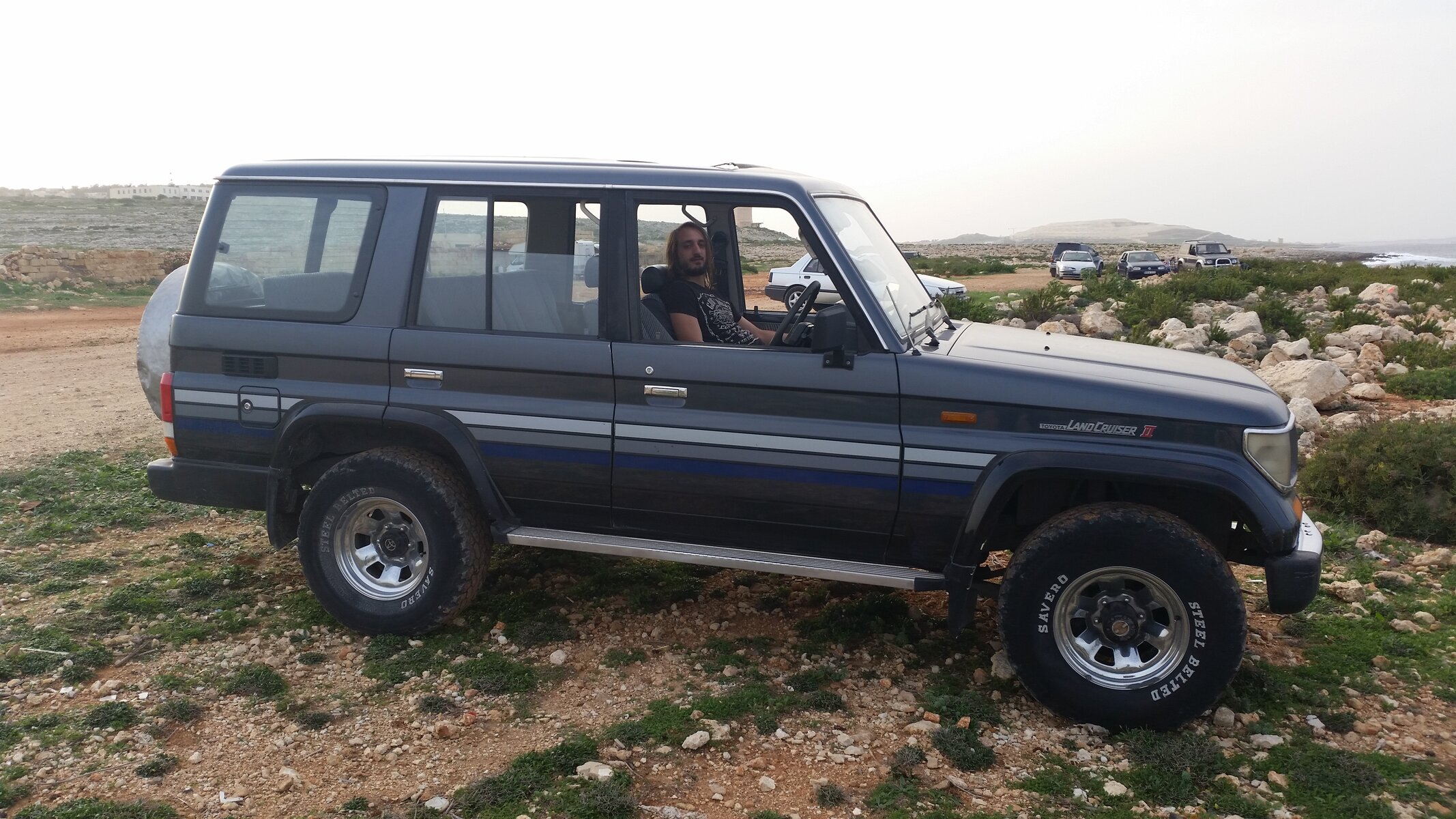

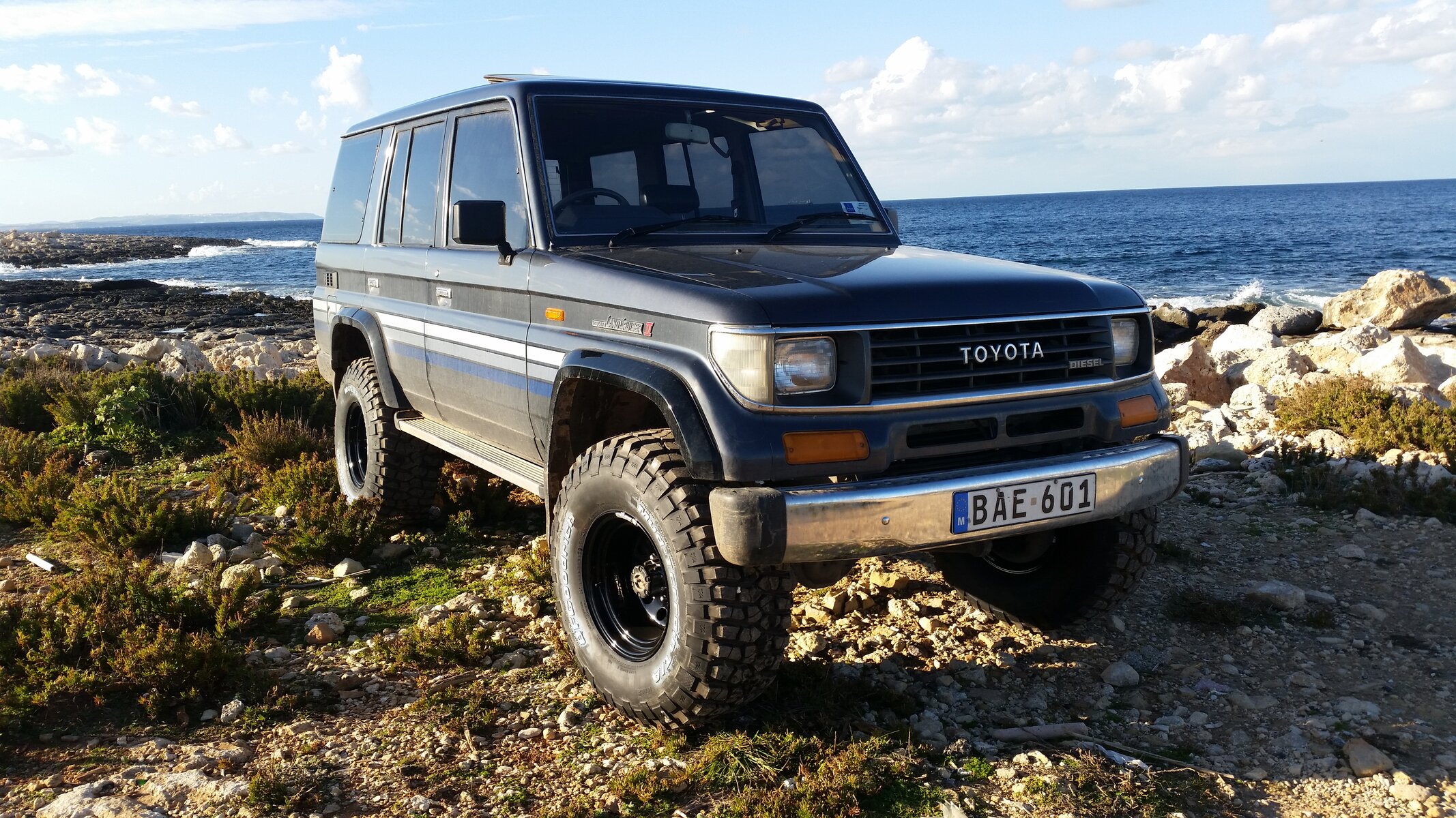

Sooo... a little update :icon-biggrin:
Got around fitting the turbo, suspension kit & wheels... and some window tint :icon-cool:
The turbo made a hugeee difference! It's like I've put in a completely different engine! Very happy with how it's turning out :icon-biggrin:
This is how it currently looks...
