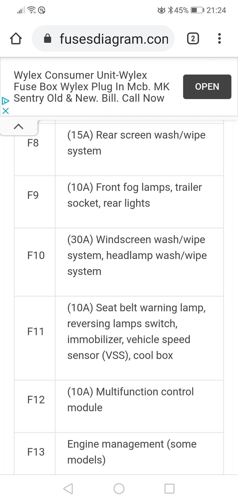

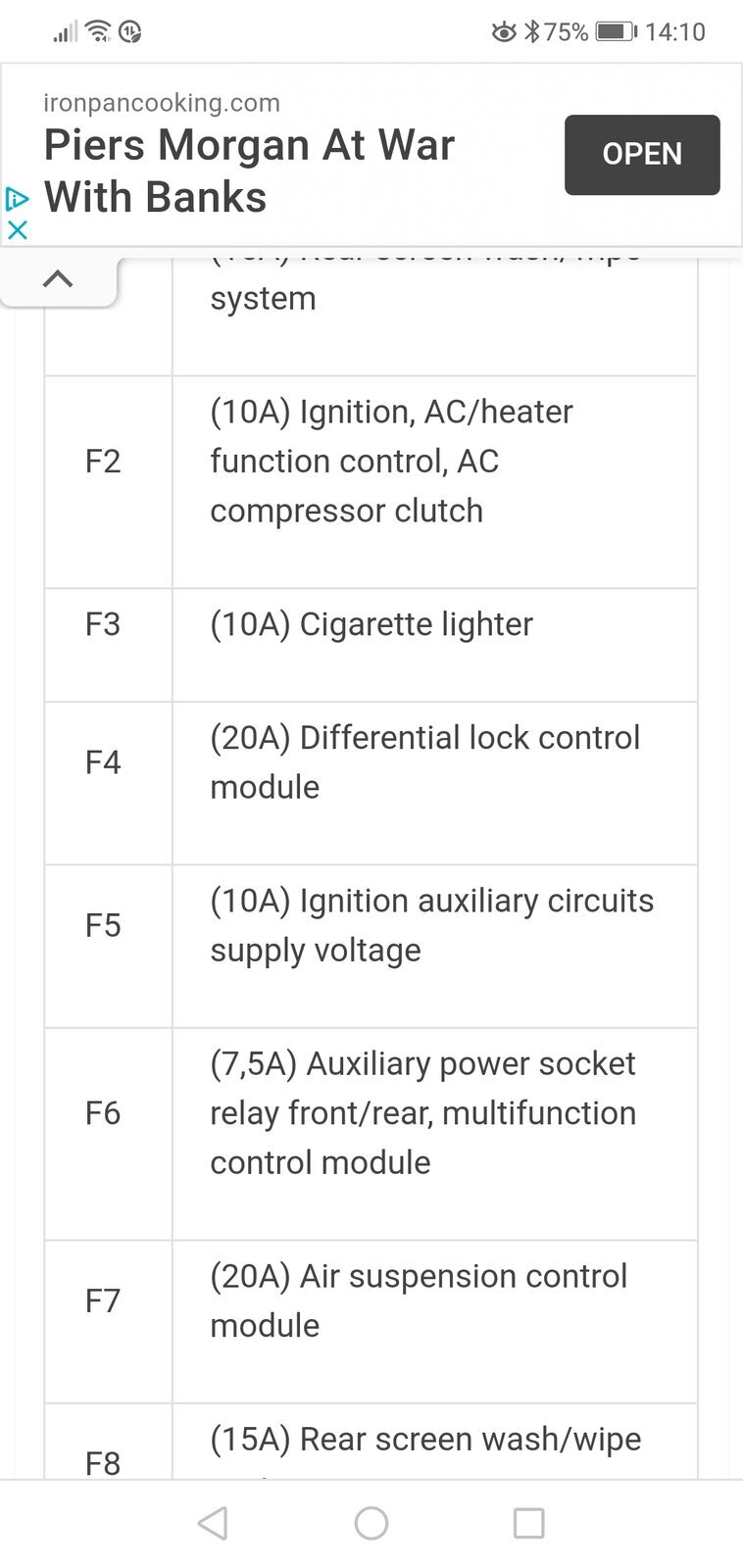

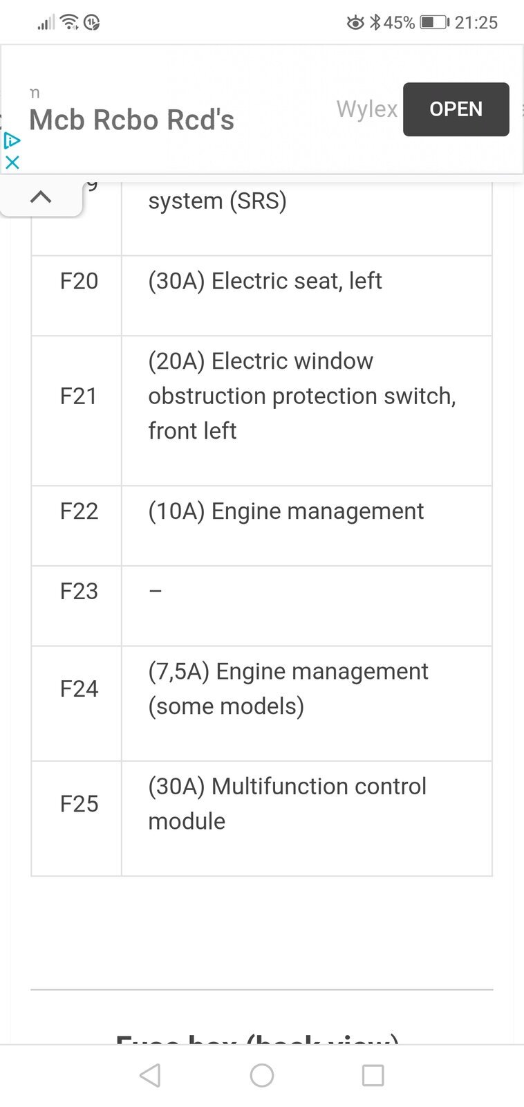

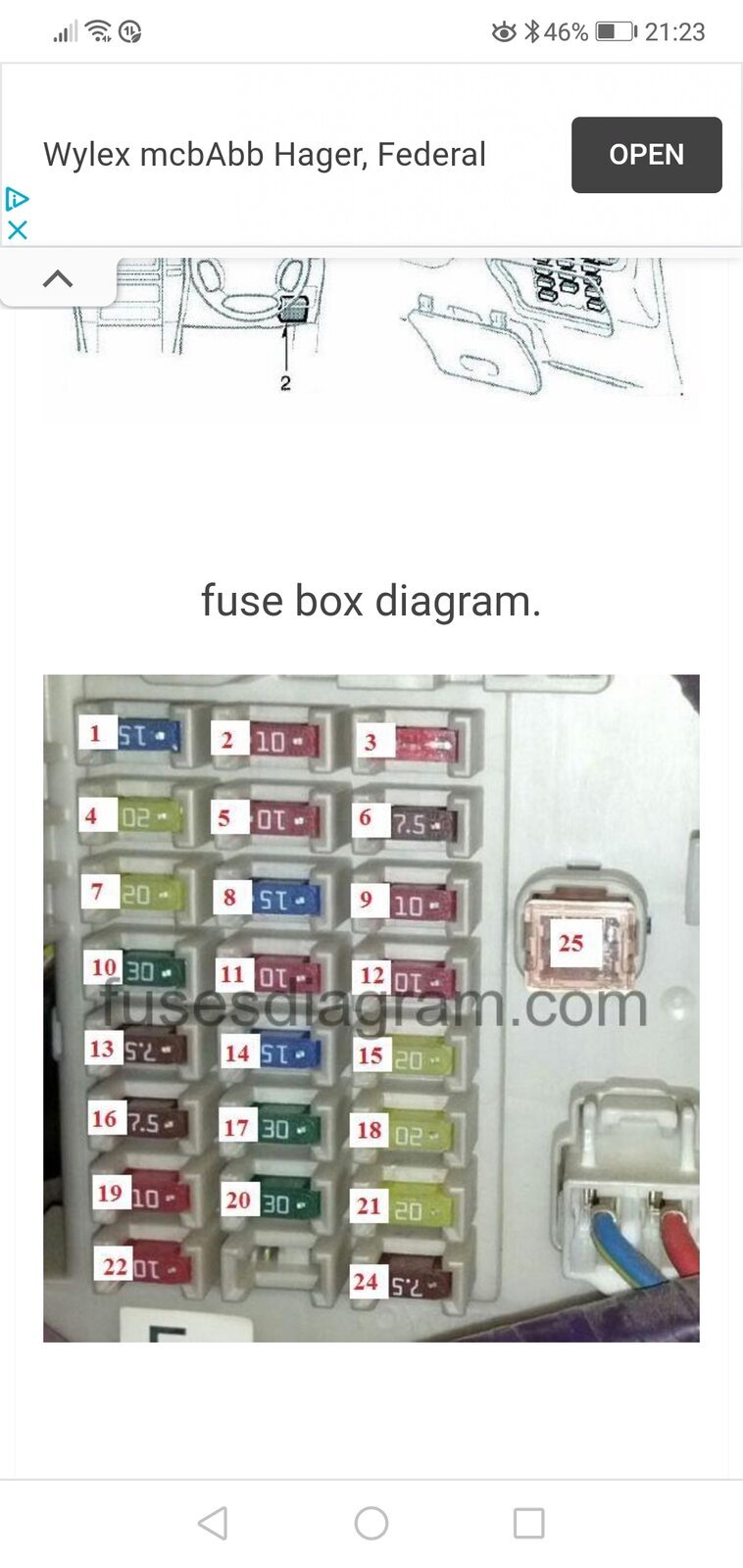

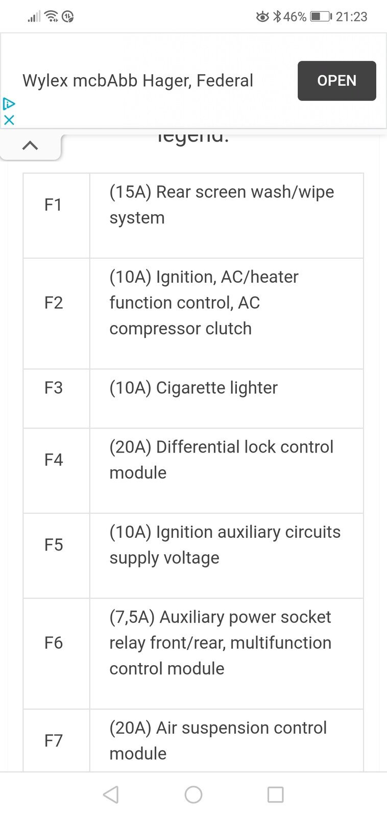

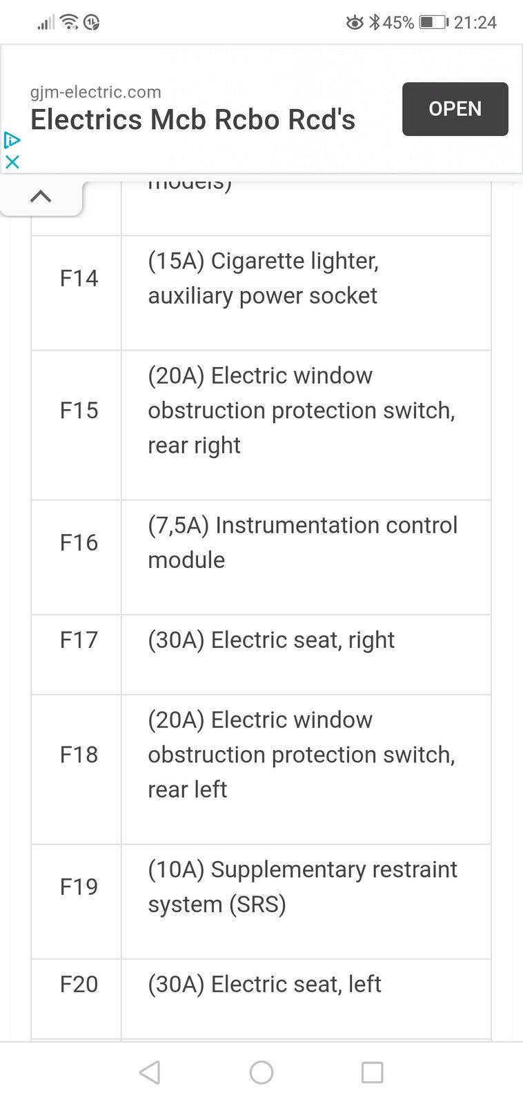

I can't seem to check the fuse box underneath the dash as it's a bit tight. I have tested what I can reach but still no dash. The fuse box diagram for the drivers footwell box is as below.
Any ideas what fuse might cause this problem.
