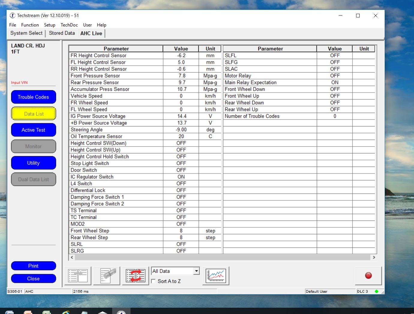

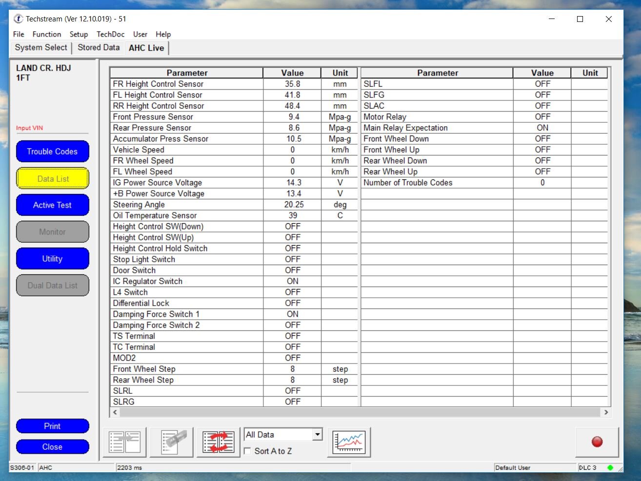

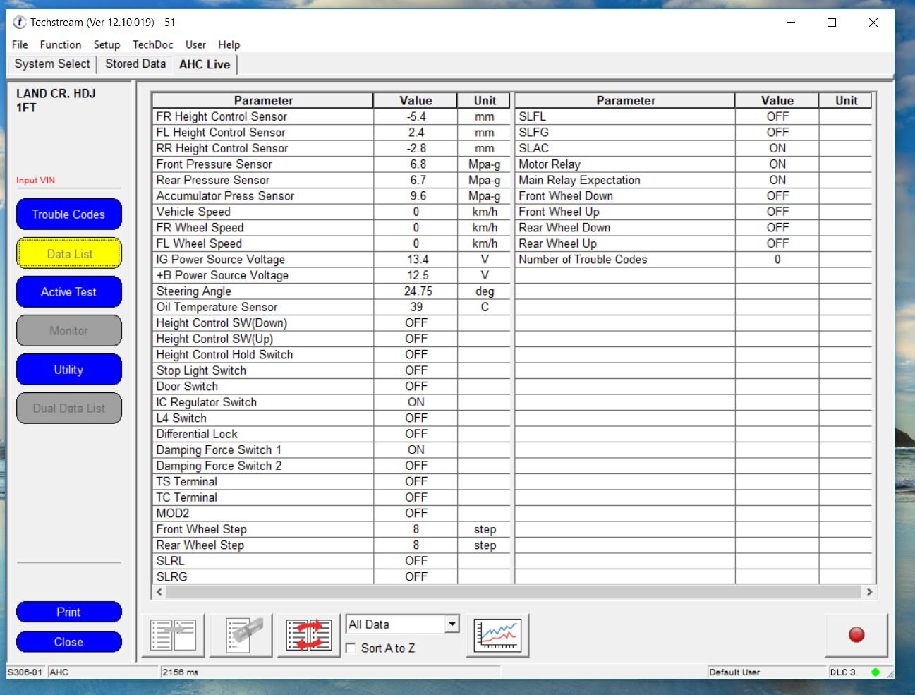

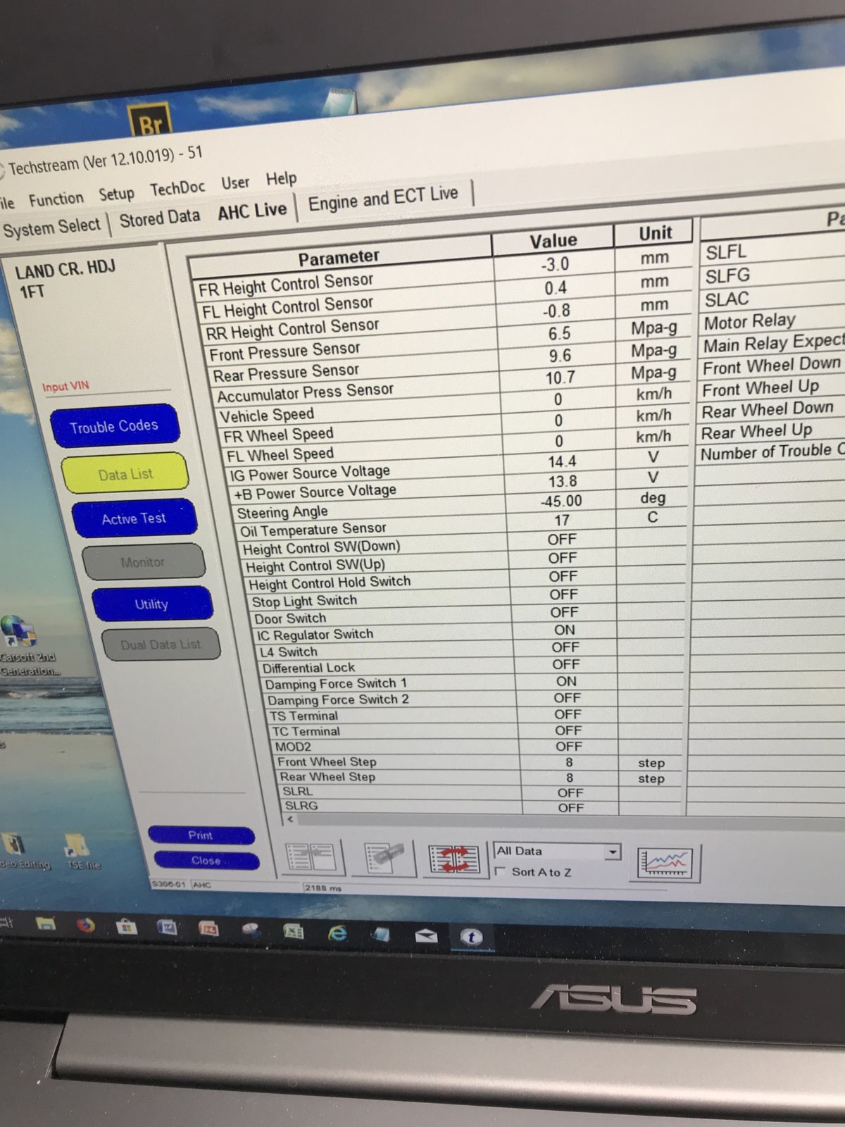

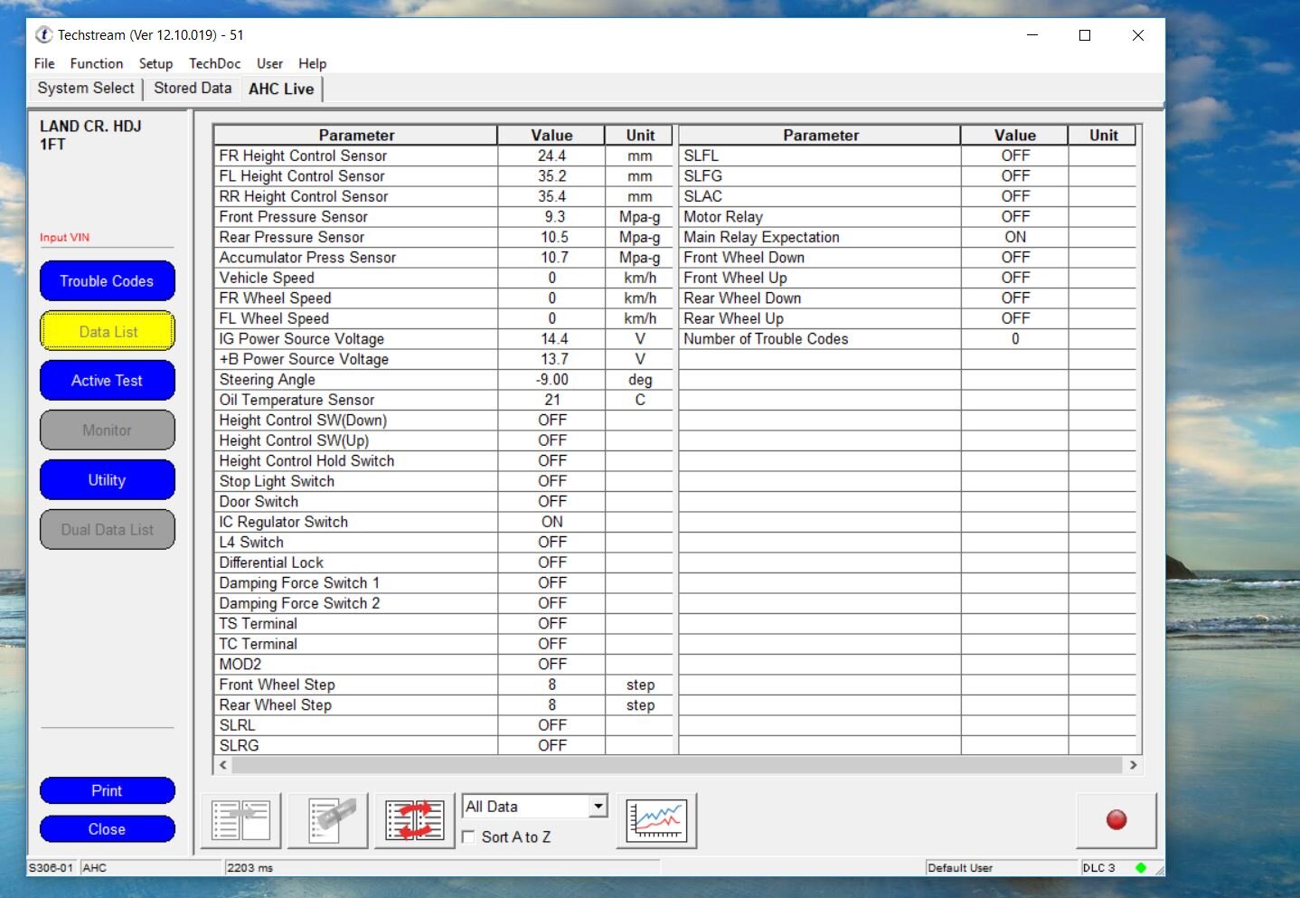

There is a fair bit of additional weight (drawers, RTT, auxbattery etc). Below are the Techstream pressures and heights

Neutral screen shot
High screen shot
Have I diagnosed correctly?
