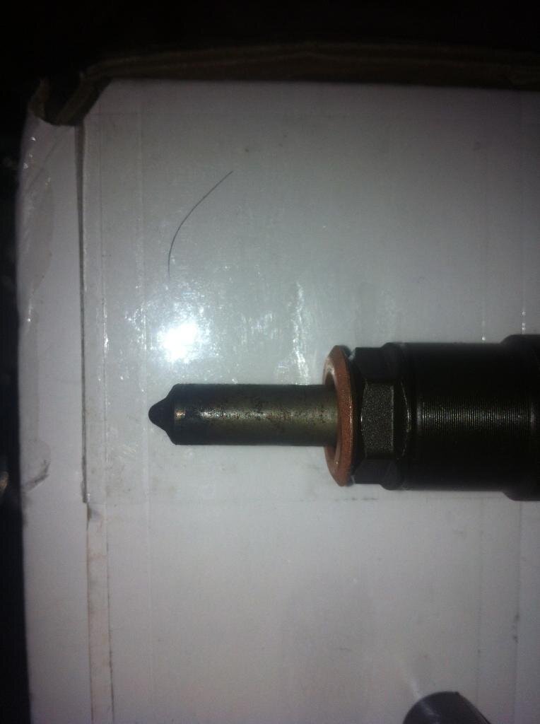

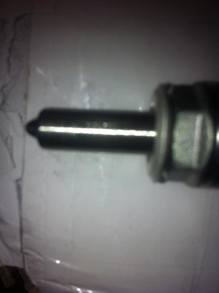

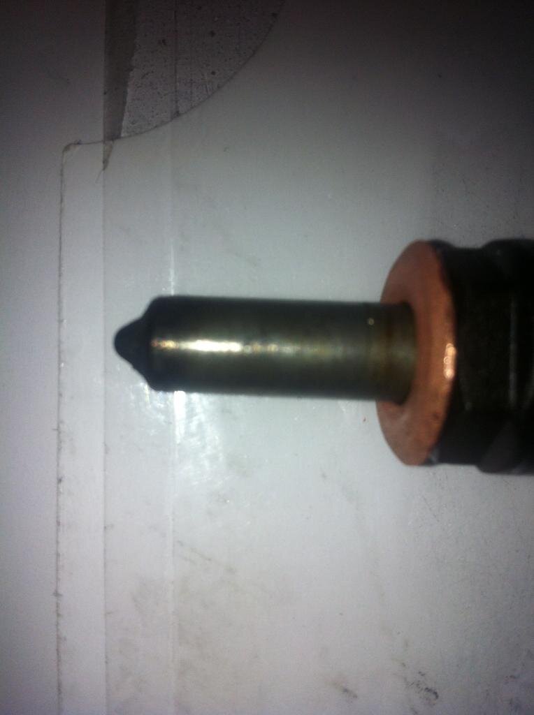

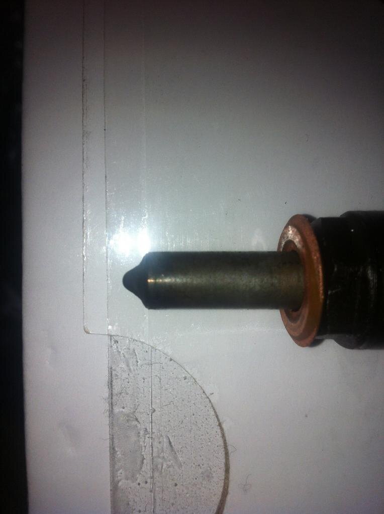

A quick look at the injector nozzles...
Number 1
Number 2
Number 3
Brand New Number 4
Now as it happens, Diesel Jones did all the recall work for Toyota reference the injector issues so i had a good chat with the guy about it.
Firstly... THERE IS NOTHING WRONG WITH THE INJECTORS IN THE D4D ENGINE!!! :angry-screaming:
They are an extremely common unit, used in lots of vehicles.
What happened was that 2 batches of 10,000 sub standard injector washers slipped through the net at toyota, thats 20,000 total, or 5000 3.0 D4D engines used across all models, Land Cruisers, Hiluxes, Dynas, Hiaces etc etc etc between 2004 and early 2008...
These were allowing blow by which was coking the engines up and causing engine failures.

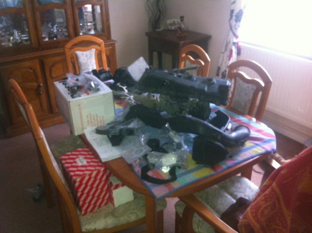

My dining room currently looks like this...
and consequently the wife is losing her sense of humour about it all, so the sooner the better. But in that pile are, new gaskets, filters, new timing belt, lovely new fully synth oil.. you name it, be like a new engine!
