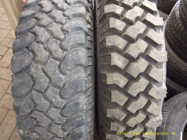

I have.. Well.. they were 8.25R16 sized, but that should be roughly the same as 255/100r16.
Slightly narrower and slightly higher then an equivalent BFG MUD. Did not touch anywhere in my case.
HEAVY tyre! Weighs a ton.
NOISY tyre! Lots of rolling noise. They will hear you coming for sure.
Very rigid as well, and though as nails - did not manage to puncture it despite trying hard ;-)
Pretty damn scary on wet asphalt.
And it looks cool..
But I would prefer the BFG MUD to be honest. Better availability, more flexible (better traction when deflated), quieter, better road handling.
Here is a pic tof my brand new XZL in 8.25r16 next to my worn BFG MUD in 255/85r16

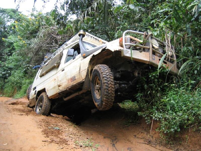

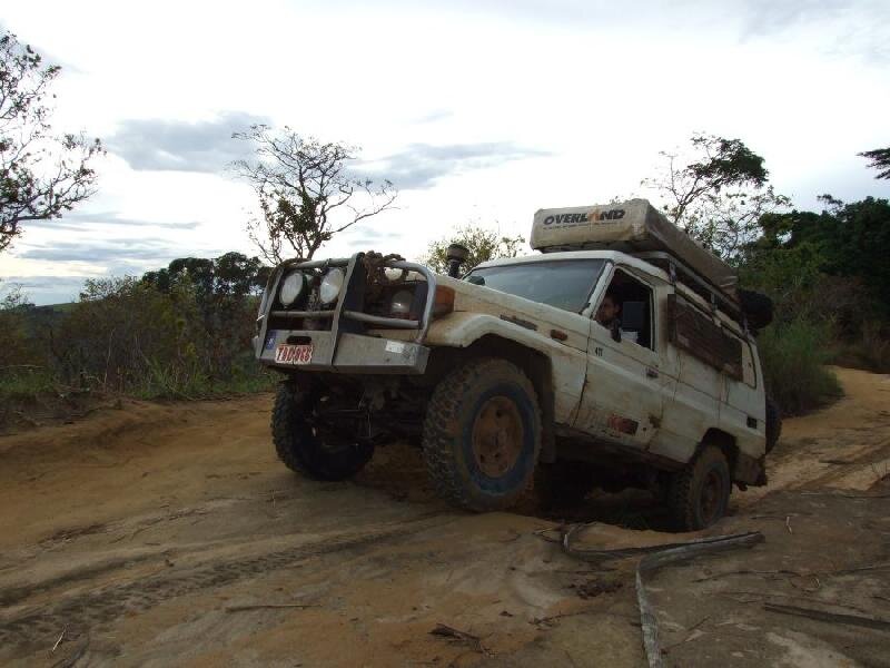

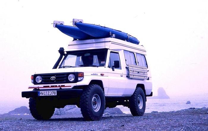

And fitted to a troopy:
(can't post pictures inline yet... too new here :-( - See attached images )
