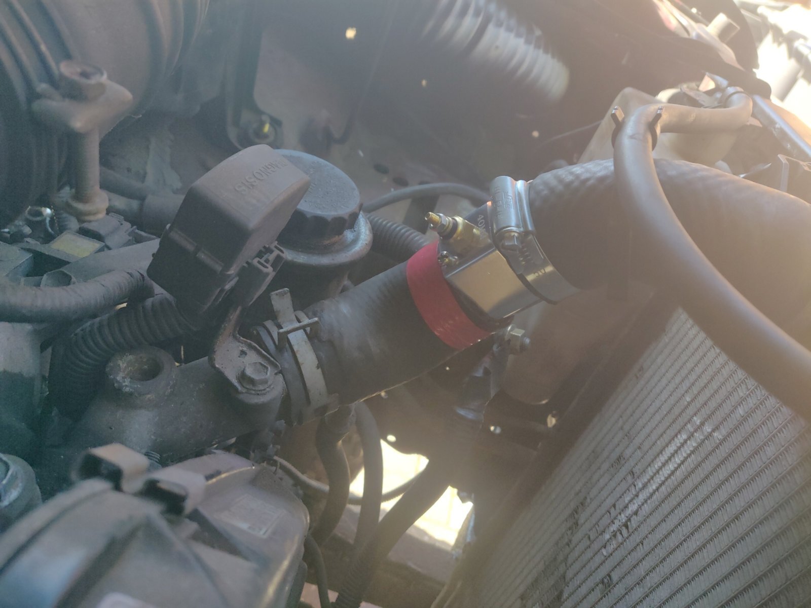

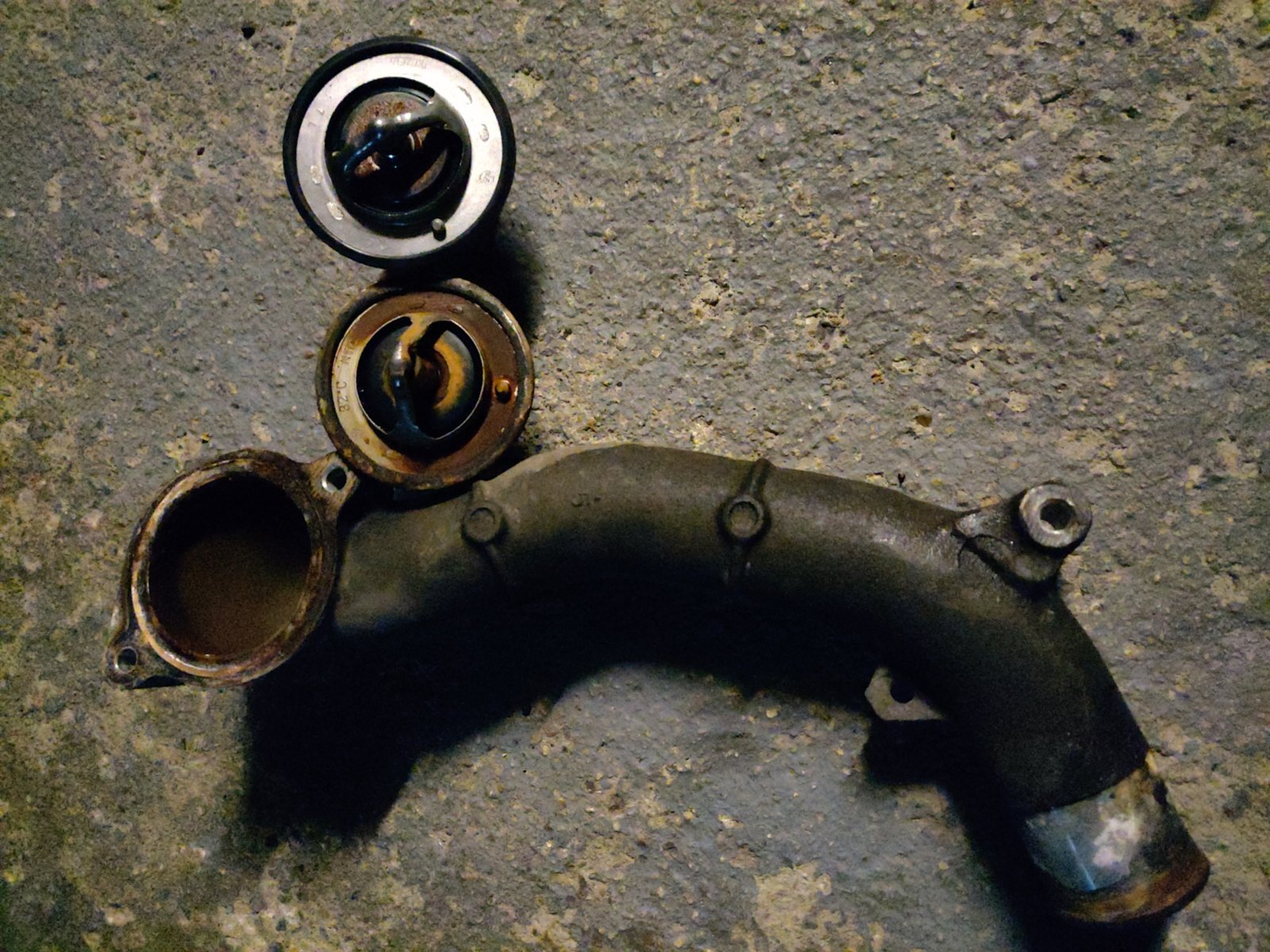

Out with the 82 degree star in with the 76
Grrr looks like I ordered the wrong stat! It's a bit too big to seat in the block. Can anyone point me at the right one... Have a feeling its 72 degrees not 76 as well

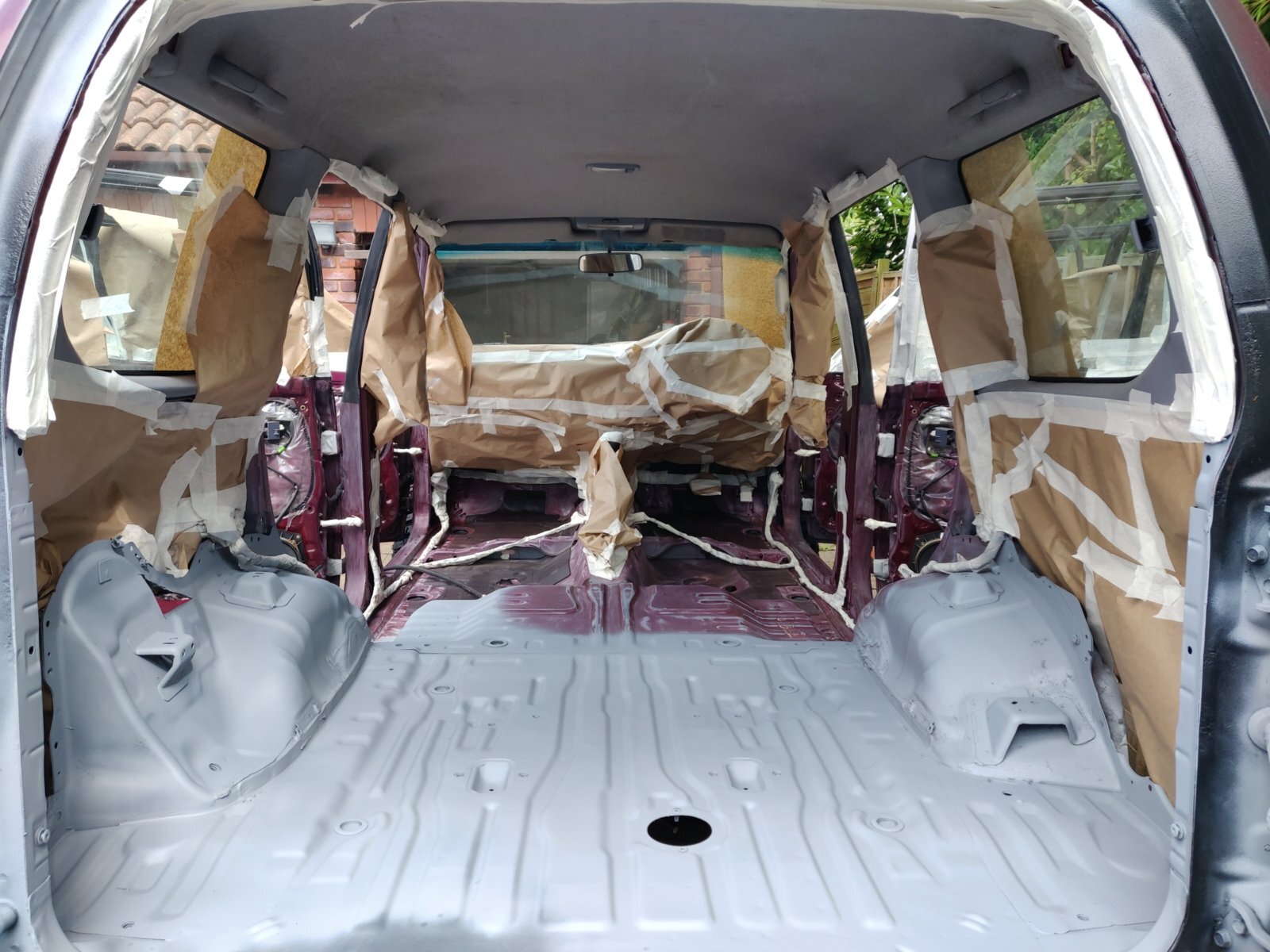

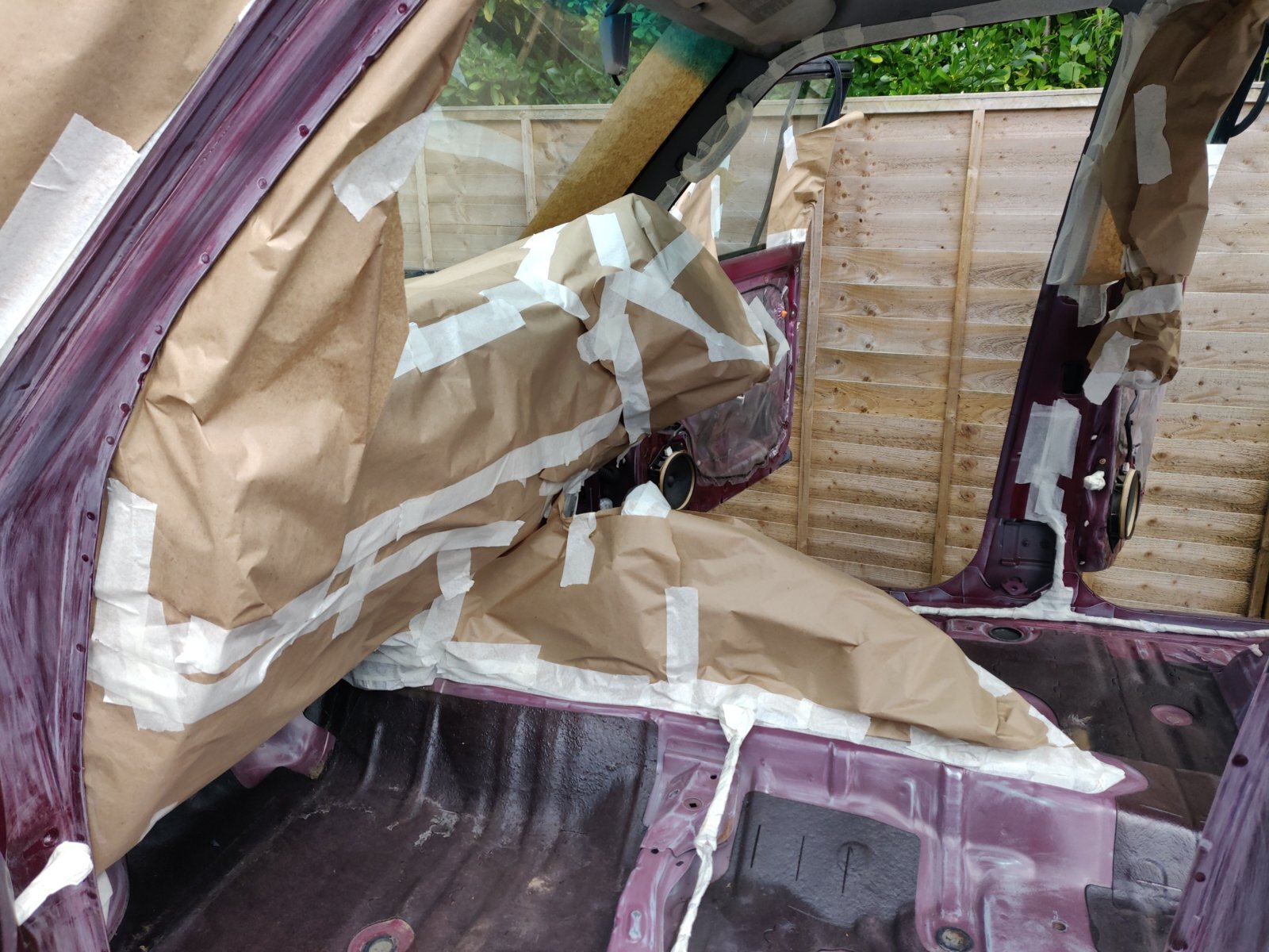

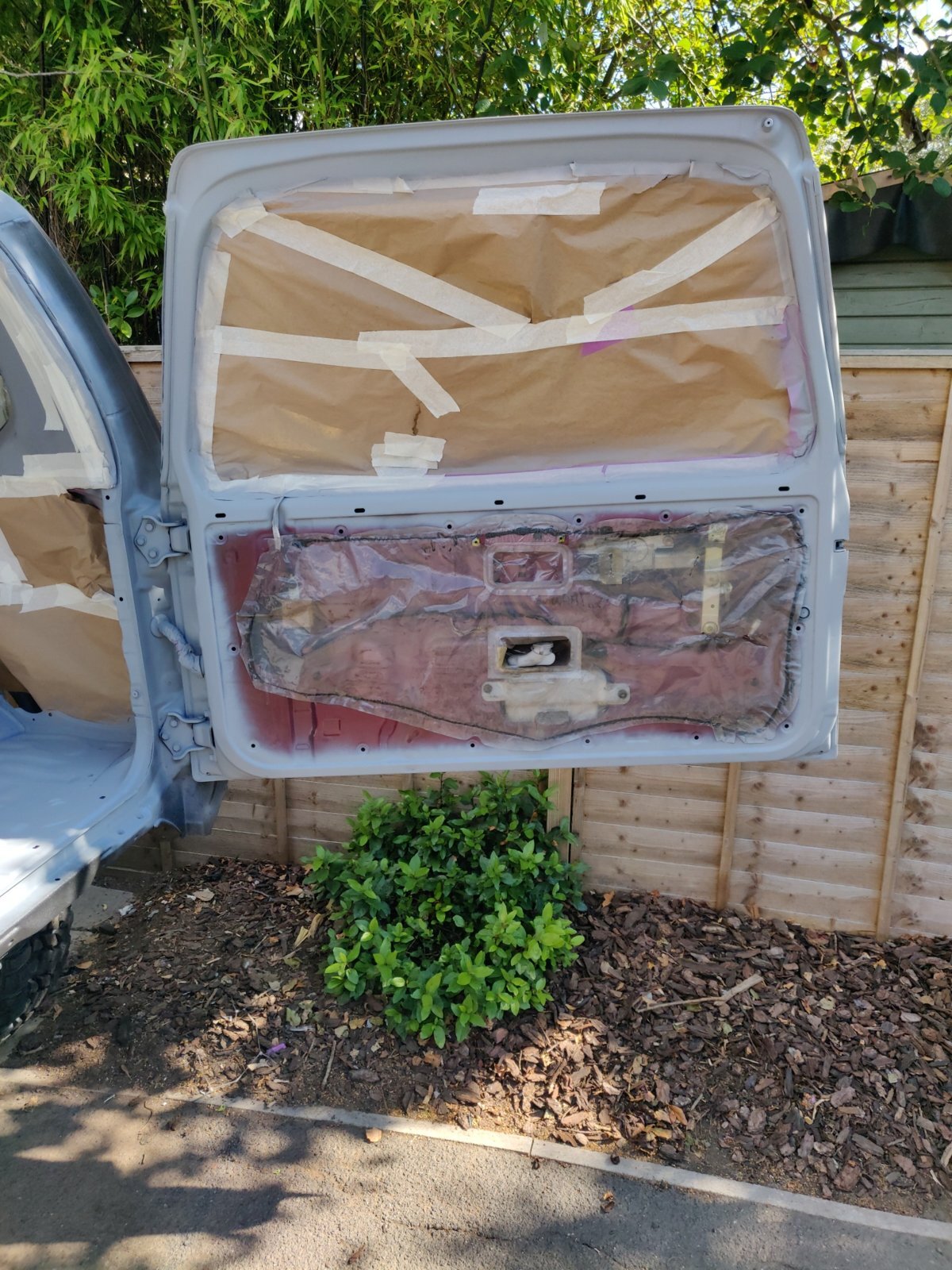

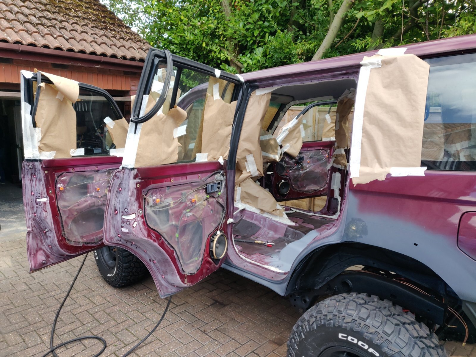

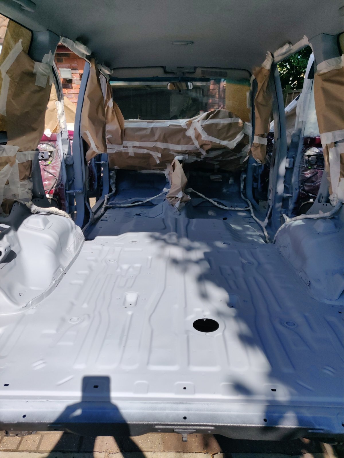

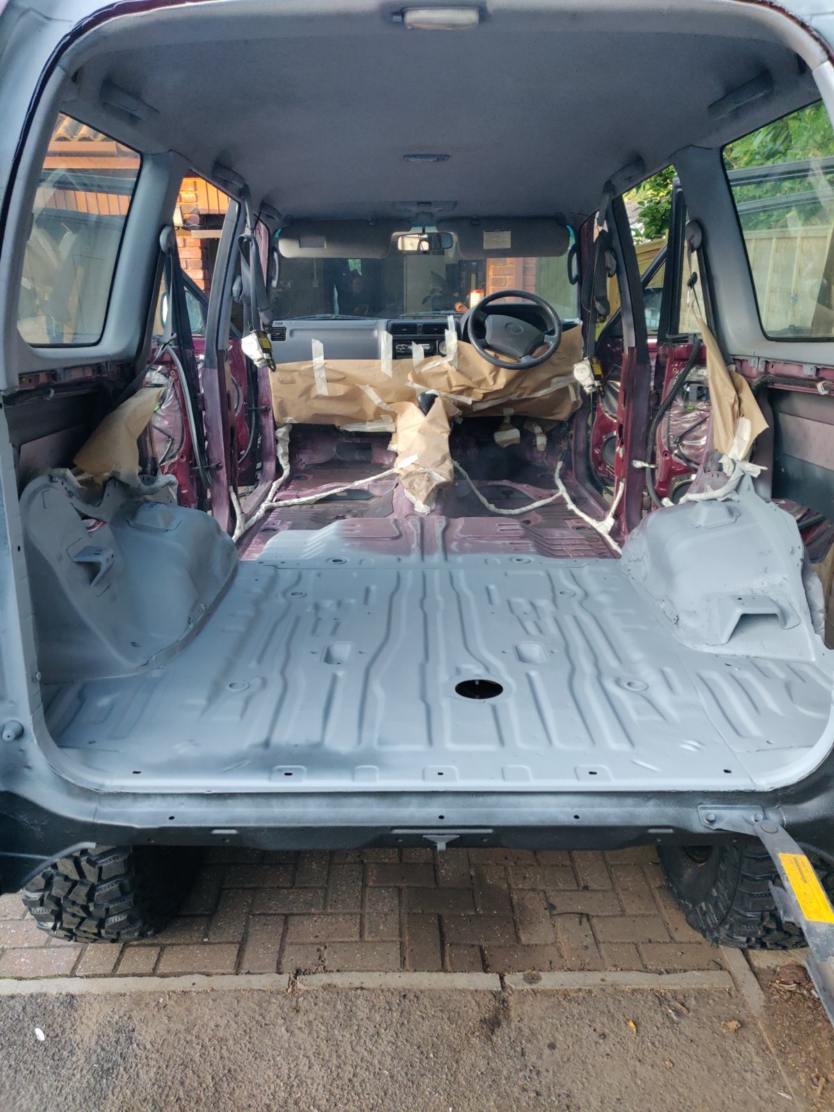

And this is where we stop today... Run out of etch primer
