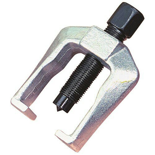

PS. I have the scissor type tool shown in Clive's photo and I got all 3 off in less than 5 minutes. Its pretty much a wonder tool as far as I am concerned!

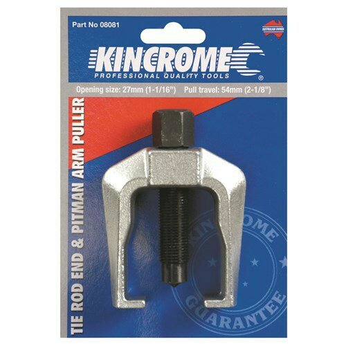

I can't get them out of the knuckle the taper has seized solid , searching for tools this is the only thing to present itself
Which doesn't really look very promising .
I'm about to take a grinder to it as its the only way i can see to get some heat in there but will i regret it ?
Any suggestions welcome .
