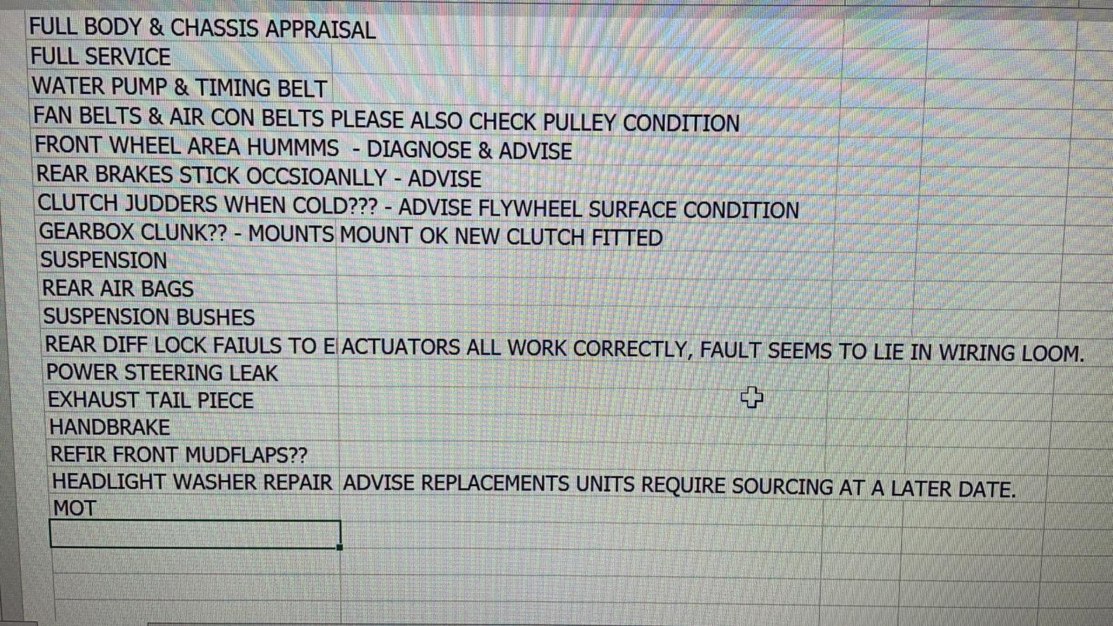

28/02/2021, 16:54 - Martin: Also the rear locker isn't engaging; the original was tested?
01/03/2021, 10:10 - Martin: I did the whole drive around in circles, backwards, etc.
01/03/2021, 10:11 - Martin: If I recall a new one was fitted before checking the original, it was found to be working, original refitted, and the wiring therefore was the issue. Was the wiring not repaired?
01/03/2021, 10:51 - Redacted: IMG-20210301-WA0000.jpg (file attached)
Yes, your lockers were tested on another vehicle and we confirmed their operation. And we advised that the faults possibly lie in the wiring loom and would require stripping out to trace and diagnose the cause of the issue.
01/03/2021, 10:51 - Martin: Right so that wasn't done?
01/03/2021, 10:53 - Redacted: You didn’t confirm when I advised that was the issue to proceed with that repair process. We can do it when it’s back for the body works.
01/03/2021, 10:54 - Martin: Had I not enquired, there would have been a new one fitted for 700 or so, which still would not have worked.
01/03/2021, 10:55 - Redacted: Not so, we would have checked operation prior to handing the car back.
01/03/2021, 10:57 - Martin: Right so it's my fault that I didn't explicitly ask it to be fixed
01/03/2021, 10:57 - Martin: As an original issue brought to your attention
01/03/2021, 10:57 - Redacted: No not at all.
01/03/2021, 10:58 - Martin: And that when I asked what else it needed, and it was described as mechanically mint, that would have excluded this item
01/03/2021, 11:04 - Martin: And it was my responsibly to ask the question 'can you fix this then as you have identified it is broken', as that question was not posed to me at any point, other than it being listed on this job sheet. So a entirely new axle was put on but it felt correct to leave this broken on the basis I didn't proactively confirm that I wanted the original issue resolved.
01/03/2021, 11:07 - Martin: My view is this work was forgotten as it seems completely illogical that it would have been my intent to bring you a car with an inoperable diff, have the entire axle replaced, spend £13k getting it mechanically sound, but decide to leave it broken.

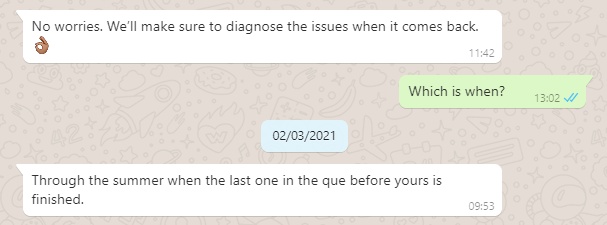

01/03/2021, 11:42 - Redacted: No worries. We’ll make sure to diagnose the issues when it comes back.
01/03/2021, 13:02 - Martin: Which is when?
02/03/2021, 09:53 - Redacted: Through the summer when the last one in the que before yours is finished.

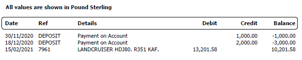

Summary so far: £13k and three months on a car with the same problem I took it in with, and throughout have been very clear in my line of questioning as to why the most expensive item on the sheet needed replacing.
The above explanation by [redacted] does not make sense to me.
  • New locker installed -> "we would have checked operation prior to handing the car back" -> found a problem with wiring -> either fix it or asked me if I wanted it fixed?
  • Original locker reinstalled -> known problem with wiring -> don't fix it, don't ask me if I wanted it fixed, hand it back without so much as a mention at any point
All the other items on that list got sorted out without my intervention. Whereas, conversely and for example, the minutia of wheel caps was discussed and brought to my attention and confirmation.
Imagine the converse:
  • New locker installed -> "we would have checked operation prior to handing the car back" -> found a problem with wiring -> don't fix it, don't ask me if I wanted it fixed, hand it back without so much as a mention at any point, and presumably leave the cost of the new difflock on the bill
    • Therefore, if this was not what would happen, why does using my original diff change anything? It doesn't. Yet I get this outcome less the cost of the new difflock.
Combine this response with "OK" gestures:
This narrative by [redacted] makes clear that [redacted] knew that the diff did not operate, as they had known to have informed me, and knew also that I did not advise fixing it, therefore knowing it was surely still not locking. Had this repair been a forgotten oversight I could understand that, but let's be clear: [redacting] suggests that this was known and clear to both parties, therefore this was my fault.
I find this outrageous. The correct response, FYI to anyone running a business is "sorry, bring it back and we'll get that sorted".

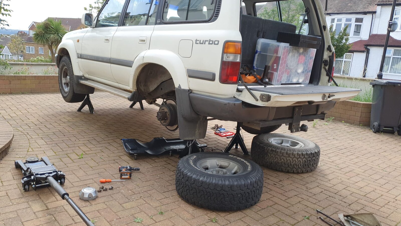

31/08/2021, 17:35 - Martin: I would expect that the rear diff needs to come out (backlash issue potentially) and a multimeter around the loom for the actuator issue.
31/08/2021, 18:04 - Martin: I can do September, as we discussed before, or first two weeks of November as October is busy. If we agree November I do need to know that it will be done, so please plan for it as this allows two months prior notice. Otherwise I can drop it this weekend but I do need it back 25th.
31/08/2021, 19:28 - Redacted: As I said I cannot commit to a deadline at the moment…. And my workload takes us 15months in advance at the moment so any other work is fitted in at our discretion. I’m sorry I cannot be any more help but if you find someone else in the mean time that’s no worries.
31/08/2021, 20:30 - Martin: I can find someone else but it would be a poor reflection on [redacted] that I've had to do so... which I've already had to do for the aircon. I've been trying to address this since March and I've agreed twice to the dates put forward (end of summer, September). So work with me here and let's find a window of a few weeks as I can't just leave it indefinitely.

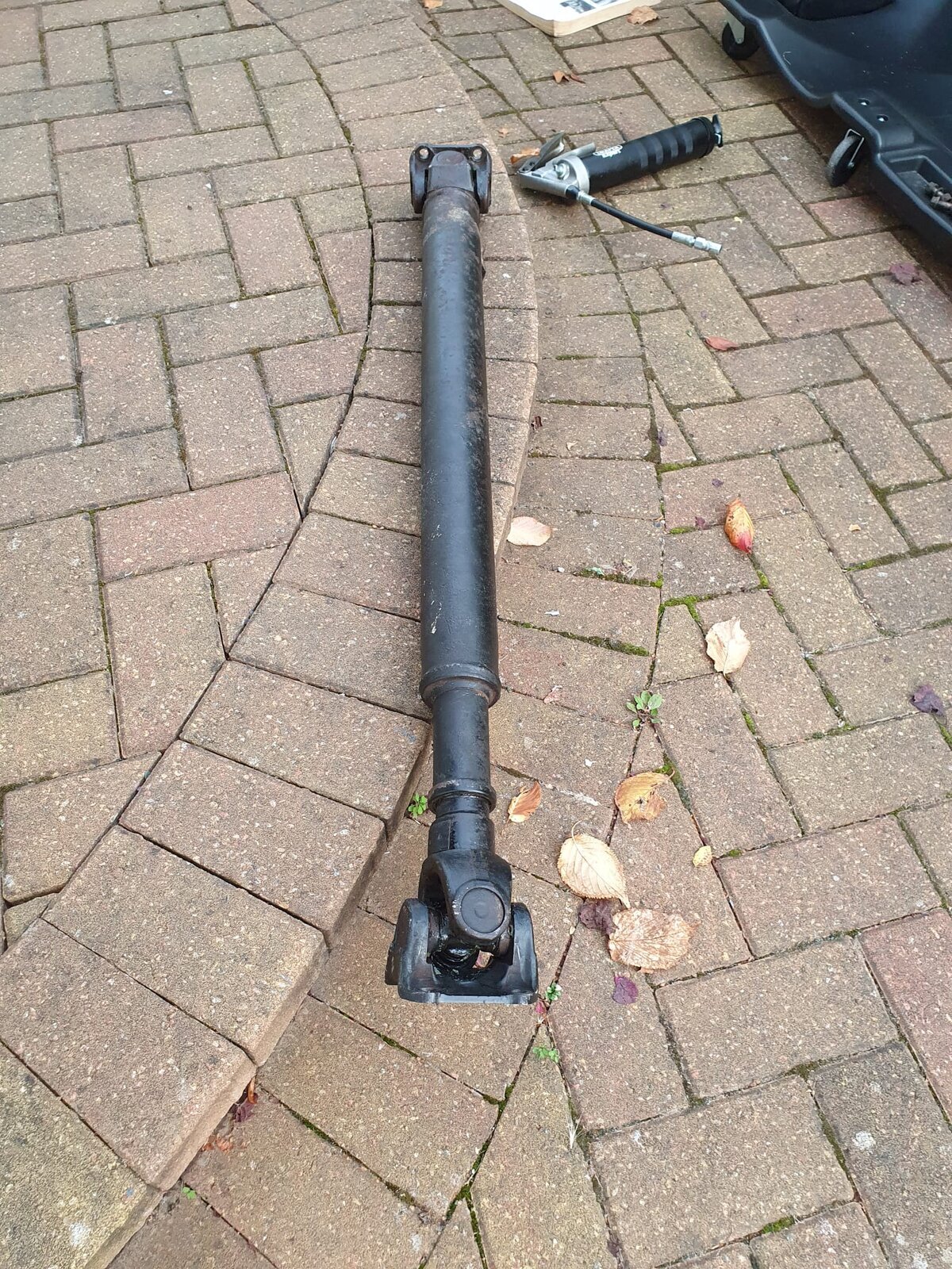

12/09/2021, 12:34 - Martin: IMG-20210912-WA0003.jpg (file attached)
I'm annoyed. I paid you 13k to fix this car which had a power steering leak, no aircon, and no working rear difflock You return it with the same problems, tried knocking me for a new rear difflock, plus added grinding noises coming from the replacement diff, and tell me to wait until the summer so you can fix what you left unfinished. Now that time has come and gone, you've taken more work on instead, and now fixing the work your did is apparently at your "discretion". You aren't doing me a favour, I'm trying to get what I paid you a rather considerable amount of money to do finished. I've tried to be reasonable and work with you on dates and you keep fobbing me off. So here I am, 13k lighter, addressing the original problems I brought to you in December of last year.
13/09/2021, 21:13 - Martin: IMG-20210913-WA0004.jpg (file attached)
Too much green grease injected inside so the slip yoke couldn't slip and the yokes were reassembled out of phase. Took it for a spin with the cdl on and rear shaft off, and this definitely contributed to the vibrations. Refitted now @88nm, in phase, excess grease removed. Will see how it is at 70mph.
