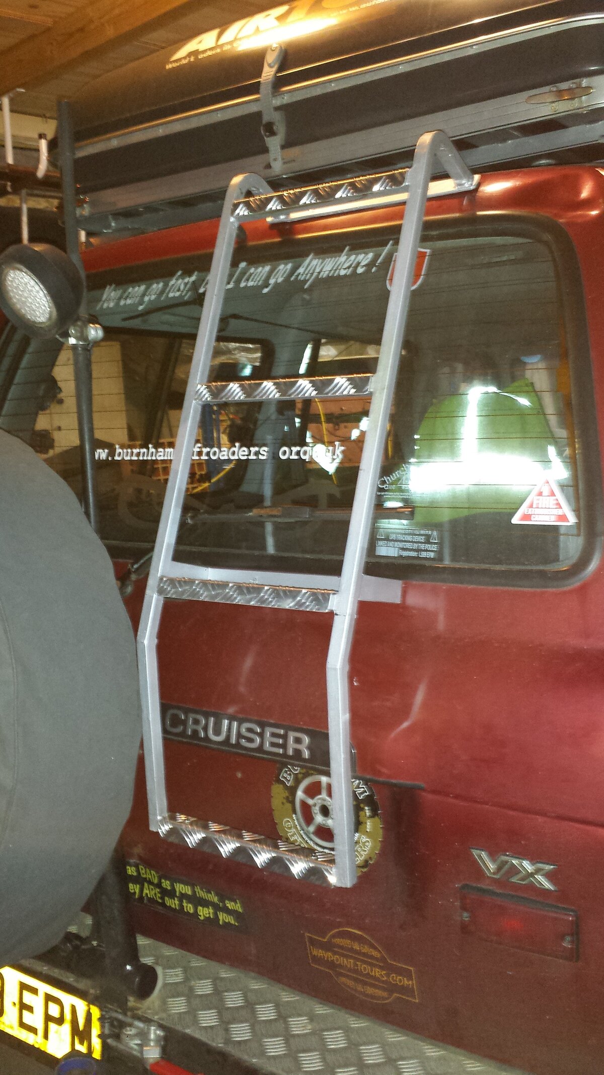

@Clive, that's a lovely piece of work, I particularly like the chequer plate on the steps. :thumbup::thumbup:

Well getting back to the ladder, I asked for it to have good clearance away from the door, so I don't make toe marks in the door paint. The guy looked at me strange, and I said like this one, and pointed to the ladder on the back of his Chevvy V8 hippy van and sure enough there were toe marks in the paint!
Thats why why it stands away from the door so much.
The treads are rectangular section, so the chequer plate idea was easier than if they had been circular section tube.

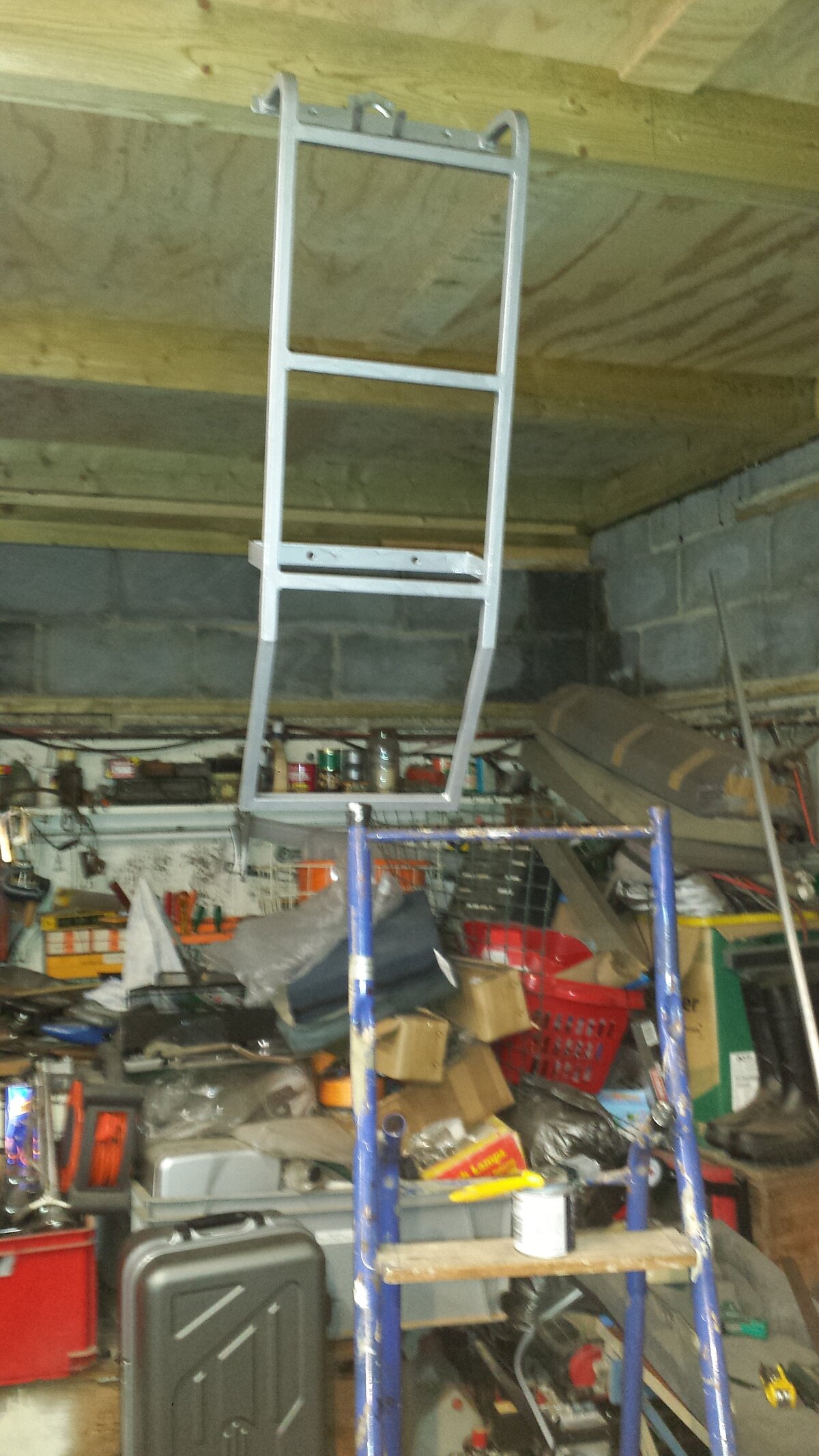

Over the last few days I’ve been modifying my rear access ladder, I decided I didn’t like it black. Took a few days because it’s too bl**dy cold in my garage to work for too long.

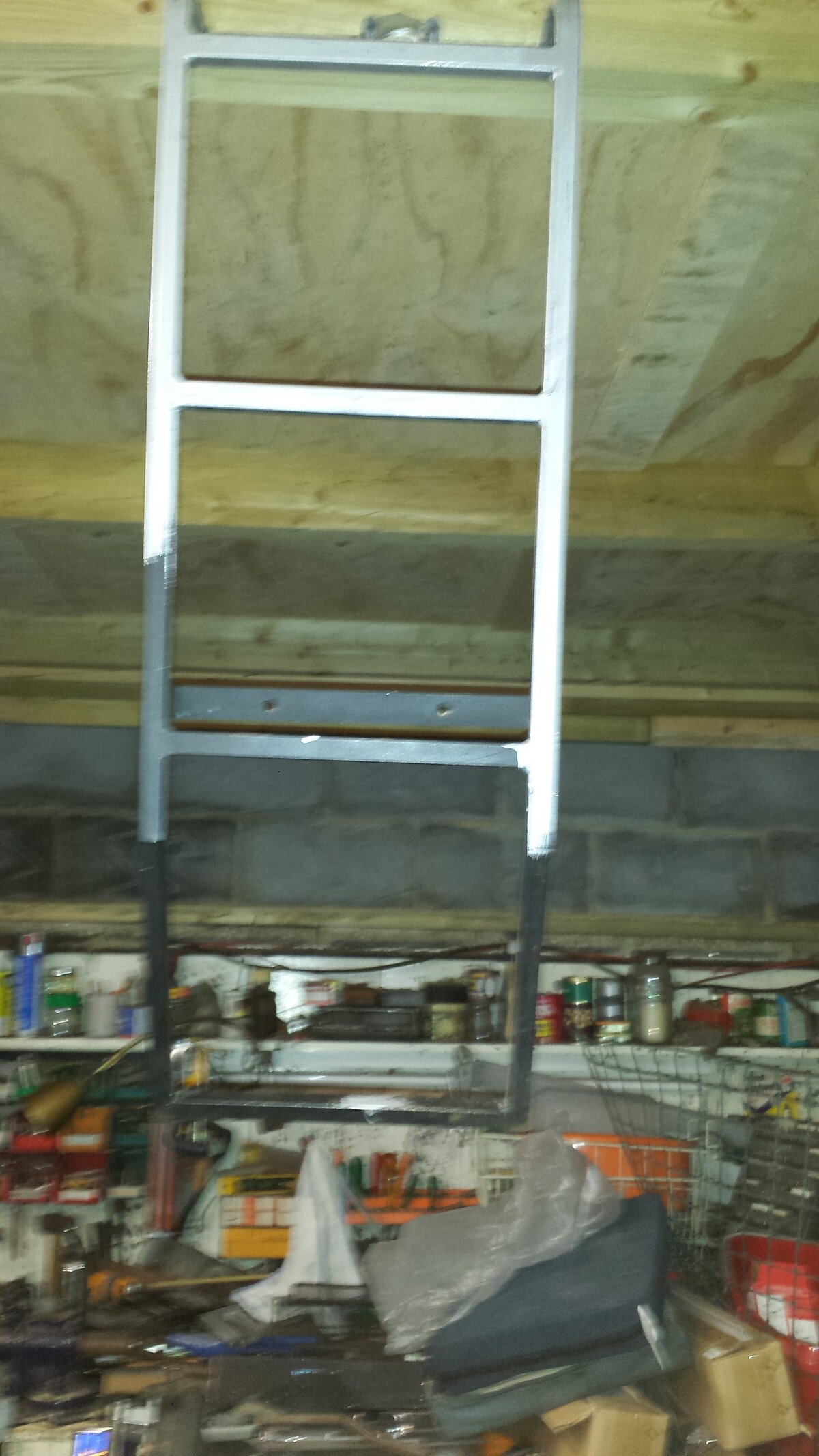

so I gave it a couple of coats of silver HammerRite. I forgot to take a picture before I started, so partly through first coat.
After second coat.

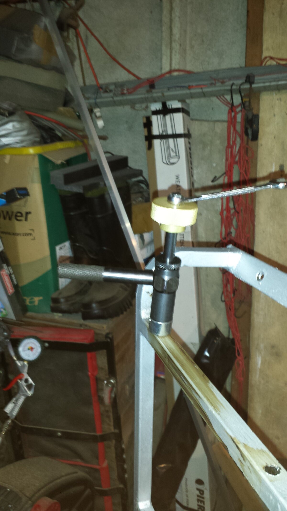

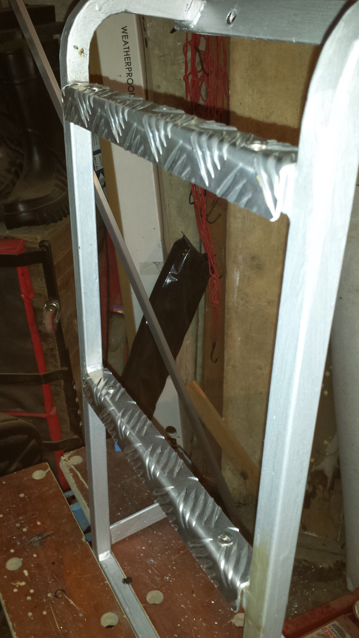

I was going to put some grip tape on the rungs but after seeing Clives ladder I bought some 25mm angled chequer plate. (Thanks Clive)
Installed with Riv Nuts and 6mm stainless countersunk bolts. The black streaks are Dinitrol I squirted in the holes.
First two rungs done, two more to go.
And the final result.

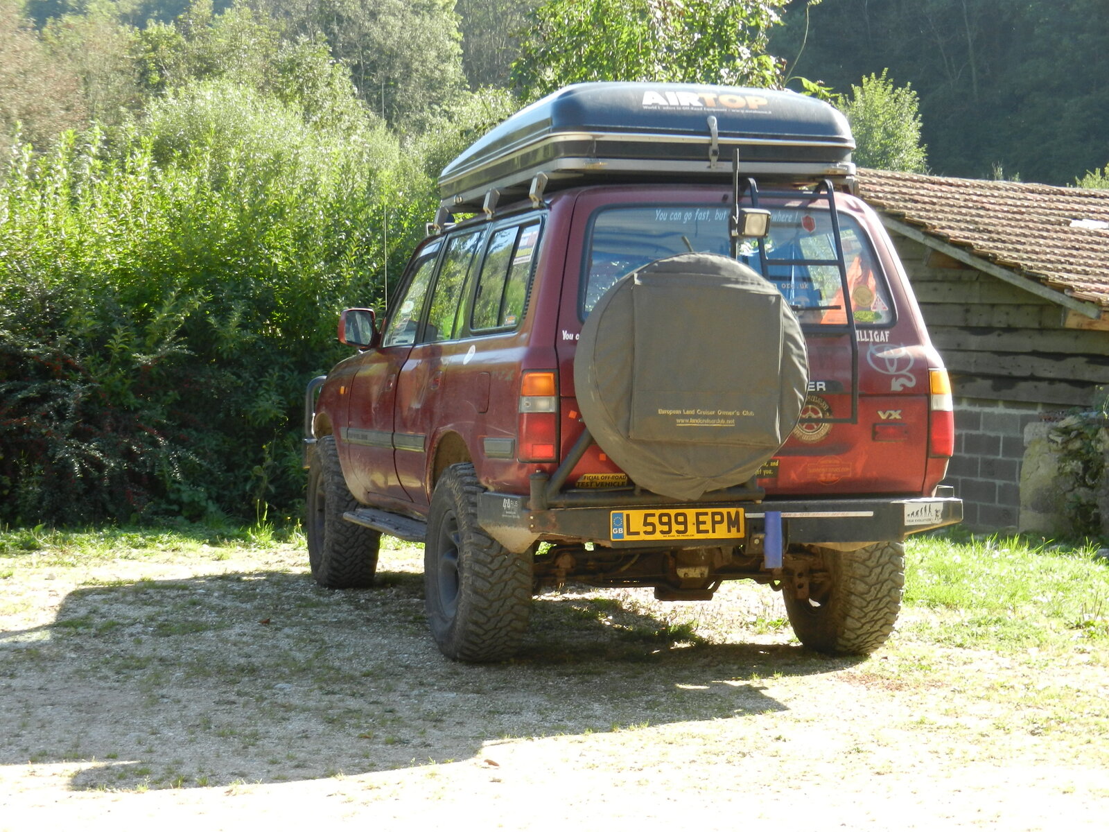

Well it does actually match the tread plate I put on the top of the rear bumper, you can see it on the last picture.
