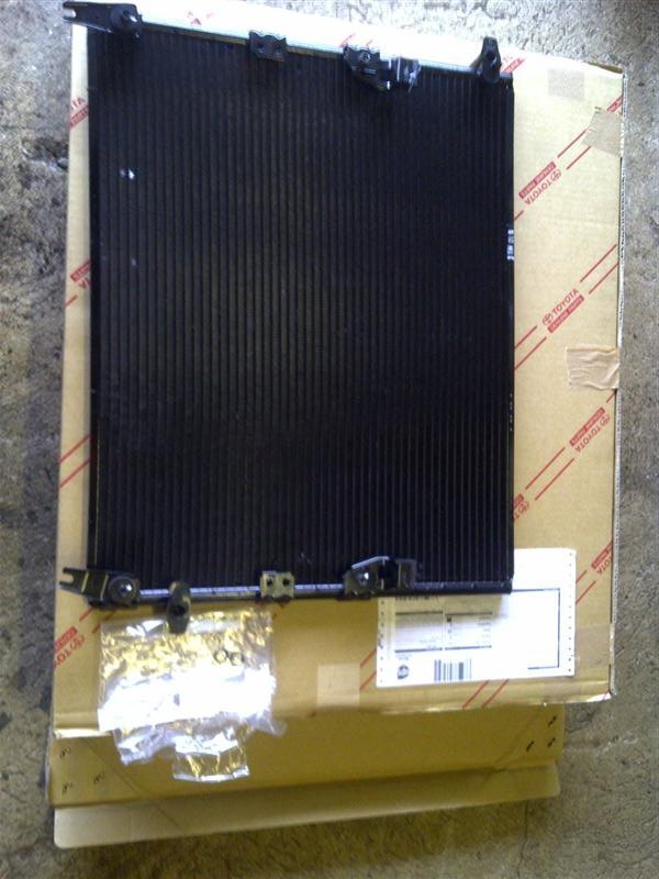

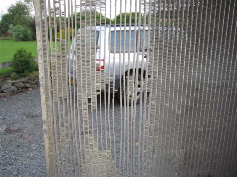

Aircon condensor is missing loads of fins in the lower part
[attachment=1:3ci79y7y]IMG-20120726-00422.jpg[/attachment:3ci79y7y]
and a quick email to Simon @ Toyota has sorted out a new part
amazingly a condensor without the brackets cost nearly twice as much as one with the brackets!
so i got one with brackets!
[attachment=0:3ci79y7y]IMG-20120726-00415.jpg[/attachment:3ci79y7y]

Re: "Summer" refurbishement work on my Colorado
How much was the condenser? I need a new one too.
The condensor+brackets sourced from Toyota via Simon Holton was £227
it was going to be £404.65 if i got only the condensor!!!
"Correct with the part Number 88461-60010
Retails at a eye watering £396.72 + Vat. Price to you £337.21 + vat (£404.65)
BUT...
If i get you part number 88460-60240 Which is the complete unit with brackets etc etc etc
Retails at £213.08 + Vat. Price to you £189.64 + vat (£227.57) "
you can get them for £80-100 on ebay and some aircon suppliers,
I also spoke with "Motorclimate" as recommended on here, they said to be carefull with ebay ones as often the connectors are screwin rather than "pad" that the toyota system uses. they quoted more than a discounted Toyota to build me a replacement.

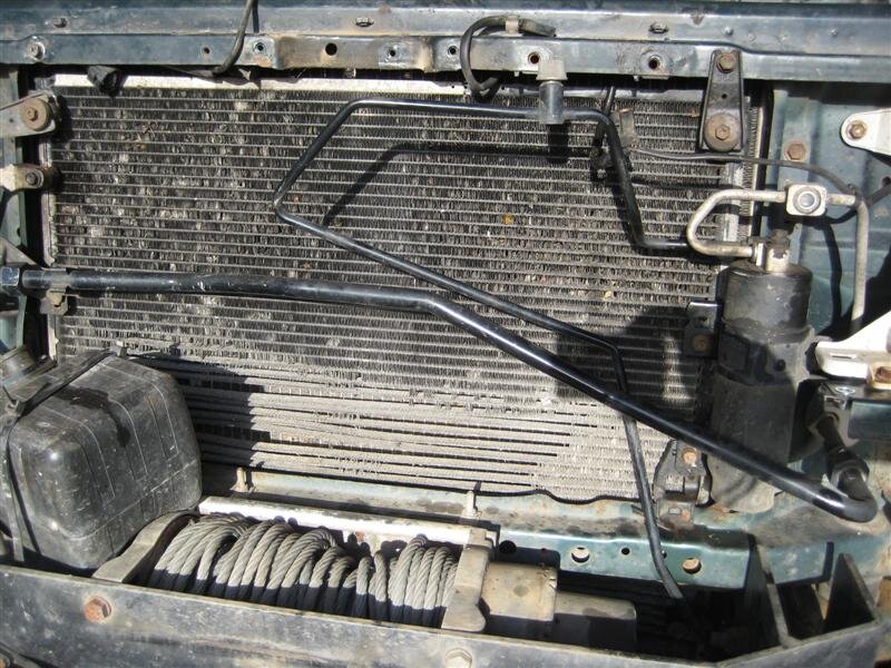

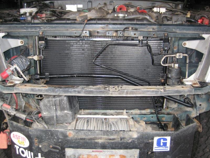

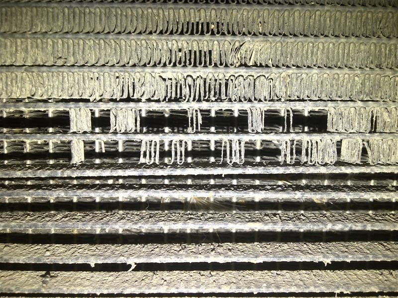

Mike Scott (Scott Refridgeration) & recommended to me by "Ecoman" last year popped round this evening and we worked on replacing my rather tired looking aircon condensor. Took an hour to drain, remove and refill - and lots of chat. i had done most of the work beforehand to remove stuff to make access easier and loosen all bolts or remove them. One bolt had sheared, so out came the drill and my new rivit nut tool :)
old one about to be drained of gas and removed
[attachment=2:1068mbxj]IMG_4236 (Medium).JPG[/attachment:1068mbxj]
not many fins!

and new one fitted

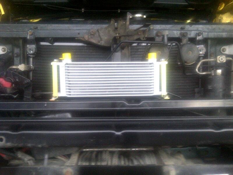

Fitted a kenlowe transmission cooler this evening - using supplied brackets and fitted 4 rivit-nuts to the front cross-brace to mount the brackets on. not going to plumb it in, until i have installed the transmission temperature sender and monitoried the trans temperature for a few journeys

AndyCook said:
Not going to plumb it in, until i have installed the transmission temperature sender and monitoried the trans temperature for a few journeys.
That should make for an interesting before & after comparison - are you going to be towing something large for the test ?
I hope we get some warm weather soon :thumbup: .
Bob.
hadnt thought of doing test towing, but i need to take the big trailer out to get some stuff soon, and the trailer weighs nearly 1ton unladen

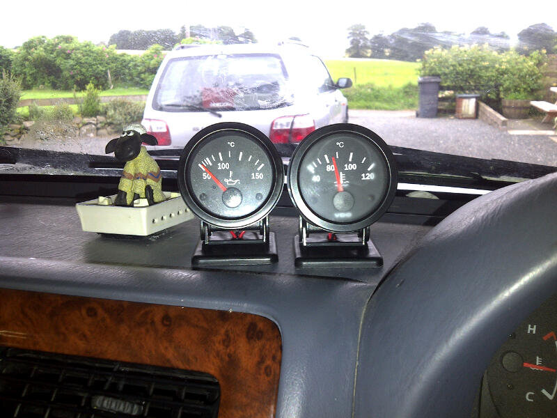

VDO gauges & senders for coolant and autobox temperature not fitted and wired
I know that i should start getting worried when the transmission temperature goes into the 100-115 degC range
what about coolant? above 100 degC?
[attachment=0:2bqzluwm]IMG-20120802-00430.jpg[/attachment:2bqzluwm]
Depends a bit on where the sensor is but I'd expect normal running around low 90's / high 80's and start paying attention when it goes over 100 but not start getting worried till maybe 120 and your OEM gauge probably won't budge till 140!

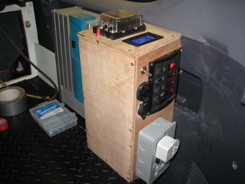

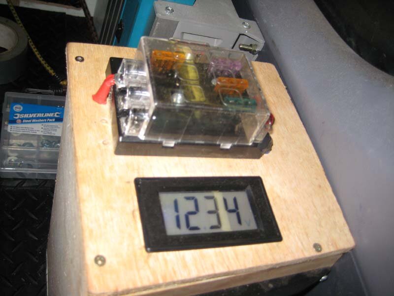

re-organised the Auxillary wiring for inverter plugs, 12v sockets and light switches in the boot today, the switch panel used to face inwards (sideways) towards boot and when fridge slide unit was in place it was difficult to access
so i have made a new cabinet and rearranged it to face towards back and added a new fuse box and 12v voltmeter
Also added another 12v socket to centre console in front, fed via fused spur wire to the auxillary battery for a permantly live option
[attachment=1:2uk73u93]IMG_4250.JPG[/attachment:2uk73u93]
[attachment=0:2uk73u93]IMG_4252.JPG[/attachment:2uk73u93]
Is that the 600W or 2kW inverter you have fitted there? Can you show some pics of how it sits relative to the wheel arch. I have to fit my 2kW model in a week or two and trying to decide where to mount it.
Its a 500w inverter. travelled to paris this afternoon for a work trip so cant post any pics of its install. but i am sure i put some on here a few years ago so will dig out the link tomo
