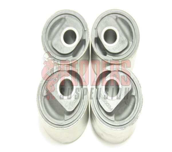

We're sorry that we couldn't help with springs for your KZJ70 but we're very happy to hear that you like the 5802 bushes.
They really do offer OEM reliability, castor adjustability and flexibility that polyurethane bushes just can't match.
For those wondering what they look like:
http://www.pedders.co.uk/pedders-castor-correction-rubber-bush-packet-of-4-5802_p4500558.htm
