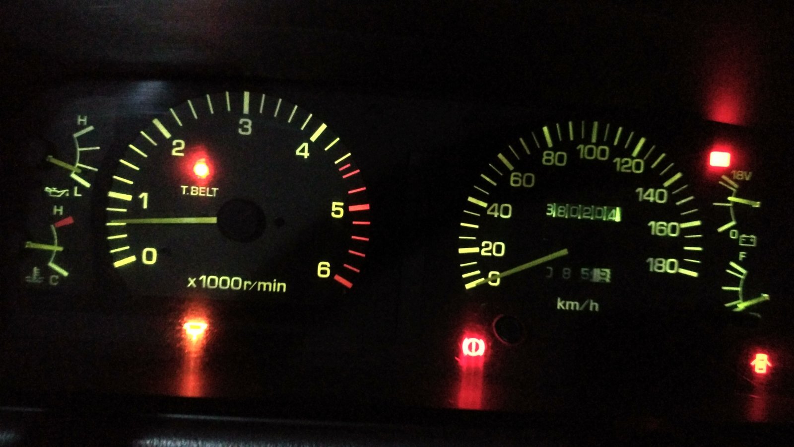

Yep, alternator brushes or plug on the back. As above, pull the plug off and inspect for corrosion. Give it a few good wiggles on and off again before refitting to clean up the contact and see if that improves matters. If no improvement, remove alternator and check brushes are not stuck or so short they don't connect properly.
